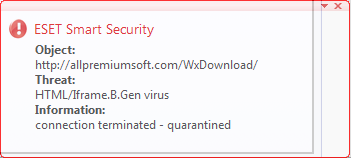

When I press the download button, I am redirected to another site, and my AV shows this message.

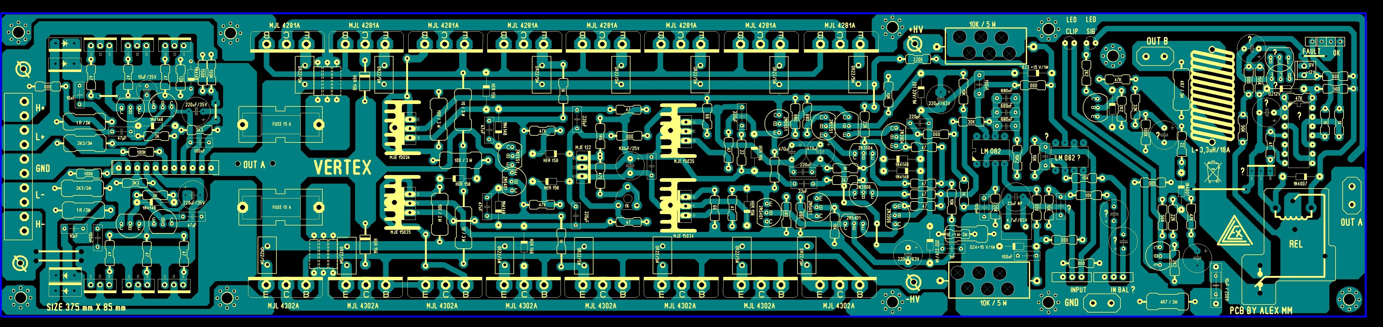

i already get more than 1500w on 60/120vdc using 2cs5200/1943
using MJL4281/4302 and 75/145 we can achieve 2500w in 4 r
with good psu and filters

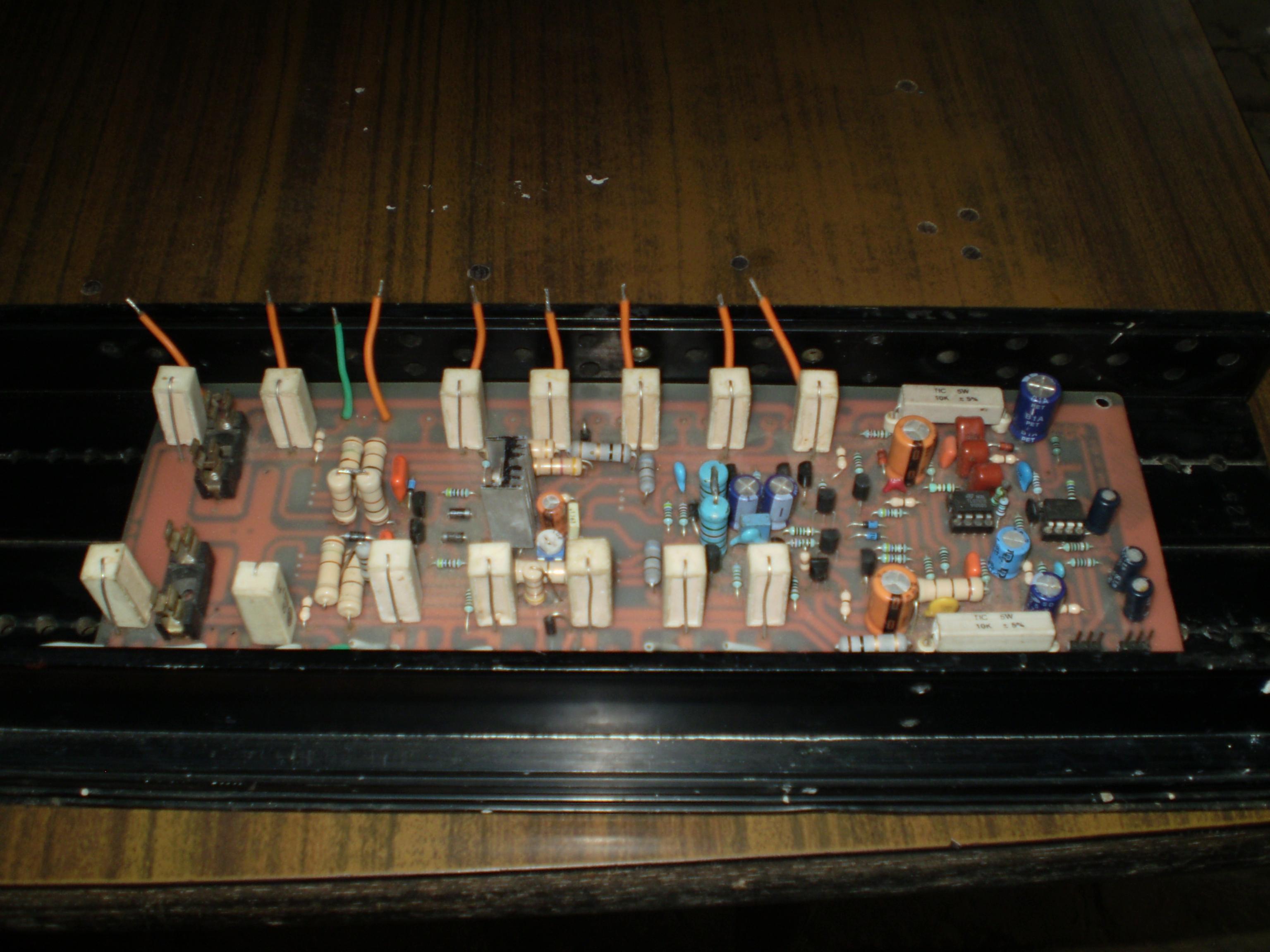

offset .3mv .,, voltage across .22 5w resistors 10mv idle
1.2vac 50hz sine wave on input and output 85vac reading ,,clip at 85vac 4r 1000w speaker load
@ Sir Mile i hope you have good limiter and protect circuit for this amp
I will post limiter schematic with LM13600.
