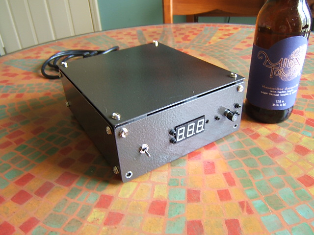

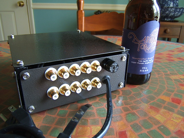

Hi Zman - welcome! You sound like you are where I was at post #58. I used 12.6-0-12.6 and 12VDC 0.3 amp wall wart inside my case. My preamp is still working great although I no longer have the MiniDSP in it and put the VC23 in a new box.
Eric
Yes I considered tapping off one leg of the other transformer, but I didn't want to risk any noise or loss of performance, maybe it would be OK, not sure. See attached.

The preamp was put together yesterday and is working fine! Thanks Eric on and others who shared details of their projects on this thread.
I have noticed one thing - if the amp (Hifimediy T4) is on before the preamp, there's a nasty pop out of the speakers when I turn the amp on. Is that normal?
Glad you got it working. Yes that pop is normal. The usual order for powering components is preamp, source, then turn the amp on last. When shutting it down, turn the amp off first, then the other components - that should fix it.
