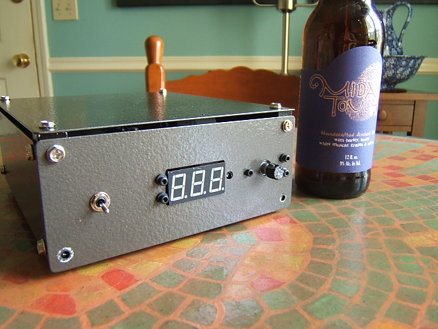

Working now!
When I set DIP 3 to ON, shut down and restarted it wouldn't come back on. Turns out my power switch was bad. Fixed that and it is all good now, programming was a breeze. Good idea on the relay, I will do that.
See attached for latest box configuration.

TV Remote Interference with VC23
Was able to program the remote to control the VC23 with channel and volume with the cable box remote, but still problems. 🙁 Whenever a button is pressed on the cable box remote when in CABLE mode, either channel up/down, List, back, play, etc it has a bad effect on the VC23 - usually raising volume, even though the "audio" function is not enabled. Here is the remote: Atlas OCAP 1056B03:
Atlas OCAP DVR Setup Television Control (1056-BC03)
Is there a fix or work-around for this? I may have to move the VC23 and amp to a different room as it can't be on at the same time the TV is on, but I really wanted to use the VC23 and amp for better TV sound..... 😡
Thanks in advance.
