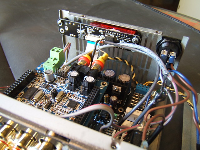

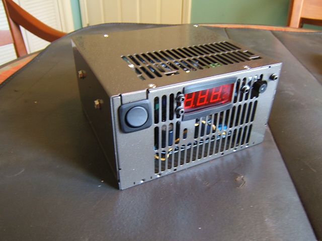

I finished my little pre-amp based on the VC23 of Hifimediy yesterday. Some time ago I built a small/simple pre-amp with rotary switches and 2 opamps, but as one channel broke, I decided I wanted remote control as well.
So I took out the old board an replaced with the VC23 board. Two pictures attached (hope pictures are not too large).
As you see, I made a mod to one of the power connectors (the other one was too tight). The PCB fits in a standard eurocard case, however due to the placement of the power terminals you can't easily slide it into one of those boxes.

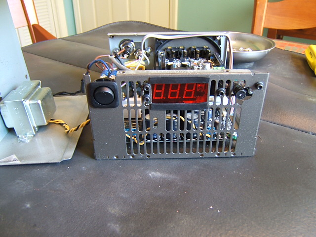

In the picture below the preamp is the power supply delivering 15-0-15 V dc(!). The two boxes on either side are gainclones/chipamps based on the LM3875
Initial listening confirms that this amp is an improvement over my previous pre amp. Not so much the sound quality, that was already very good, but ease of use is fantastic.

Looks Great!
Nice job Maarten, very well executed - looks professional. Amps look great as well.
I am trying to install my VC23 in an old PC power supply case. Will post pics when I get something together, but I am not such a craftsman. Will need an amp solution after the preamp is done.

Maarten: How is it you are able to use 15-0-15 VDC?
I powered mine up and got a horribly loud 60Hz buzz and the amplifier wasn't even turned on. I used one leg of the 12.6-0-12.6 VAC for the digital circuit.

i just happened to have the 15-0-15 Vdc power supply. i figured that 12Vac would probably result in 17vdc after rectification, so 15Vdc would probably still be Ok. On the picture you can see the wiring (red/red and green/blue) are same.
i did not ground the amp itself, but looking at my documentation of the ps the black (0vdc) wire is probably connected to safety earth somewhere inside the ps (have to check)

Here are some pics, still trying to figure out the buzz... Switched the digital input to 15 VDC and still had the buzz, then a 2nd tone started and was getting louder very quickly. Does the polarity matter on the digital input?

Hi, IBM5150, when your system use not only VC23 boards, I suggest test each board separately, that will more easy to find what's the problem.
And I also suggest use a standalone power supply for the digital part of VC23, and VC23 already has a (analog and digital)ground junction itself on board.

Have removed the MiniDSP from the setup, and taken the board out of the case. Now have 15VDC on digital channel, 12.6-0-12.6 on AC connector. I think the buzz is a grounding issue, but there is another problem - the output is very very low. I can just barely hear a signal at -15, turning it up louder it is very distorted. I only have channel 1 connected, and switching channels cuts the sound out completely. Ideas?

Hi, Eric.
make sure the input/output signal wire is good first. Also make sure the output DC level is 0mV (use 2x variable resistors on board if needed).

It's all good now, thanks to a good friend/lab tech at work. I must have had some bad solder joints. He swapped out the signal connectors on the board with a 3 pin PC fan looking connector and the mating connector, terminals and crimper, then used new shielded signal wire to the RCA's. No more buzz, nice clear signal, remote and everything works. Enjoying it!!! Thanks for your prompt replies and the nice product.

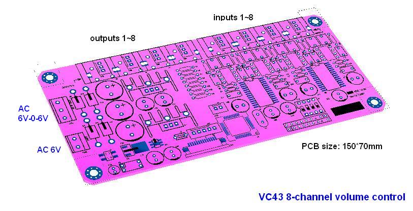

I am very interested in the VC43 board mentioned a few pages ago..
I have a miniDSP 2x8 and want to control the volume after the output of the board so that there is no digital attenuation of the signal. I also want to be able to switch inputs and volume from a remote.
Can you give us more details of the specification of the new board? Perhaps some input on what would be desirable?
In the long term, I would like to have two of these. One to control the 8 outputs of my miniDSP (front channels) and one to control the output of the surround channels from either a media PC or blu-ray player with analogue outputs. In this scenario can you see a way of controlling the volume of each channel on two boards? ie, controlling 16 channels volume up and down at once from a single remote?

hi, Jai
VC43 is ready here, but I think it's need some time to go ON Stock.
VC43 control up to 8 channel volume, it also can control volume of 1+5, 2+6, 3+7, 4+8 channel separately. And other functions are almost same as VC23.
The board can accept almost all analog source, it have good OP buffers before the PGA4311 chips.
