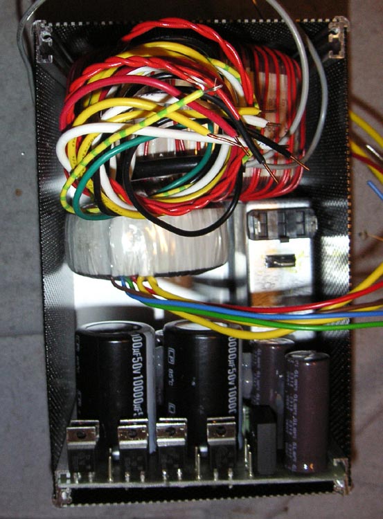

The best: I post a foto from a prototype. The correct orientation of the MUR diodes on your board is the same.
BTW: This foto is just showing a layout study of the psu, including two trannies at this time.

Franz, if you mean that the direction of the Mur's on your last photo (in post 45) is good, i diagree. I.m.o. the direction must be 180 dergrees turned.

Of course, you are right, Wim: just look at the 10000uF caps: the negative side is at the right side on this example (remeber, this was a early prototype, not the board from Zang).
Sorry for all this confusion!

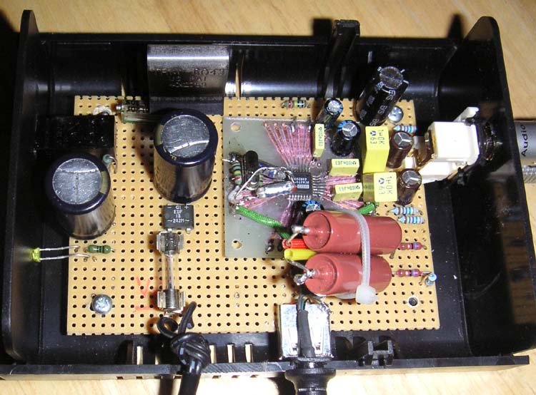

The picture is showing my first USB Dac.
BTW: in the last weeks, the vinyl virus got back to me. But sometimes I really prefer the musicserver and a playlist with direct access to all titles.
Franz
