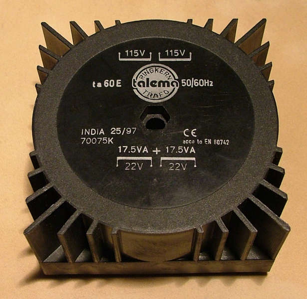

You need only one winding of ~45 VAC. So you can use a tranny ranging 18-0-18 to 22-0-22.
Now that you mention it. Just had a quick look at the schematic and it's indeed only "1" secondary winding.
What's even worse, I have two 22V-0-22V / 35VA trannies in my goodies cupboard. I really feel stupid now
Thanks for the hint Hanzwillem
Regards
Why stupid? Just use two secondaries in series, resulting in 44 VAC, what is perfect for the anode voltage!

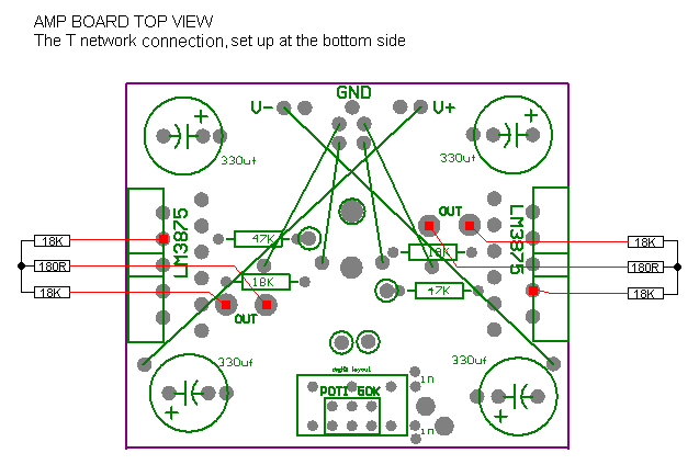

Hanzwillem said:There seems to be an error in the silkscreen of the PSU board.
I suspect D1,D2,D3 to be printed the wrong way. I don't see this work as a proper bridge as it is drawn at the moment...
Yes,there are silk layer missed of bridge and delay parts,I am so sorry for all troubles.I will release a 'PATH' for the psu board soon.please keep it for a while.
to wim,sorry for delay.because I couldn't surf net during weekend.
P.S.
the attached photo is the connection of 'T' network.

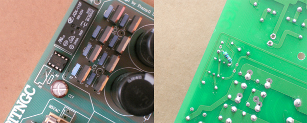

Franz, what is the resistor on the photo in post 31, on the backside of the PCB? Is that resistor named in the BOM or is it a fix, or additional?
And do you mean in also post 31 that the IC must by placed 180 degrees rotated than the PCB says?
Thanks again, and sorry for all my questions.
Wim
Yes, the silk print is showing the NE555 in the wrong orientation.
About the resistor under the board: wait the answer from Zang. It seems, as he did not insert the trimmer pot and the resistor in series and replaced them by a fixed value under the board.
I am sorry about the errors on the silk print! I checked many times the solder side, but not enough the parts side. And I did not use a PSU board from Zang up to now.
Franz
Franz

Sorry, but here i am again.
Franz, looking at your recently posted picture of the Murs on the PSU board: In the first place you changed de Murs and the C's (but thats no problem), but what is a problem I.M.O, you mounted all the Murs wrong. (cathode = anode and anode is cathode).
Please correct me if i am wrong, but i am pretty sure of it.
Best way to see it is to follow the schematic off the PSU and look good to the mountingway on your board.
If you lay down a Mur on your desk with the black plastic side in front of you, the left connectionwire is the cathode.
Hope to hear from you about it.
Till later,
Wim
