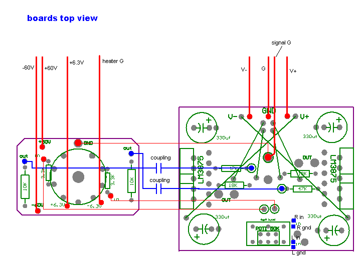

Wim, normally there has to be a resistor from grid to ground.
If you leave the input open there is no "leaking resistor " for the grid.
You can connect a resistor (1Meg) parr. to the inputconnector.
Maybe this will help.
good luck, Loek

Of course, there must be a resistor from grid to ground! The circuit is intended for a pot at the input (47k) wich fullfills this function.

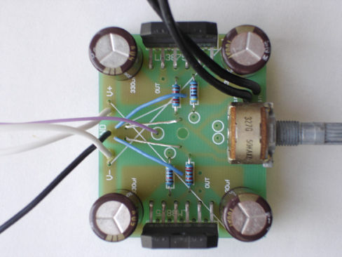

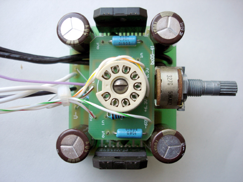

For those who are interested: i have some original "GEWA" VBITNGC boards for sale. I have too many other projects, and the summer is comming up, so little time for making amps.
I build 1 VBITNGC myself, and it works fine.
I also can sell the boards with the tubes (E88CC), relais and LM3875TF.
It speaks for itself that i sell the boards non profit (original price).
Hey guys these are very easy to build very nice sounding valve buffered integrated gainclones... (you don't need a preamp).
It was one of my first projects and it came out just fine... took a long time for me building stuff, to beat its level of performance...
