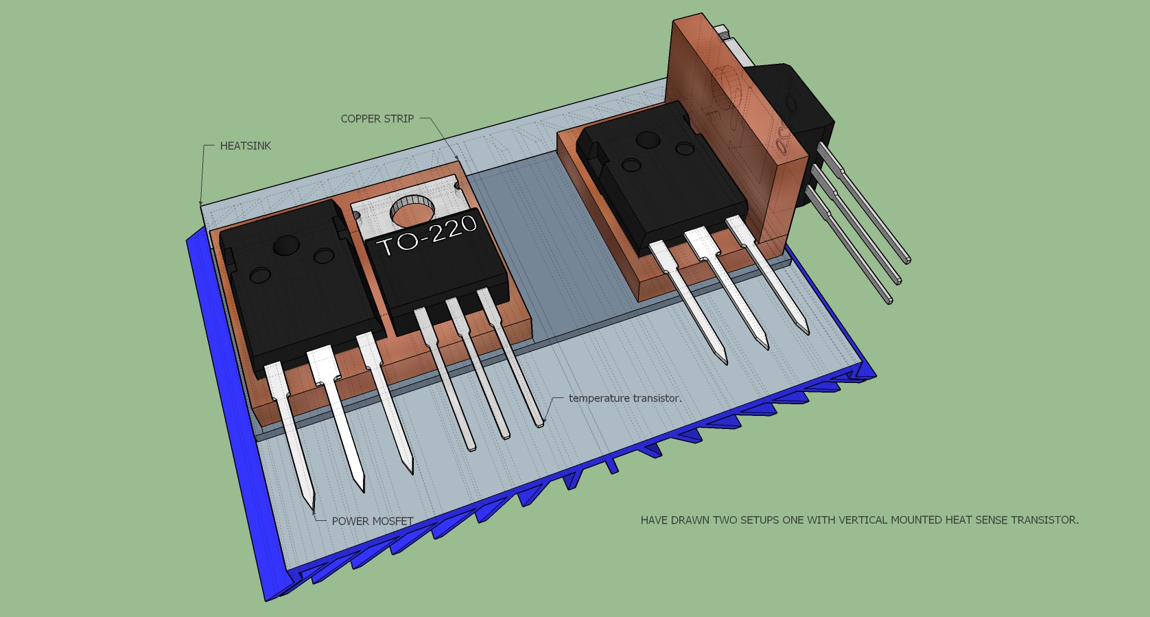

This fact is something I have already commented altough nobody seemed to trust me. I also did the same experiment in the past and got the same frustrating results as you
The worst place to mount a Vbe multiplier is over the plastic case of a power device. This plastic resin usually has very high thermal resistance and just does not follow the die temperature at all, actually it's allways sustantially cooler than the heatsink and much cooler than the die itself. The temperature of the plastic surface is mostly dependent on ambient temperature only
This idea maybe?, yes tread is old but the problem is'nt. Using a copper bar, above the insolation layer copper do have very good thermal properties and transport heat very fast.
I have now us the plastic case for mounting the sense transistor and as eva says, it do not work wel except for small demands, low power amps, I get a drift also, it stays first for a 30 minutes stable and then go drift, first up then down, if i have 500 mA setup, it go drift after 30 minutes to 600 mA then to 350 mA back to 500 stays there and repeat.
I need als the inverting buffer to gert nuch less heat sensitive, the inverting I do need because I have regulation the positive way.
regards

If you go to Bonsai's Hifisonix website, you'll see just how good his results were with a tiny SMD transistor right close to the collector lead where there is very little thermal lag that occurs through the heatsink and insulation material. Speed is of the essence here, even if there is a net temperature differential between die and sensor.

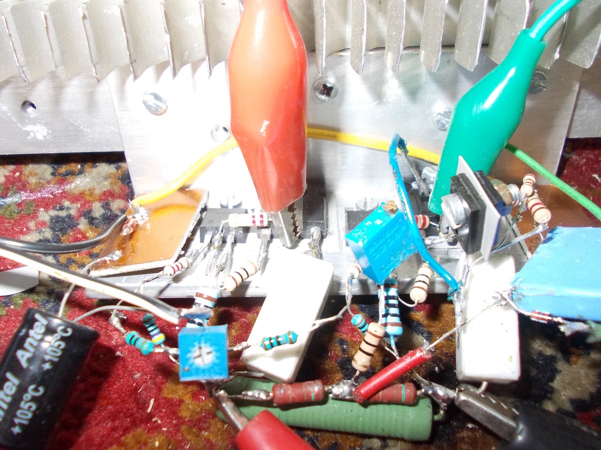

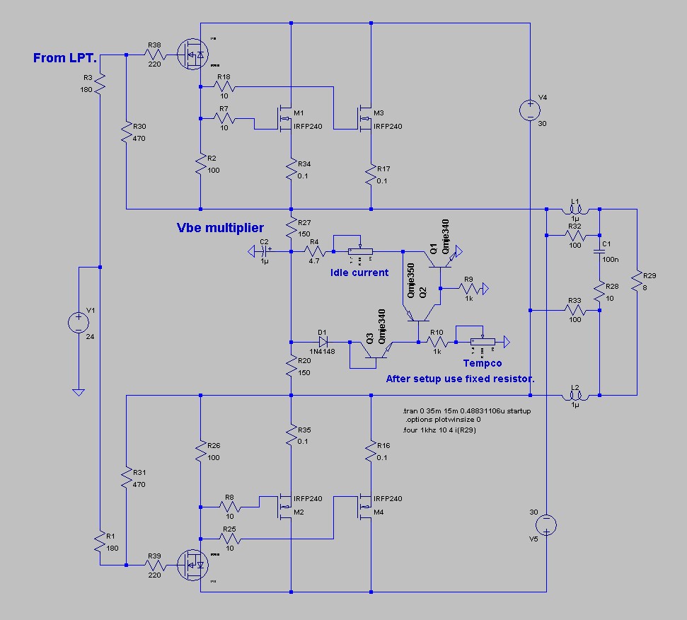

You are quite right, special with a very low on resistance mosfet I need speed.
I have now testing the CFP setup with a sense transistor, I get now a stable readout, but it starts on low idle like 400 mA and go up to there but when on 500 ma it stays there within plus minus 50 ma, do I cool the whole thing down it go up to 600 mA who is because I do use air and cool also resistors, CFP etc...
I did read a time ago samething about that, I did that time a experiment with temp resistors, but also what I did drawn, with copper bars between the power mosfet and the insolater, then we get very fast respons also.
I have mosfets, people say that I have to use mosfet sensor also, then I need a mosfet with also very low on resistance also.
Dp remember, mine multilier has a idle current of 40 mA itselfs, warm up the CFP and as such it does add some extra disturbance, I have connect the two transistors thermally of the CFP not it keeps quite stable.

After a cold start of amp, it is 400 mA rise quickly to 800 mA and drops again to 400 mA and slowly stabilizing on 510 mA and stays there within plus and minus 50 mA.
Do someone know how to use a fet as a temperature sensor, gate to drain ? or a separate gate voltage. see schematic above.
The idea with a smd transistor is nice however I have a mosfet output stage, it is some different in thermal behavior, and I have a different regulation deeded, like in a normal vbe multiplier the impedance gets lower and as such less idle current, in mine case I need to have a higher impedance to get the current lower because it is a circlotron where I use the multiplier from ground ref resistors to ground, having there 8 volts, and a current through the multiplier of 45 mA what is higher as a normal multiplier.

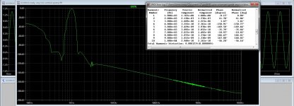

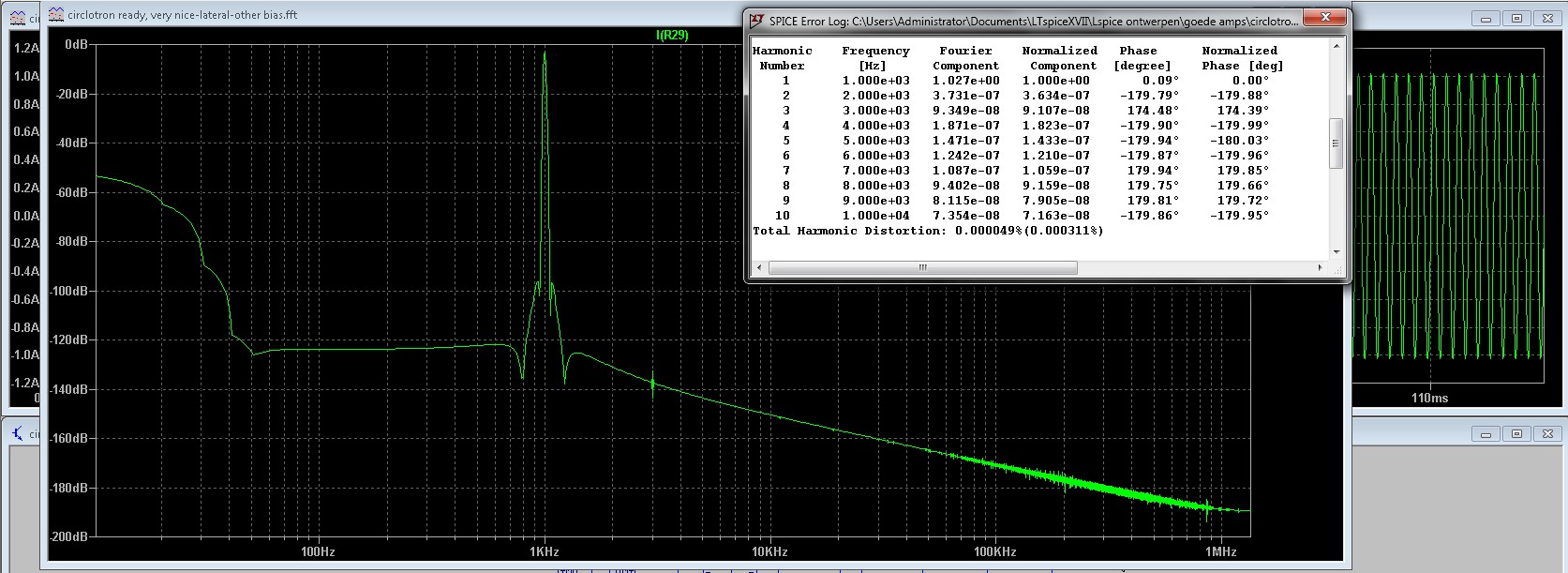

Thanks for the respons, I be aware of the way others did but for me I have some quite different commands, first, a multipier between two basis of transistor is used a lot, these do get lower impedance when get warm and as such lowering the idle current, and the idle current through the multipier is just 4 or 8 mA.
However for me I need a rising impedance when get warm, and I have 45 mA idle through the multiplier buffer transitors and have some dissipation what does have influence on stability, that is why I did connect thermally the CFP stage.
As I now see it is a to high thermal resistance between the sensing transistor and the mosfets also, using the plastic housing doe work but not when it is a high power amp, but I get with this multipier 0.000421 procent distortion on 5 amp output and a distortion on 1 amp output as in pictures on simulation.. this is with laterals however, but vertical do also nice, see pic 2 with the used multiplier..
Maybe the use of a ntc for the mosfet idle protection? these do fine when used properly.

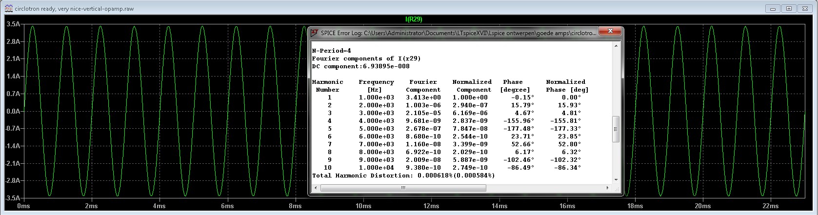

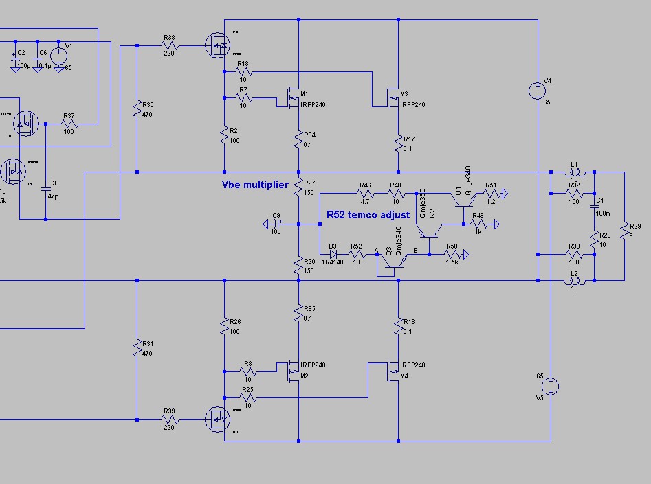

I have now a setup who do start on 600 mA (I did have 500mA as a goal) drops very fast to 420 mA and rise again to 520 mA and stays there, after a while it drops to 490 mA and a heatsink temperature of 75 degrees, quite hot, no very hot, it drops to 390 mA if I let it, then ur rise again to 490 mA and pendles there, with a good heatsink (I have one who needs to get hot for test) then it is quite stable.
Only what I do sometimes see are drops, it drops then 40 mA in a second, and then rise slowly, maybe here is some instable action.
regards
Looks like it is a succes.
after switch on, around 600 mA after 5 a 10 seconds it stabilize, then it keeps Idle current between 500 and 550mA with a temperature of the heatsink between 25 (ambient) until 85 degrees, then drops to +- 450 mA if 90 degrees approaching.
I have used a smd BC817 glued on the Drain lead. It respons very well, starting cold on 600 mA and drops in 5 seconds to 500 and pendels there.
What I do see is sometimes little drops like 20 mA in fractie of seconds and back, maybe some unstability but maybe it is normal because it is just 20 mA.
regards

The one place where you don't really want excess resistance is in the emitter circuit of a common emitter output stage. The other factor that is effective is the heat sink. If it's too small, you will have bias stability troubles.
Hi kees52,
I can see the smt glued to the collector lead as a very effective sense point. The thermal track mounted the sensing diode on the collector heat spreader internally. Sticking an smt to the collector lead is about as close as you're going to get outside the package.
Of course, that makes service a PITA! On the replacement part you'll have to glue another smt, without markings to know what it was. Hopefully it is used as a forward biased diode so that any one will do. Then, connecting the leads could be tense. Use kynar wire or single strands from wire? Either one is a total joy to work with. I can see the possibility of someone ripping the output out without seeing the smt, then you have the classic amp that no one can repair. Not unless you leave a note in the chassis.
