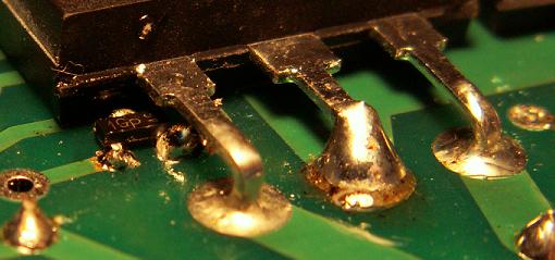

I have been looking at the Vbe multiplier problem and came up with a solution that is in some ways the exact opposite of what D Self proposes. In his solution, he seems to encourage the use of high thermal mass coupling between the output devices and the Vbe multiplier (look at the response times and the amount of metalwork between the sensor and the output device(s)). I worked in analog instrumentation design for a long time, and one of the problemns I had to solve was thermocouple cold jnction compemsation. Using a similar approach on audio amps led me to use a small SMD transistor (BC870) placed in close proximity to one of the the output device collector pins. The thermal coupling between the devices is improved further by filling the immeadiate area around and between the output device collector lead and the sense transistor with heatsink compound. The distance between the two is about 3-4 mm.
Unfortunately, I could only attach the Vbe muliplier to one of the output devices, but nevertheless the technique works well - fast response (seconds) and on the 3 prototypes I built, and very good tracking, so Iq remained stable.
Hope this helps
rgds
Hope this helps
rgds
By the way, I am using TO247 devices which are located on the underside of the PCB, along with the SMD Vbe sensor - all the other amp components are on the top side of the PCB - so thisis not a technique that is readily usable in desings where the output devices are mounted off board.

Here is a picture of my solution before the heatsink compount has been put on. The output transistor is an MJL21193. The heatsink is 0.3c/Watt
rgds
