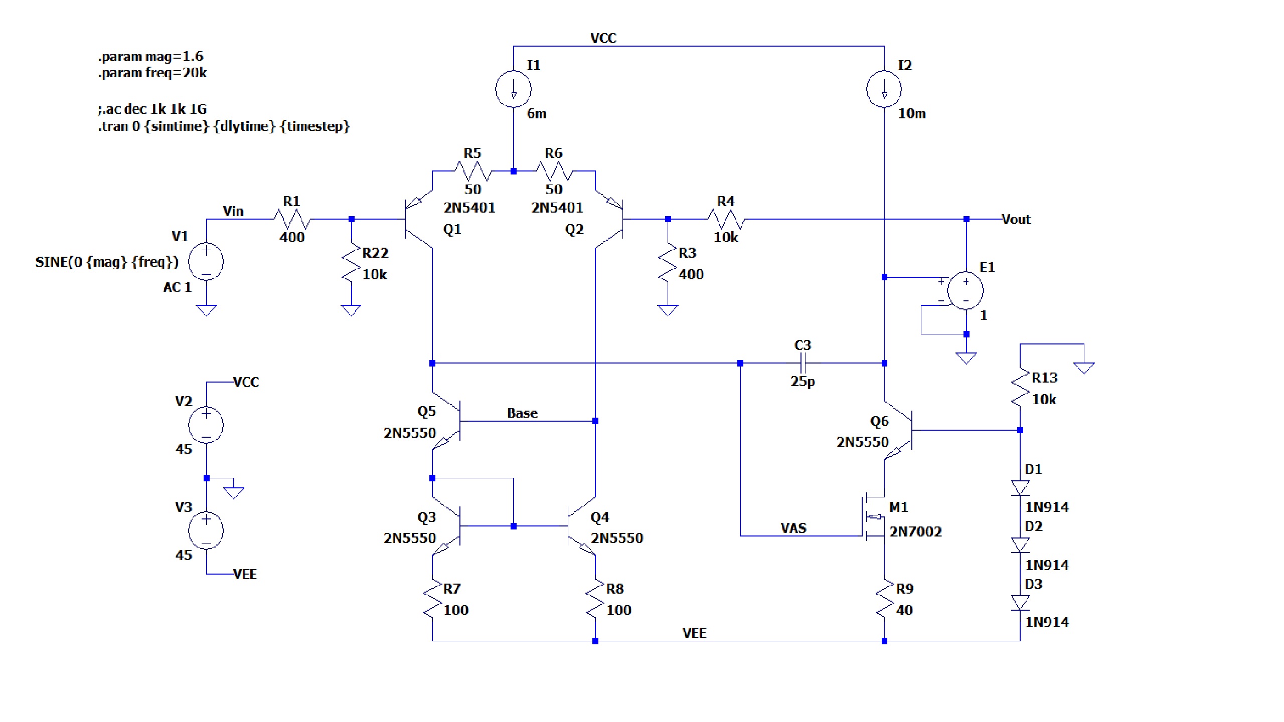

An approach I like is this MOSFET Vas. No base current and the maximum Vas current is set by R9. The MOSFET acts as a variable resistor in the Q6 current source.

If I understand correctly, the diode you are talking about is parallel to miller cap. It does affect THD, because a diode also has capacitance, and its value depends on the its voltage. It will increase distortion of VAS.
Apparently the diode capacitance is non linear too. I have tried this, and it did make a difference but the increase in distorion has me against that method.
For now I am going with the resistor in series with the collector of the first transistor. This then also gives me a good takeoff point for my clipping indicator circuit. I currently have no way to detect distortion, but have just bought an Asus Xonar STX card, and with some software will hopefully be able to do some testing....
