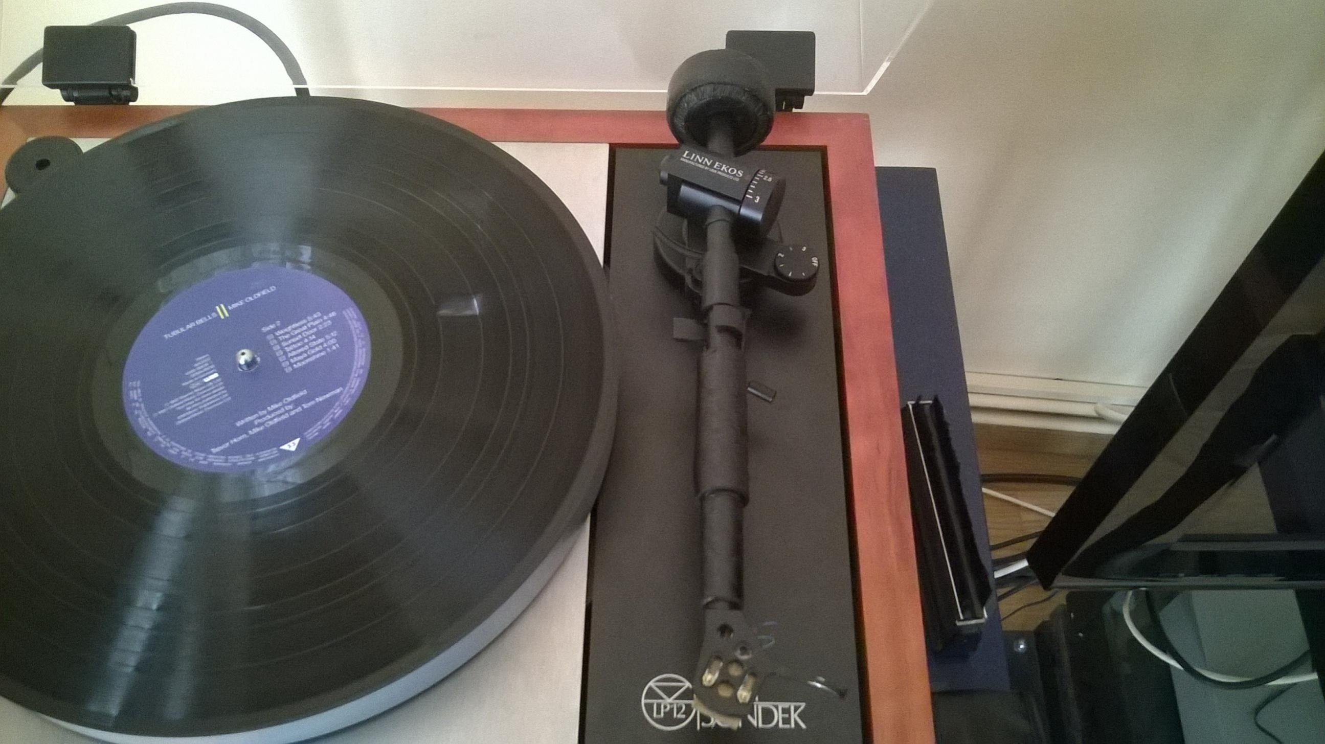

I measured the capacitance of the phono cable between the Itch & the #26 and measures 500pF (3 meters long), have I to increase the C of the Zobel step-up Jensen to 200pF?
Attached pic just for fun of increased mass of Linn Ekos tonearm, now Itch + Denon DL103R plays in other league.

The SUT secondary termination (Zobel) is a different matter regarding the output of the full circuit. That Jensen could be fairly well compensated for square waves with 100-150pF in the Zobel too, at least on the oscilloscope tests I have shown before on my samples. You could try those values too for subjective impact.
The Itch output comes from a low impedance point (from the cathode follower part of the Mu circuit) and it can drive some cable capacitance. Its a 6mA 800 Ohm source with the 6SN7 in the V1.2.

No, don't put any active test instrument on cables with the cart connected.
I had used it on SL1200MK2 arm and on silicon stuffed and counterweight reinforced mission arm both about 12g. Resonance was good since its a 13cu cart by US/European static compliance standards. But heavier effective mass arms control its lively cantilever and body resonances better. Sounds more 3D on those.
Fidelity Research FR-64s, ATP12T, Jelco SA-750D,E,LB, SAEC 407, Grace 714, SME3012, 3009 good for vintage carts. Or well distributed added mass on lighter arm as you did.
I take note of all the arms, thanks.
Just received Linn Spain info about capacitance of Ekos cable is 220pF, now is sounding very good with C zobel for Jensen with only 100pF, do you increase or decrease the C value?
I would not use lower than 100pF or more than 200pF in that Zobel for Jensen SUT termination. If good on 100pF in your case, why make it slower with more compensation? Better at lowest acceptable without treble ringing IMHO. More open.
Mids and lows are terrific good (never heard some so good and I listened a lot of TT), treble can be the roll off due to high cable capacitance between the Itch & the #26 so next adjust the Itch output resistors.
