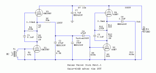

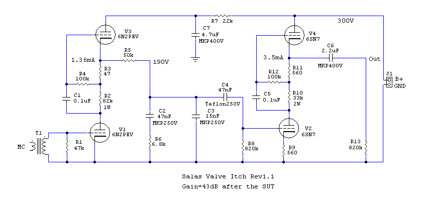

If your circuit draws 1 mA on the input tubes and 6 mA on the output tubes that is 7 mA per channel. For two channel that is 14 mA. Add 20 for the SSHV and you get 34. Add some safety to 38 maybe? How much does your circuit/tubes draw in your config?
Put a 100R resistor between the Itch and the circuit temporarily and measure over that. Use ohms law, I=U/R
Oh thanks, I forgot I did the same to know the current draws in my #26 preamp, the Itch draws 10mA

So by your build with your cable lengths and naked 103R as cart you recommend 6K8+168pF Zobel across the Jensen 44 secondary and 47K between input tube's grid and ground. Is that correct?
OK. And one last thing for the resume, Jensen's black/white, white, black, shield cables go on input's ground side now? No hum, as no hum before?
