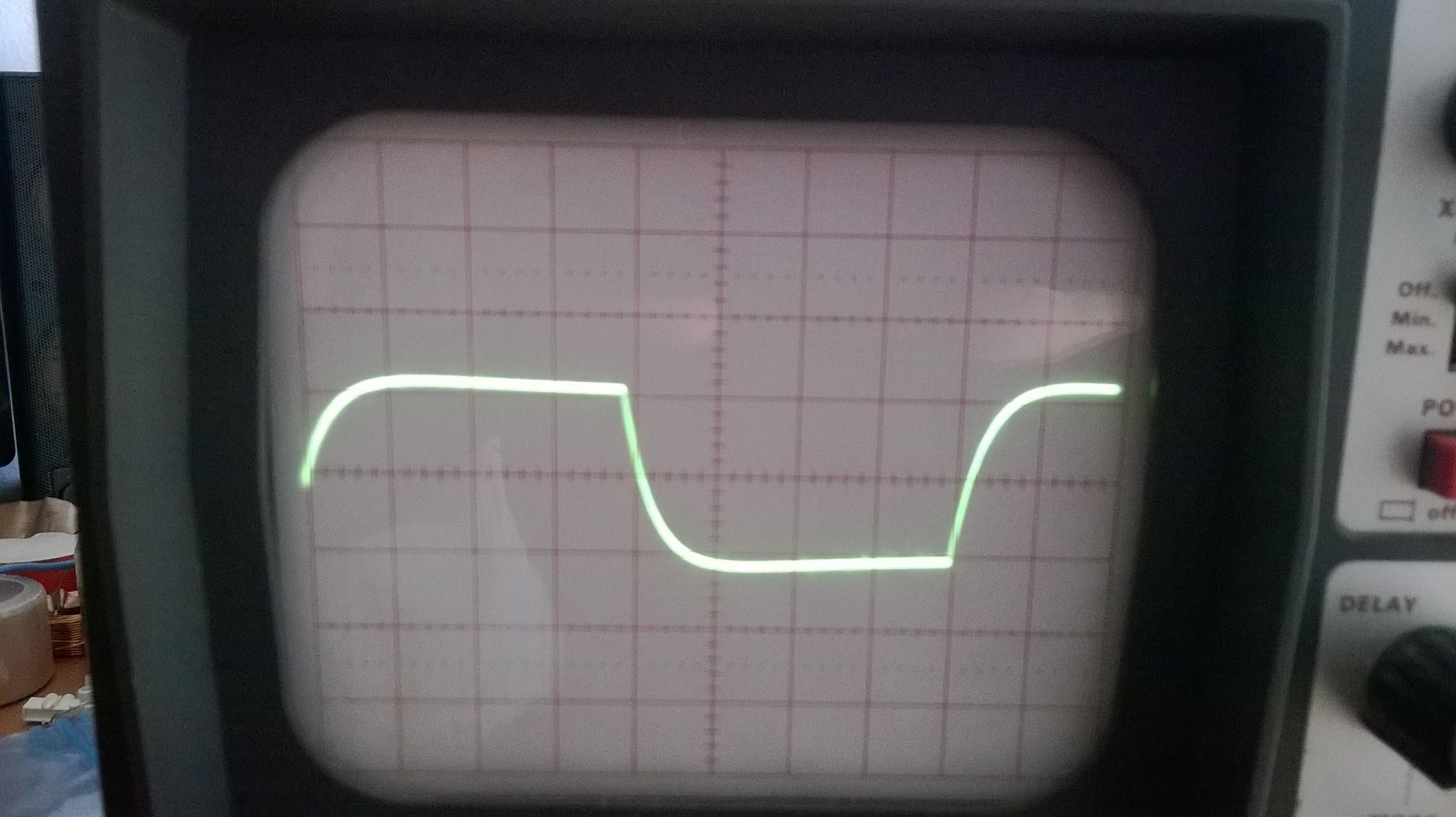

Use 5-10mV RMS input to Jensen and make the scale on the screen taller and narrower so to watch the edges better on its secondary.10KHz square shots with scope set 20mV 20uS probe x1.
10mV RMS after SUT with RC network 6K8 + 100pF

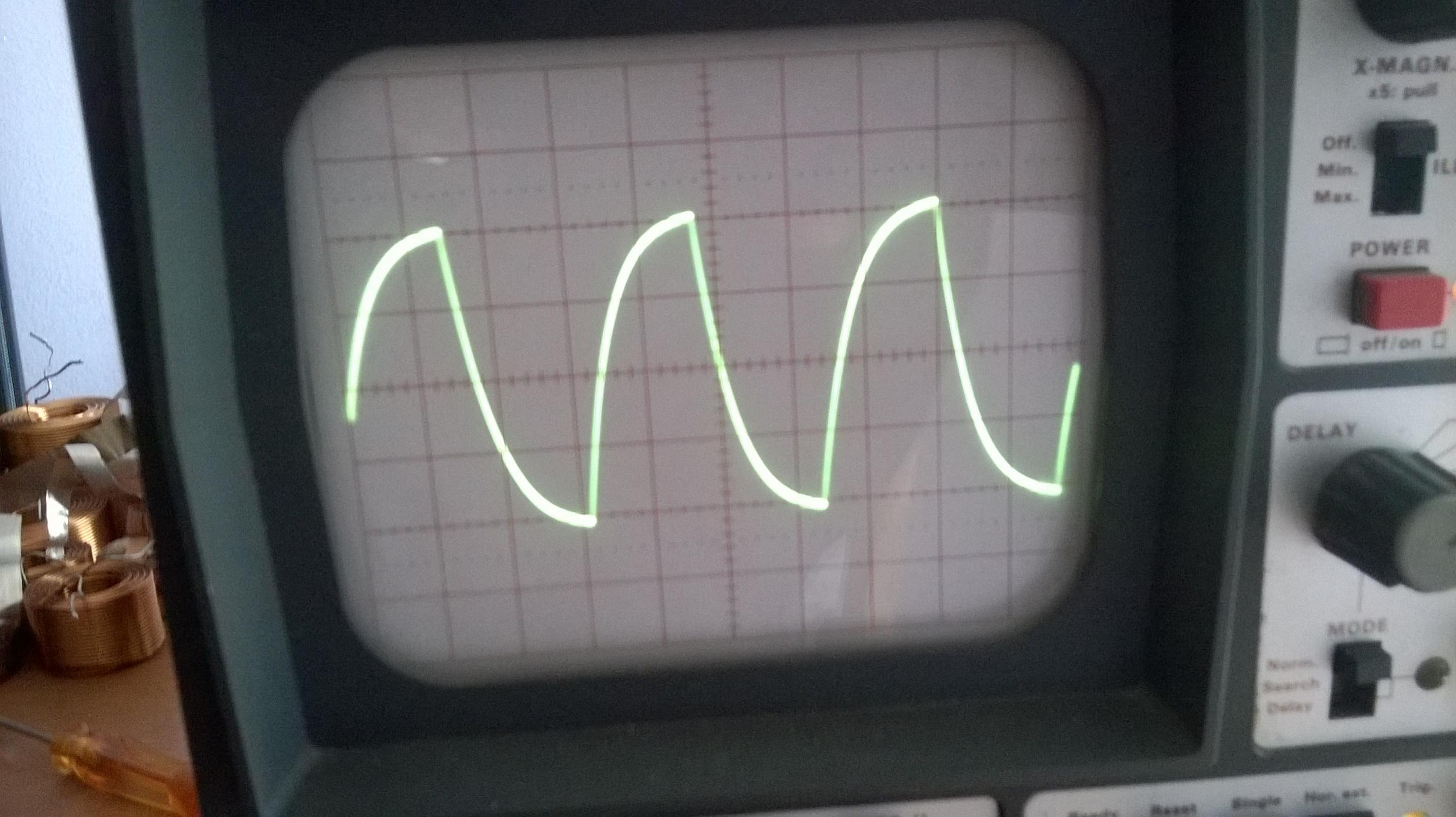

measurement not valid

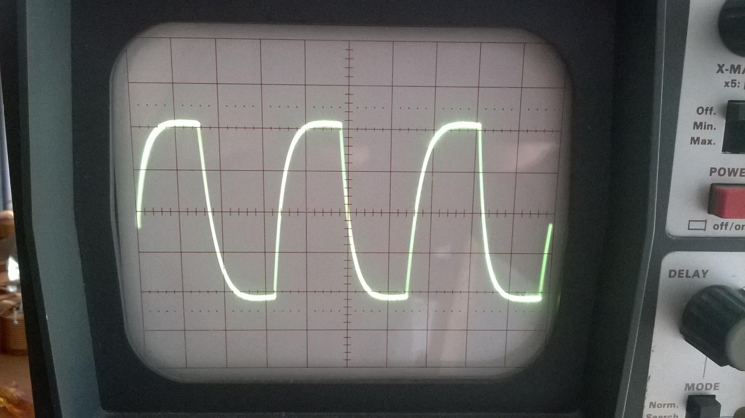

Measurement without RC
Something's slow in the measurement loop for 10kHz squares to pass properly. Anyway it still changes with the RC on the second screen, the proper square measurements I have posted already for exact same transformer (#1836) so just apply the Zobel and if you want somewhat different C value you can do it empirically.
