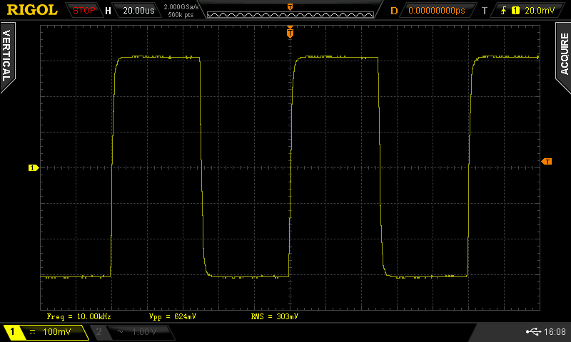

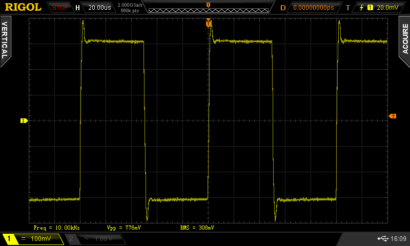

BTW the Jensen JT44 at 10KHZ square before and after Zobel termination on its secondary.

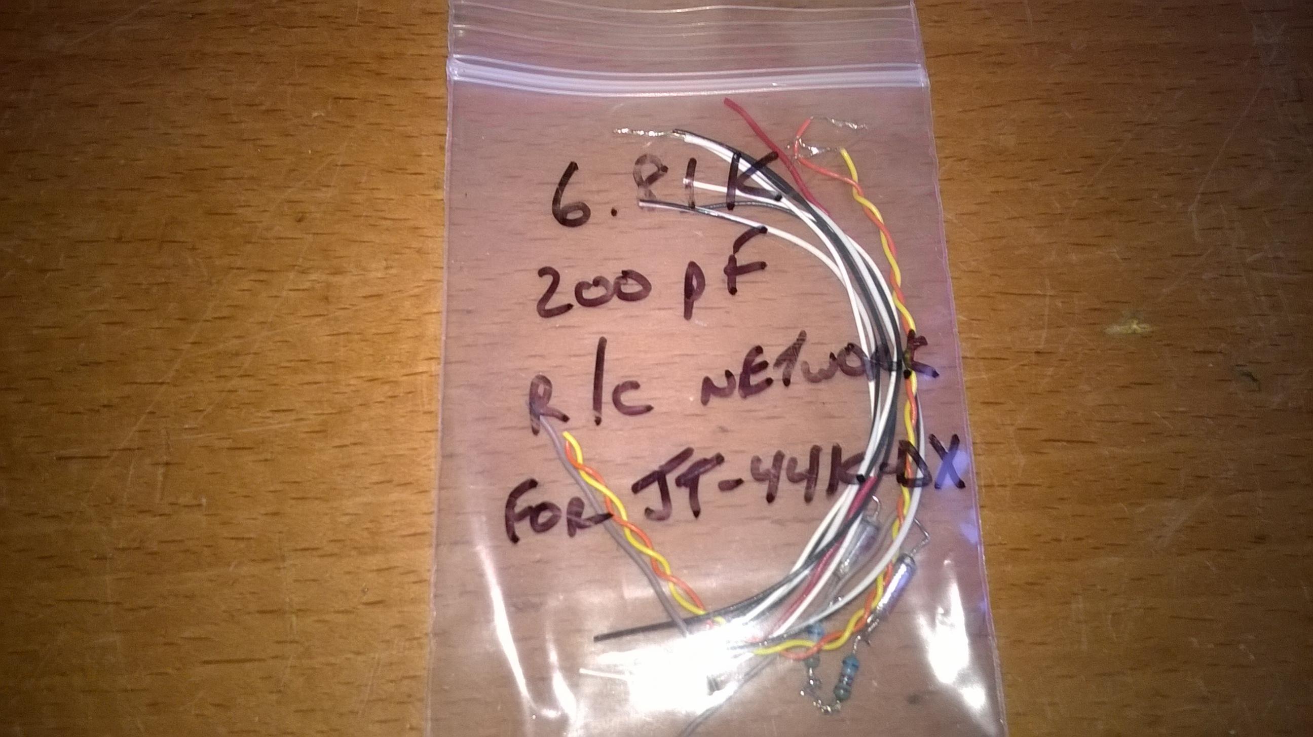

Jensen input impedance typical 430 ohms, do you use 6K81 + 200pF accross the secondary?

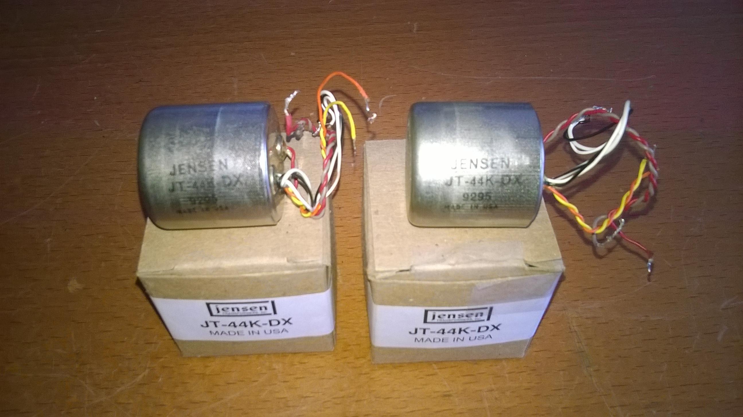

BTW I have a quote from Jensen JT-44K-DX 1:10 Step-up Transformers $233.47 USD including shipping but first I nedd to sell my Partridge.
That price is for a pair or each?
6K8 + 200pF dulled the leading edge too much for me. I ended at 100pF polystyrene for the picture I posted. But this is a test with longer cables so its possible to be optimized at 130-150pF in a build. And there is ear check in the end for each one's cart and phono.
Finally I bought the Jensen, meanwhile I'm waiting to arrives, with values for RC filter 6K8 + 100pF or I use the gen + scope with 10K square wave to adjust?
Great, I hope it was on a good price. Me I used scope and gen at 10kHz and 20kHz. But 6K8+100pF I found is a good start.
They look like new apart from the soldered before cable ends, they are going to sound nice for stepping up the naked 103R you got.
I guess you use sinus waves?
What are you looking for, the same curve only difference gain?
With 200pf the curve seems equal with 10 & 20KHz, is ok?
