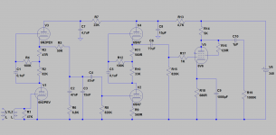

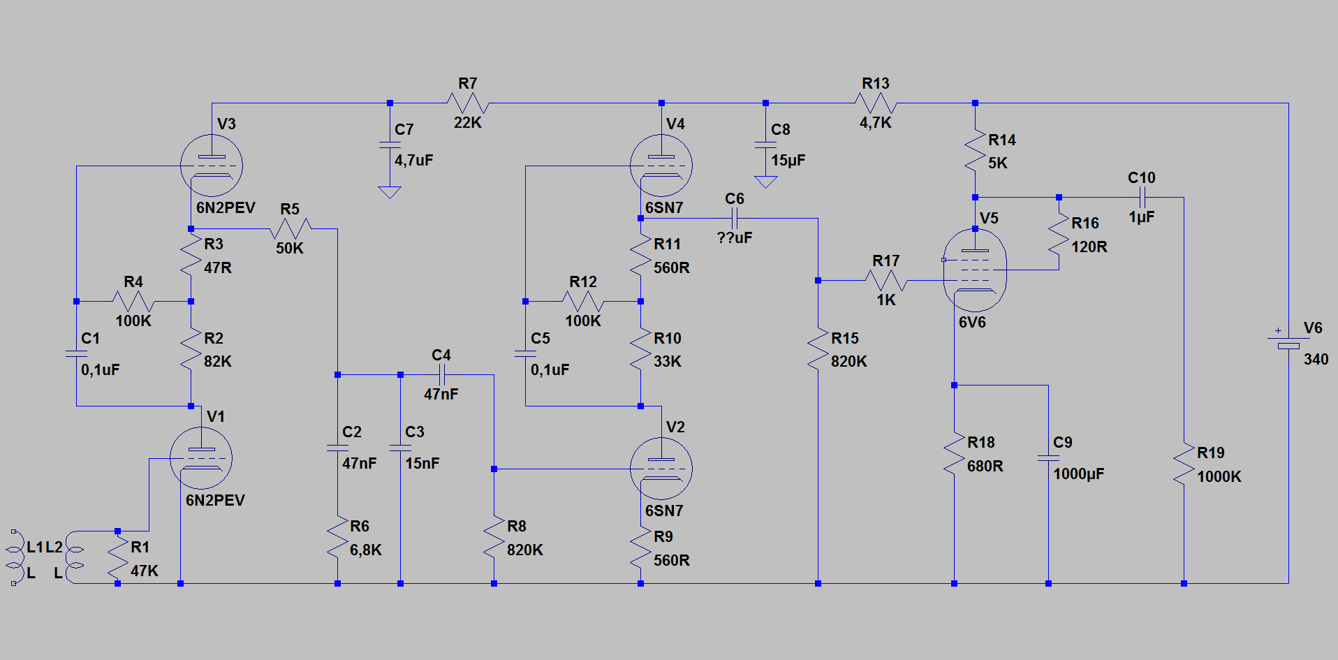

So how you guys feel about an integrated version with the 6V6 pre? Selector and pot infront of R17 and an SSHV on 50-55 mA as source per channel. Just a starterschetch.
Joined 2011
The idea came up merely because physical chassiework etc is a DIY factor that takes time and effort for most people when doing it properly and the powerline is a cost factor. When thinking of building 2 x 2 chassie+external psu, together with eventual microphonic sensitivity on the 6V6 that might take extra care in chassiework, it seemed like a decent idea.
What do you think of the powerline in this case, SSHV with following RCs?

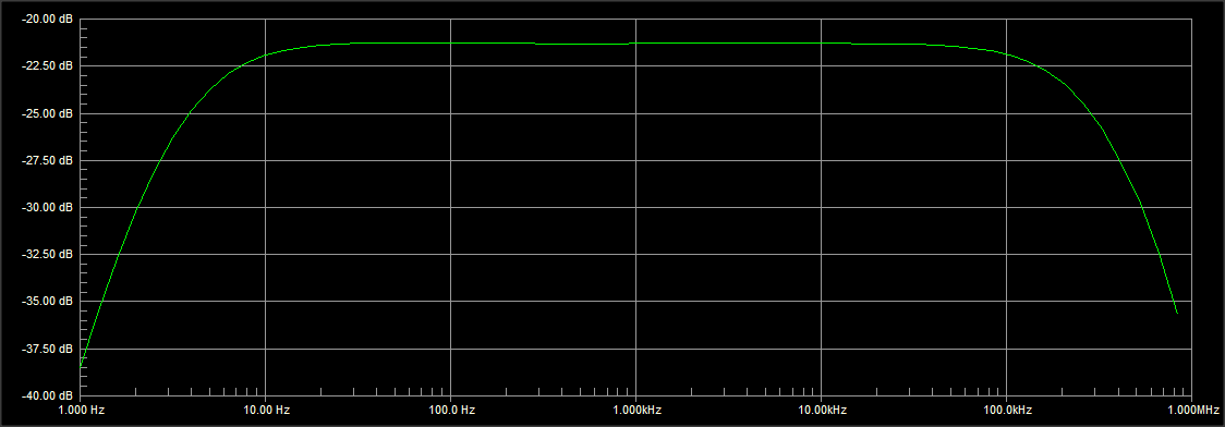

C4 rolls of from 40 down to 4 -3dB if Im right so I can practise safe sex above that I guess. Is that for avoiding chassie reproductions? Ive never dealt with riaas as you hear
Here is the roll-off for 1uF to 50K pot when C4 is kept at 0.047u.
1.5uF makes no appreciable difference for the same value pot due to C4's decisive effect on V2's grid impedance as designated in my original schematics. My 2C, don't change the infrasonic FR.
