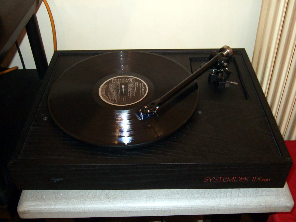

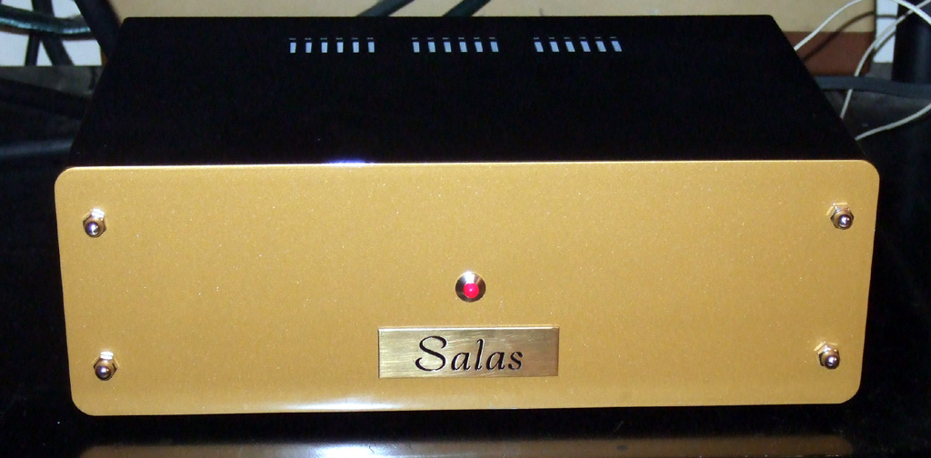

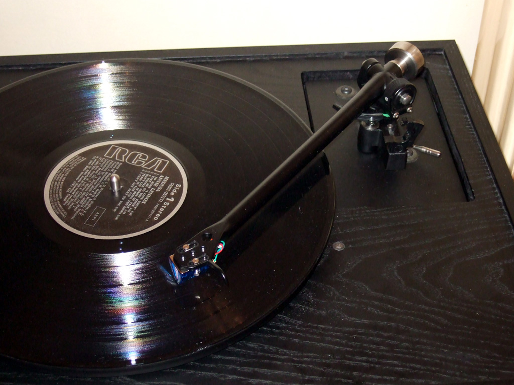

Incidentally there was cart setting afternoon today for a second hand old TT in very good condition (after little care) with the original HMC simplistic that carries the SUTs now, and 18K was very nicely balanced. Could clearly hear bias settings through test disc, minute VTF changes, record mat etc. Good tonality on music.
