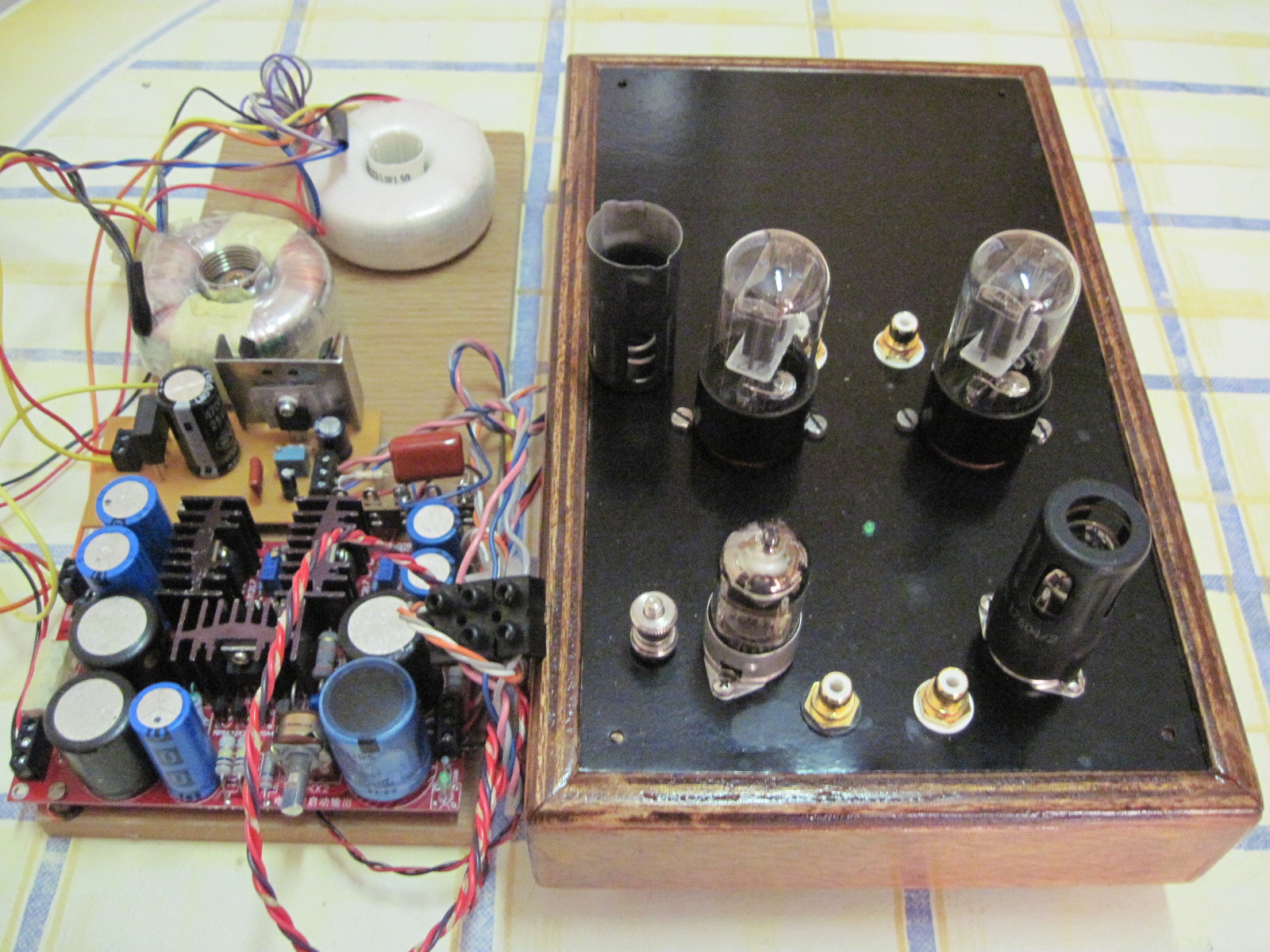

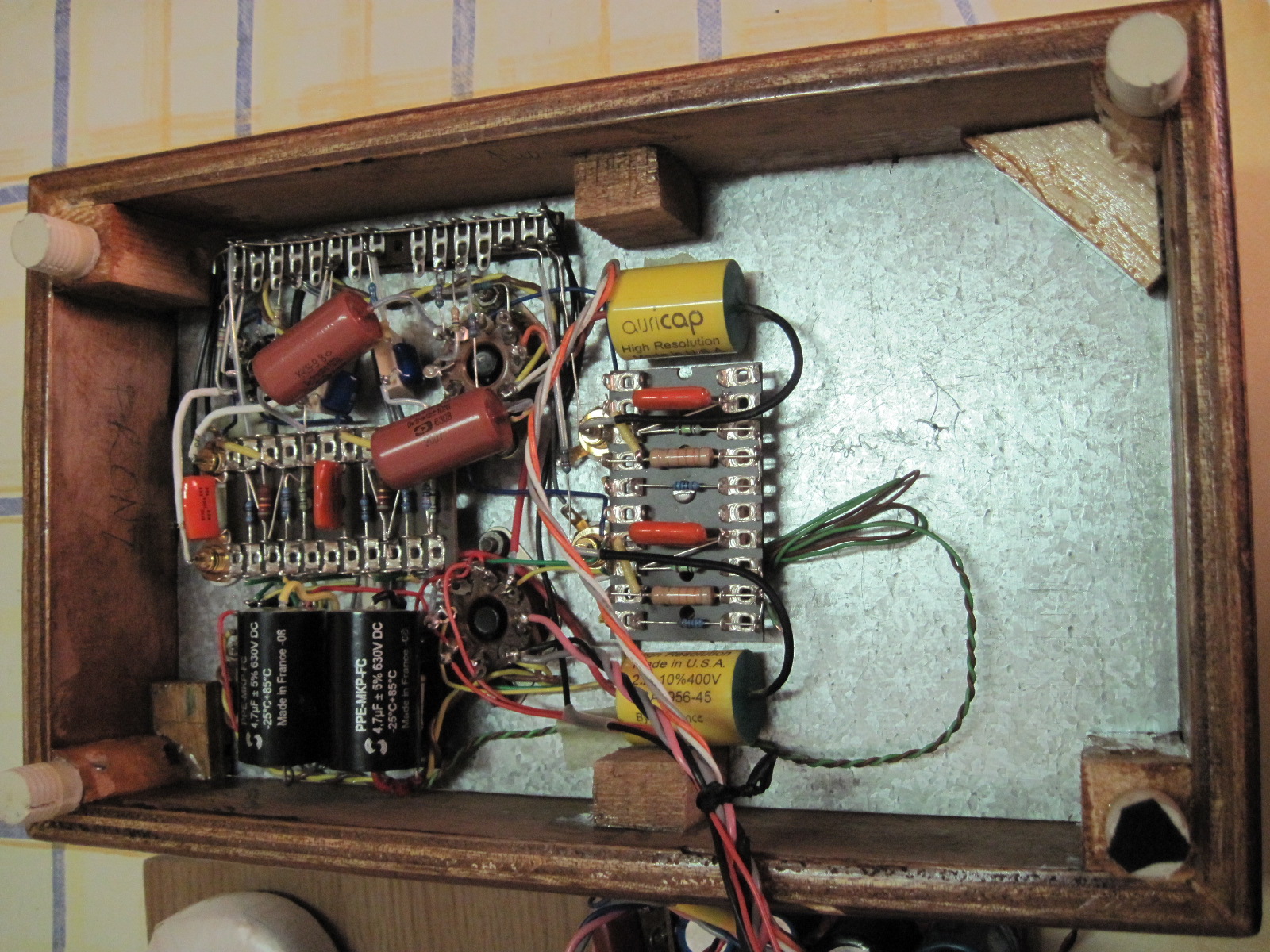

Yes of course; Woodturner's pics in particular and his build descriptions inspired me to take on the project. Salas's prompt and continued support to various builders (Merlin + RCruz among others) was equally important in instilling a sense of confidence in case problems cropped up during the build process. Pics to be posted in due course.
Here are a couple of pictures. Nothing fancy aesthetically. Mainly used materials I already had. Blank space on underside of amp is for SSHV and heater regs which will replace the present eBay Chinese regulator which supplies only 285V at B+. Used tagstrip/boards for component layout. Valves are russian 6n2p-ev and 6H8S. Even with no boutique components I like the sound a lot. No hum or background noise whatsoever. A satisfying project all round (despite the hitches).
