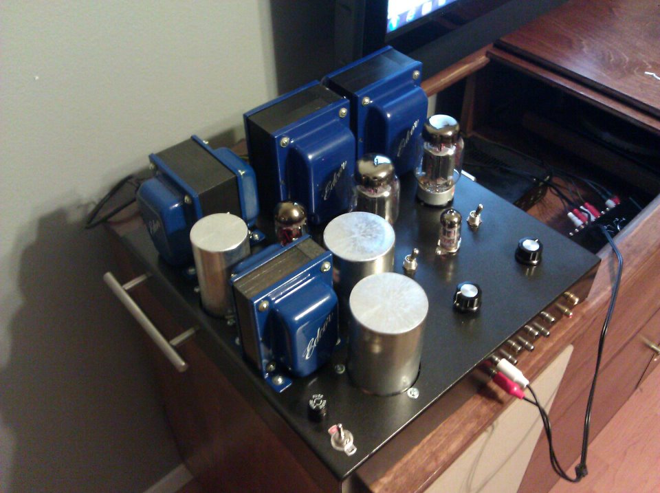

Oh yes. I've built or repaired a number of amplifiers. I just finished one Monday night. My new amplifier is the reason I'm ready for a new phono pre. All of a sudden my existing phono pre sounds very inadequate. 🙂Are you experienced with tubes projects in general?
