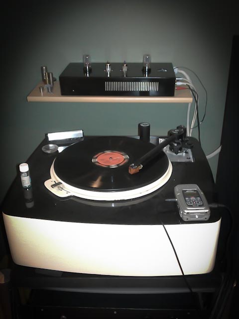

Following the request for a few new samples with the itch:
So here are the tracks:
1. STE-000.flac is Good Morning Little Schoolgirl by Muddy Waters from the Folk Singer album.
2. STE-001.flac is Country Boy by John Lee Hooker from Serves Me Right to Suffer.
3. STE-002.flac is Bridge Over Troubled Water from the MFSL 1/2 speed mastered LP
4. STE-003.flac is Shoulders from Larry Jon Wilson eponymous album.
Links:
https://rapidshare.com/files/483137785/STE-000.flac
https://rapidshare.com/files/1367913183/STE-001.flac
https://rapidshare.com/files/4001876657/STE-002.flac
https://rapidshare.com/files/1410477025/STE-003.flac
So, there might be the odd little bit of digital clipping here and there, but I didn't go back and re-record because, its infrequent and its obvious that its not anything else. You can hear the sizzle in the back of the Bridge Over Troubled Water track – that album needs a clean!! There's a few clicks on the Muddy Waters one I think.....
Enjoy, and let me know what you think. Recordings are all made from the setup shown below, Zoom H2 recorder connected via cheapo leads to the itch, deck is a replinthed lenco with a roksan tabriz arm and Benz L2 cart.
Fran

Just had a listen to those files. Correct tonality in replay (Riaa done OK), dynamic, distinct and warm at the same time. I can feel you had pushed the digital recorder's input dynamic range to the limit (clips some times even) and its impressive I could hear no hum or hiss from your build in the background with so high an input sensitivity. Especially in blues that had pauses where noise could creep in to relief. Bridge Over Troubled Water felt lush piano as it should, though the vocal has indistinct recording production with tacky reverb effect. I would rate Johnny Cash cover well above that one. Well executed, silent build. Congratulations.🙂
