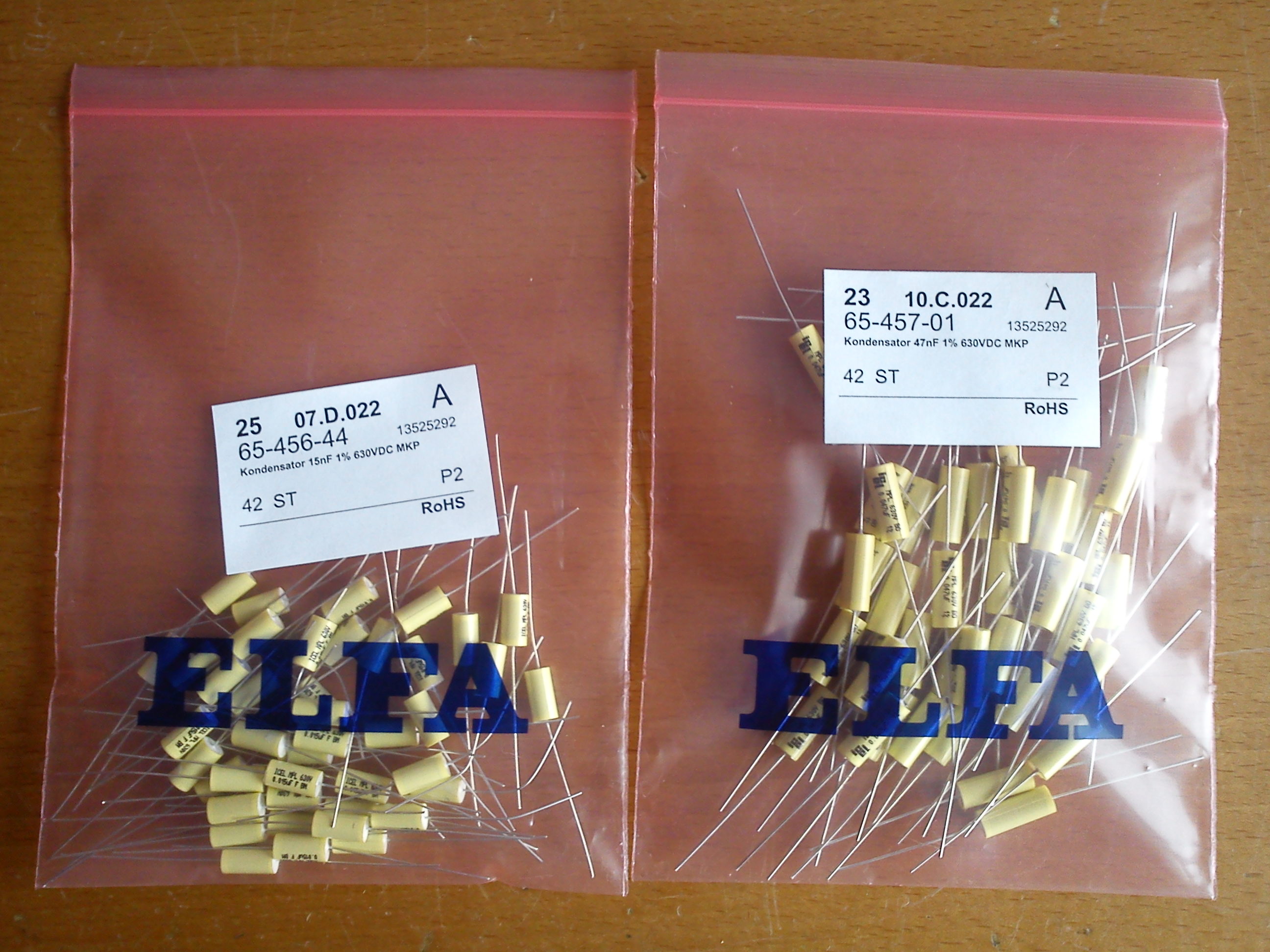

1% RIAA caps GB
I'm very angry, I don't know if after Christmas we will got the caps.
Felipe
Felipe: looks like after christmas maybe?

1% RIAA caps GB
All caps sent to all GB people (Fran your 4 caps Elna Cerafine also), for everybody: please let me know when you got them?
Happy New Year
Felipe
Happy New Year
Felipe
You will be able to know Riaa is standard between you guys with those caps. When exchanging tips knowing where you stand. Good move.
They arrived safe and sound in Ireland.....
Many thanks Felipe my caps arrived this morning.
Thanks for letting me know.
