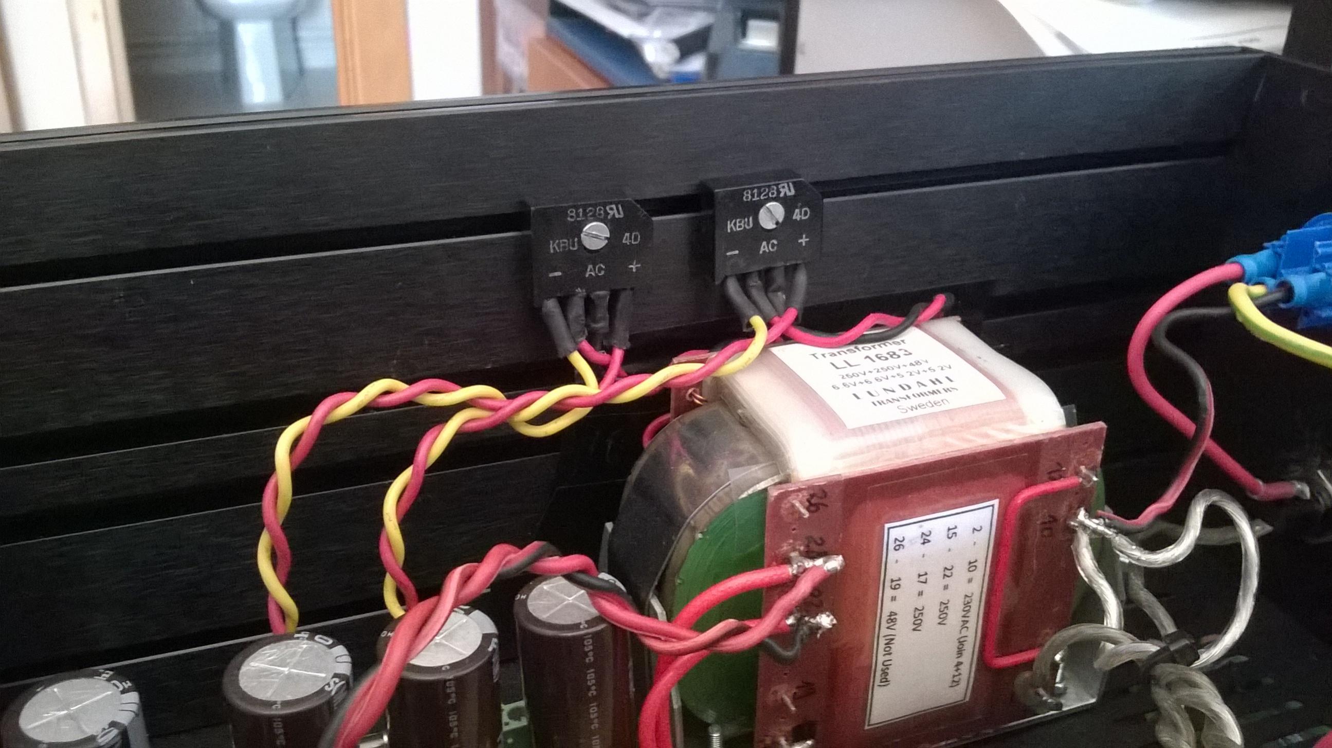

A little bit complicate to measure drop across their anode to cathode.
AC mains 232VAC.

Thanks Deux ex machina :)
So its 0.8V drop at 1A and two drops will be in a bridge i.e. 1.6V loss. Thus this 6.6V AC trafo drops below 5V AC given the 6.4VDC Merlin reported at his LM317s inputs when loaded. That is only good for non regulated DC or just AC heating. Even if using LM1117 (the adj variety) regs they are 1.2V min drop spec LDO at 800mA. No solution even with Schottky bridges. Only solution I see for sustaining two branches of regs with this trafo is a voltage doubler per winding.
Voltage doubler - Wikipedia
diyAudio Chief Moderator
Joined 2002
Even if its 1V drop for the whole bridge we still face a roughly 5.25V AC loaded result per winding. Impossible to sustain any LDO fitting the 317 form factor and connectivity. I don't know, then there are only SMT LDOs made for digital stuff in mind which are very efficient but will need luck for heat dissipation at nearly 1A per branch. 1A is max for this TI one that has 0.3V min drop and could be set at 6V if the mains would be never below 230V and some guys offer it soldered on PCBs also: http://www.ti.com/lit/ds/symlink/tps7a47.pdf
Even the above scenario is right on edge borderline...
Joined 2002
The tx have two secondaries more of 5,2V AC 3 A each so can reach together 11,8V AC?
That I thought of too but it would lose the separate heater branches advantage. The other branch can't be independently grounded anymore (watch that or it will short). It will receive the cathode voltage lift of the other branch but it could be a solution if no hum or SQ loss occurs.

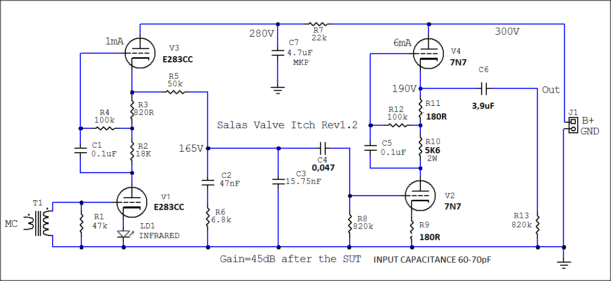

Yes C4 is 0.1uF (100nF). C6 should also be no less than 2.2uF (as designated) for the bass alignment to remain correct enough. R8 820K can be made 1MEG to push the low bass a bit up if C6 is small and/or the following line preamp's Zin is below 20K.
Joined 2009
C6 is 3,9uF
Salas attached schematic used for E283CC & 7N7 tubes.
Salas can't adjust to 6.1VDC because voltage of regulator jumps between 6VDC and 6.20VDC or more.
