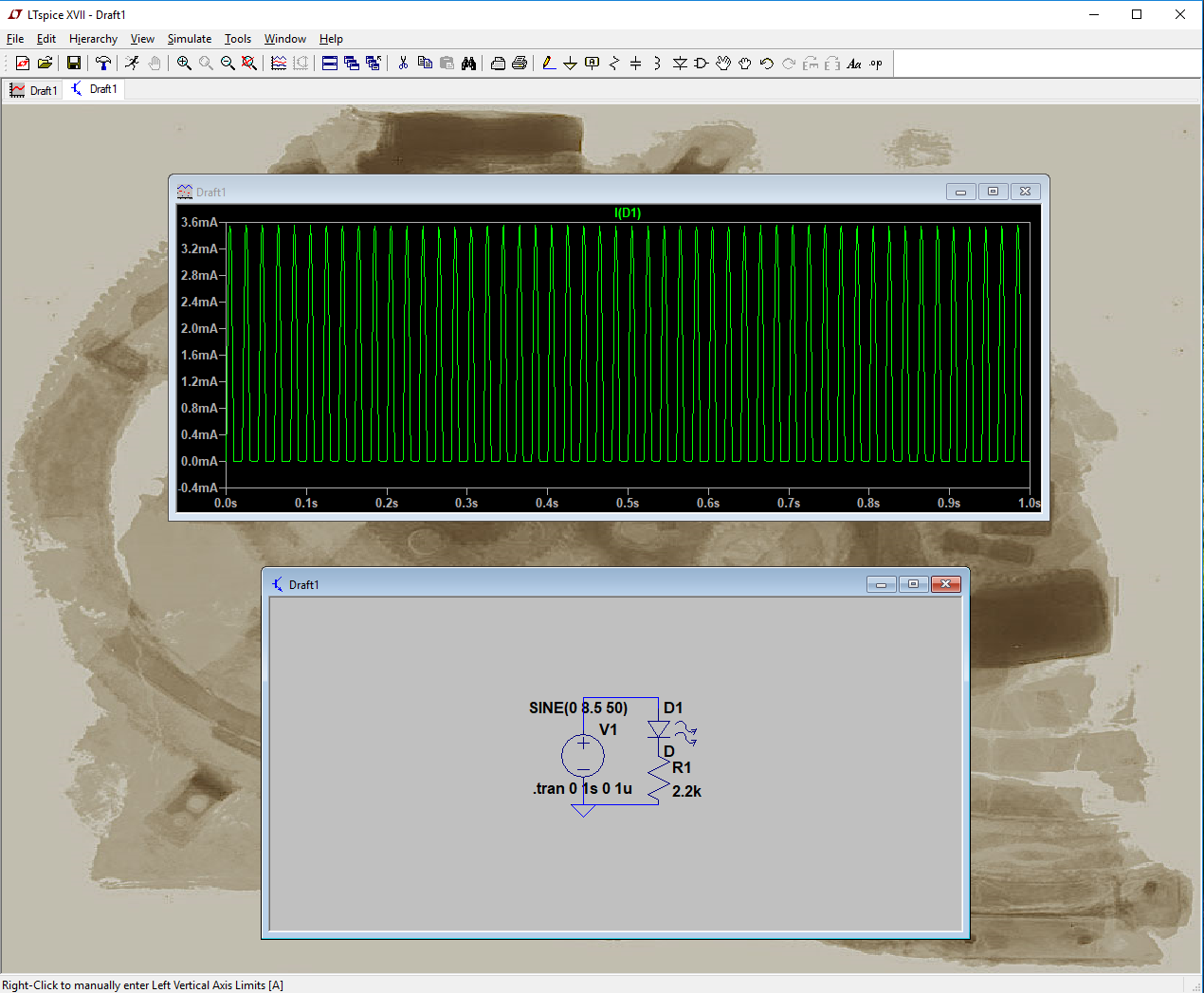

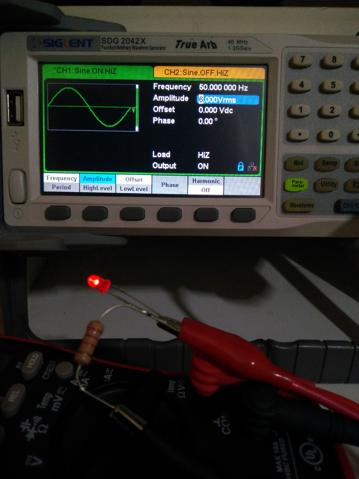

The LED will behave like a half wave rectifier diode and the 2K2 resistor as the load I believe and it will light up on positive wave bursts.
I strongly recommend either connecting a reversed diode across the LED or connecting a rectifier in series with it. Most LEDS do not like being reverse biased and will break down with as little 3 - 4V reverse polarity across them. Note on 50Hz power you might find the flicker annoying. Operating on DC is preferable.

Yes good advice. AC source for an LED is not optimum. But what if in need and having no other parts than a heaters trafo an LED and a resistor? A very unlike scenario but I thought lets investigate it just for fun. This little generic LED proved a tough guy at 6V RMS 50HZ. For half an hour at least until it was too boring to wait for it anymore for doing something bad. 🙂
It wasn't as bright as with DC of course but still bright enough. The flicker was showing up through the phone's screen refresh but it was elusive to the naked eye.

They may last hours, days or even weeks but they will degrade over time, and in some cases they fry quickly. I can't imagine a scenario where some suitable diode isn't available in a short time frame, but a pair anti-parallel connected LEDs would work. Tuner Information Center (TIC) has many references to the LED replacement lamps running on AC that failed or got dim very quickly.
The flicker is more or less annoying to specific individuals and is most often noticed in the field of peripheral vision. I found the flicker from 50Hz incandescent lamps noticeable from some angles as a teenager. These days I don't know. Very visible on 25Hz which was common in upstate NY and a few other places into the 1960s. NYC's MTA was still using 25Hz rotary converters in the late 1990s to make 600VDC track power, CON ED had a contract to provide 25Hz power for this purpose until 2000.. IIRC.
