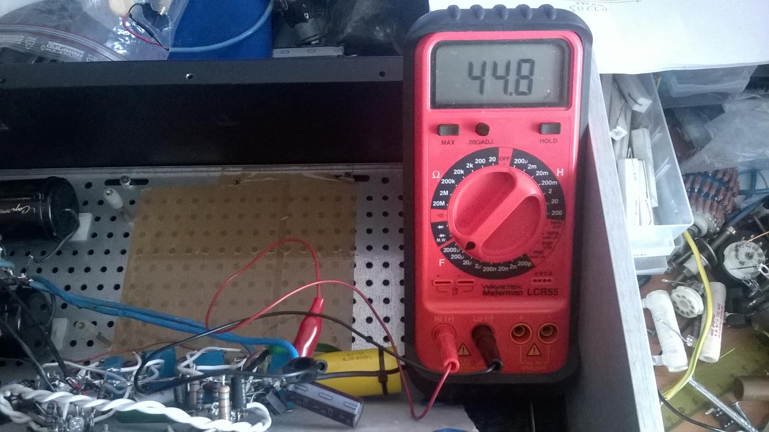

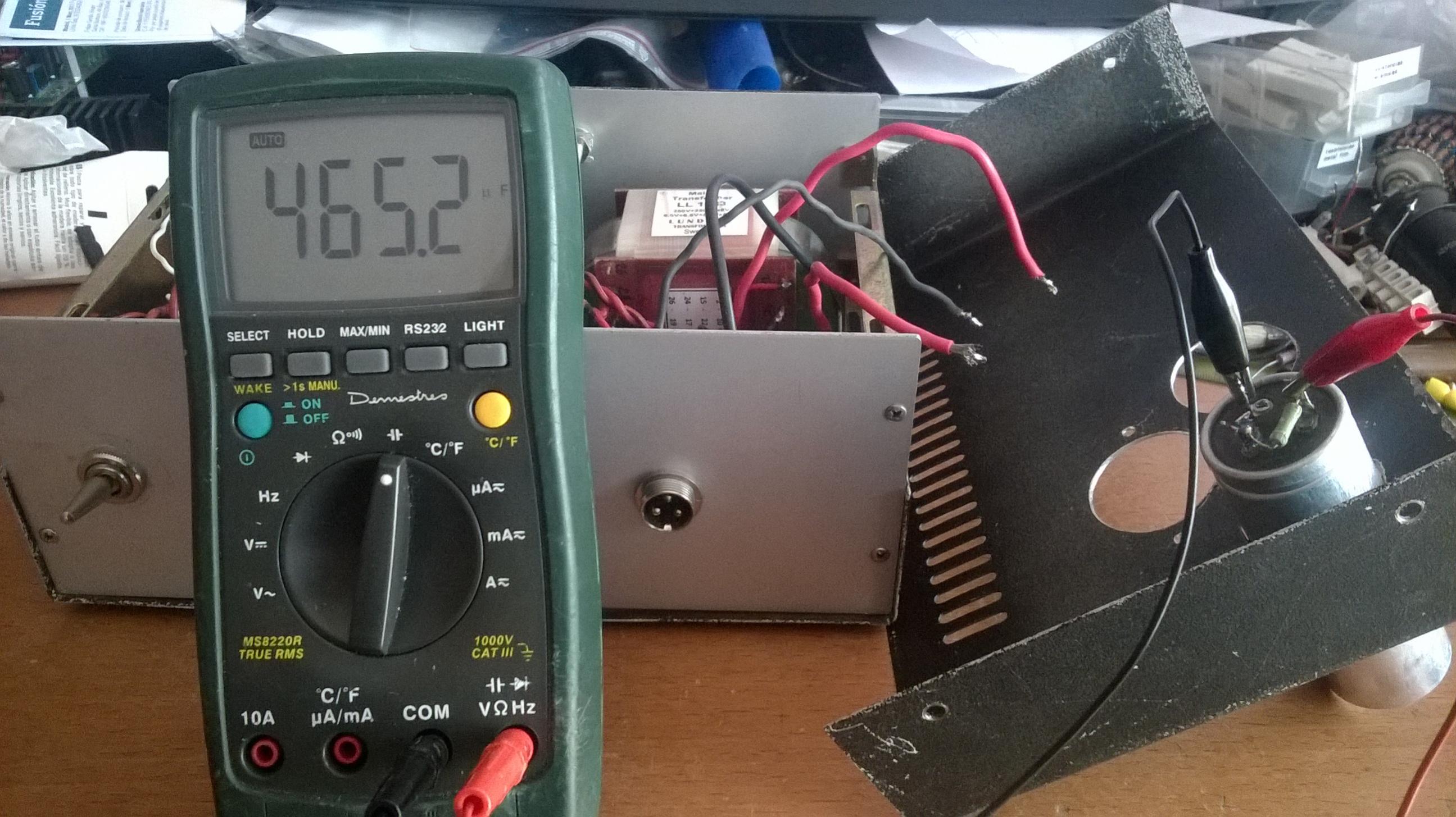

PSU cap is ok see attached measurement, can be the heater elevated cap?

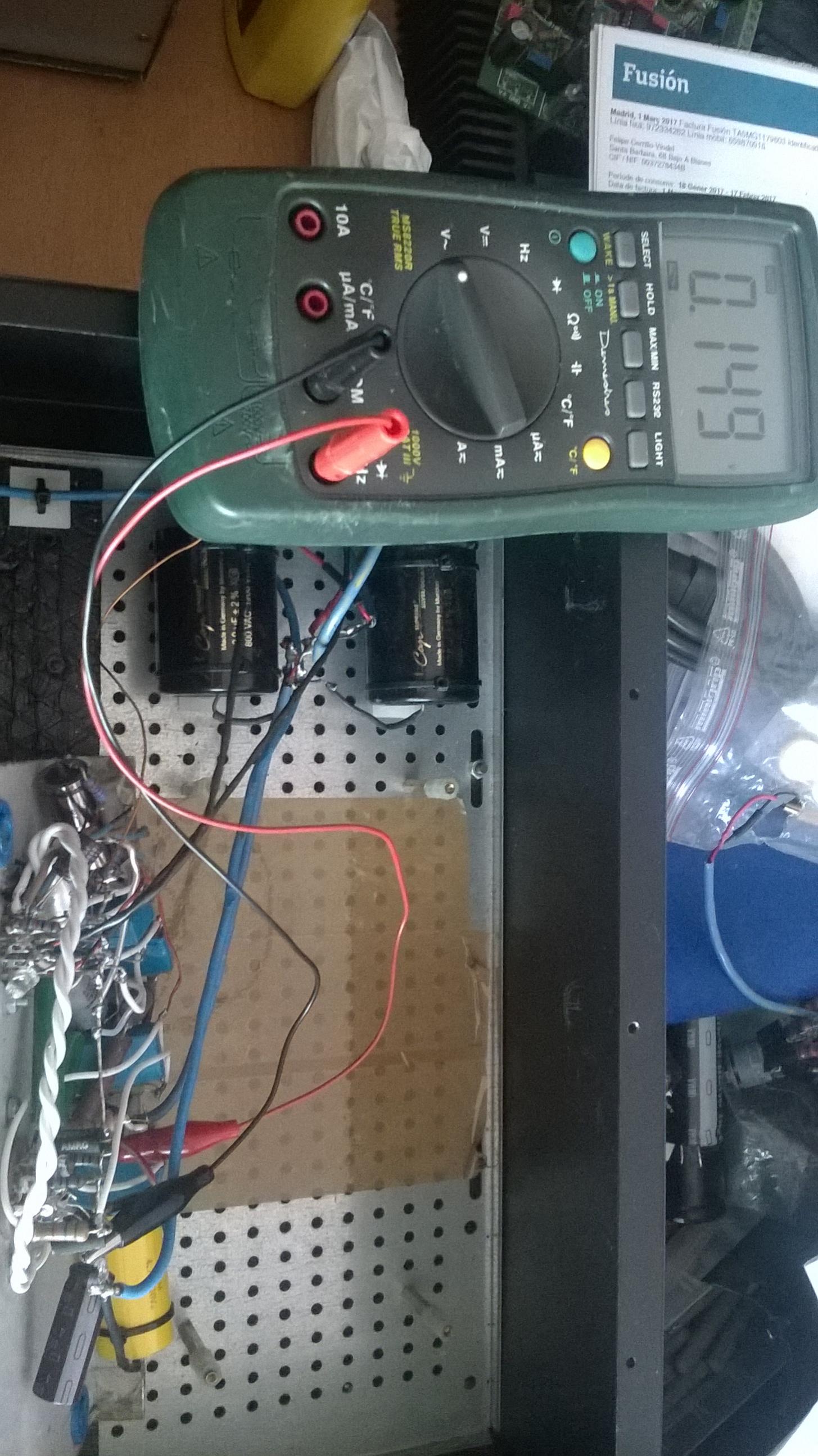

Attached DVM set to AC measurement, both outputs loaded with 100K resistors.
149 mV is from my perspective a very stable rail when we are talking HV.

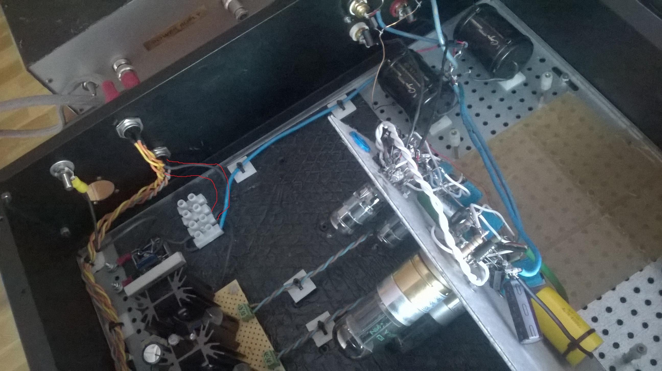

Thanks guys, attached pics of grounding.
Left pic SLB connected to chassis
Left centered pic mains PSU cap ground connect to SLB
Right centered pic signal ground from Itch to SLB
Right pic mains earth coming from PSU chassis connected to Itch chassis
