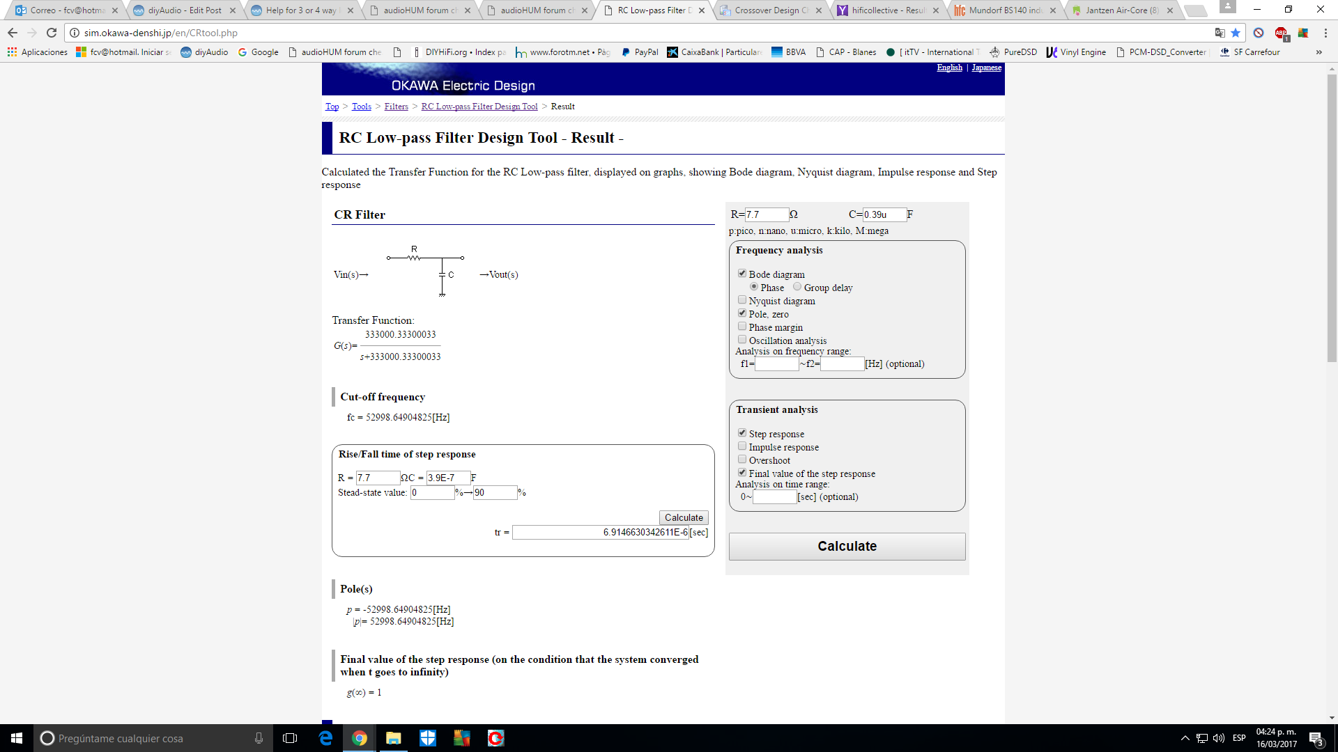

What about if I use an RC low pass filter in the PSU for aprox. 51kHz with 0,8 ohms and 0,39uF Jensen PIO?
Thanks George too much numbers, 7.7 ohms 0,39uF 53kHz

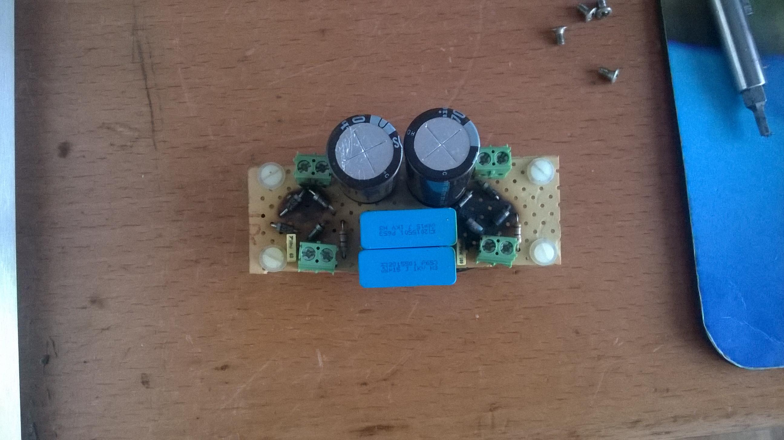

Very toasty rectifiers, I'd have to believe the only place with that much current flowing would be the heater supplies.
I recommend 3A Schottky rectifiers minimum for the sort of load current you are likely to see. Also when you build the new one space them 5mm off the board.
If you are using one bridge to power each channel the peak current is probably several amps or more - even a Schottky might be dissipating more than a 1/2W and conventional silicon over 1W and will get very hot.
(All swag on my part, no calculations involved)
Don't use that board material! 😀
