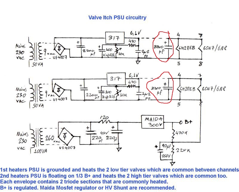

Salas if the heater regulators are in the same box with valve Itch are necessary the 3.300uF near the heaters?

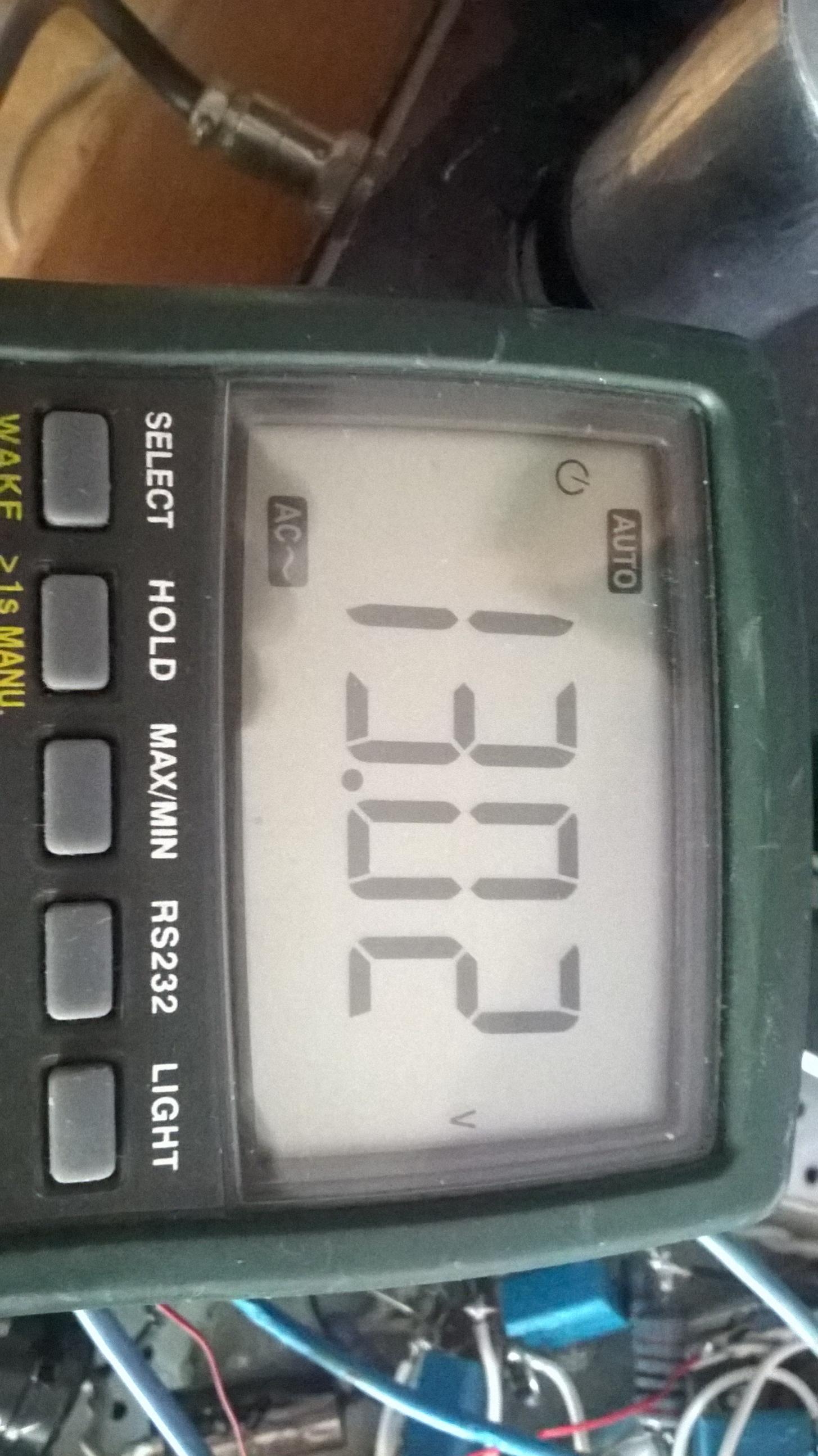

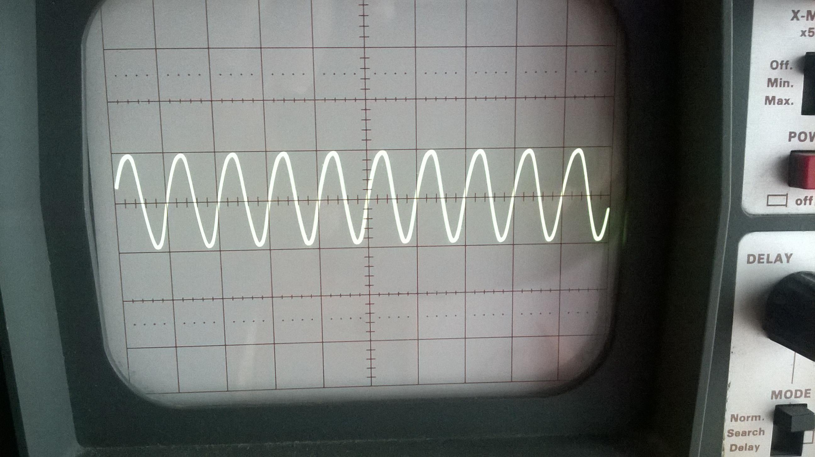

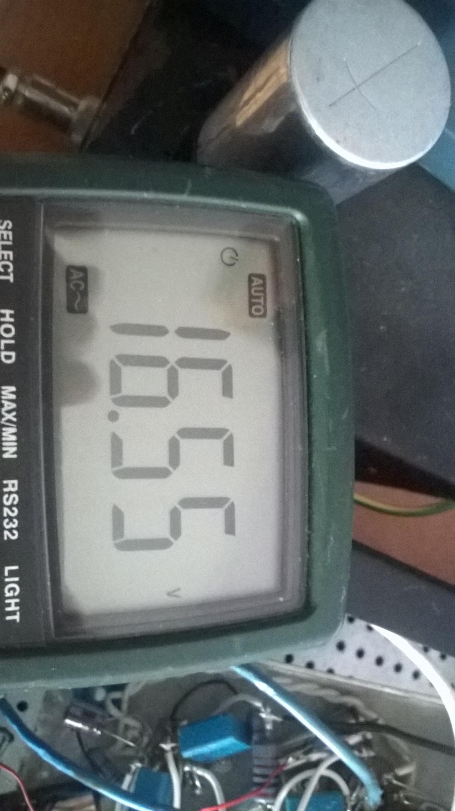

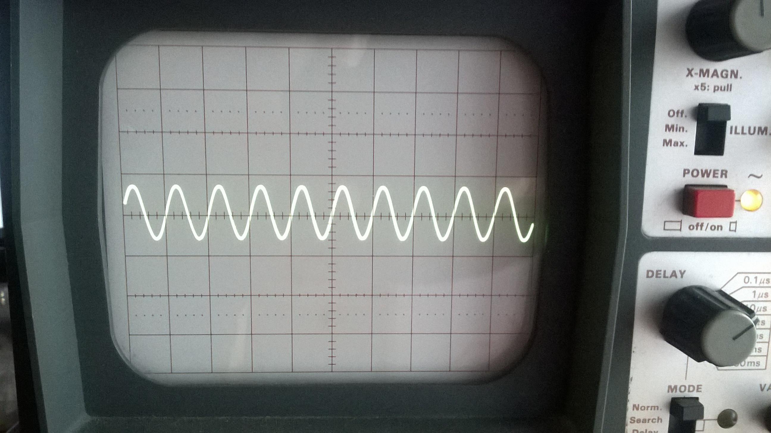

Salas channel right have more gain than channel left, attached scope shot 1kHz 10V/cm 1ms
