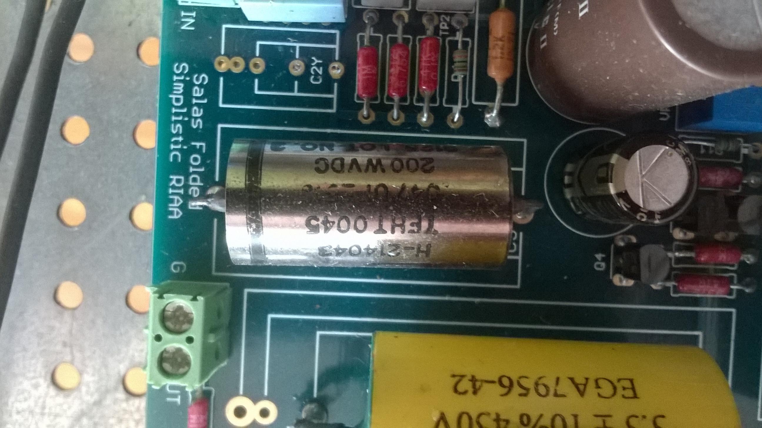

What type of caps are you using ?RIAA 200VDC teflon caps working near 1 day without problems.
Pics ?
Finally I ordered Shinkoh for RIAA 50k 1w & 6k8 0.5w. Also ordered 820R 0.5w Shinkoh for first stage & 12k 2w Armtrans. When changed the RIAA caps also changed the 320R upper tube 2nd stage for Shinkoh 0.5w that I discovered in my stash.

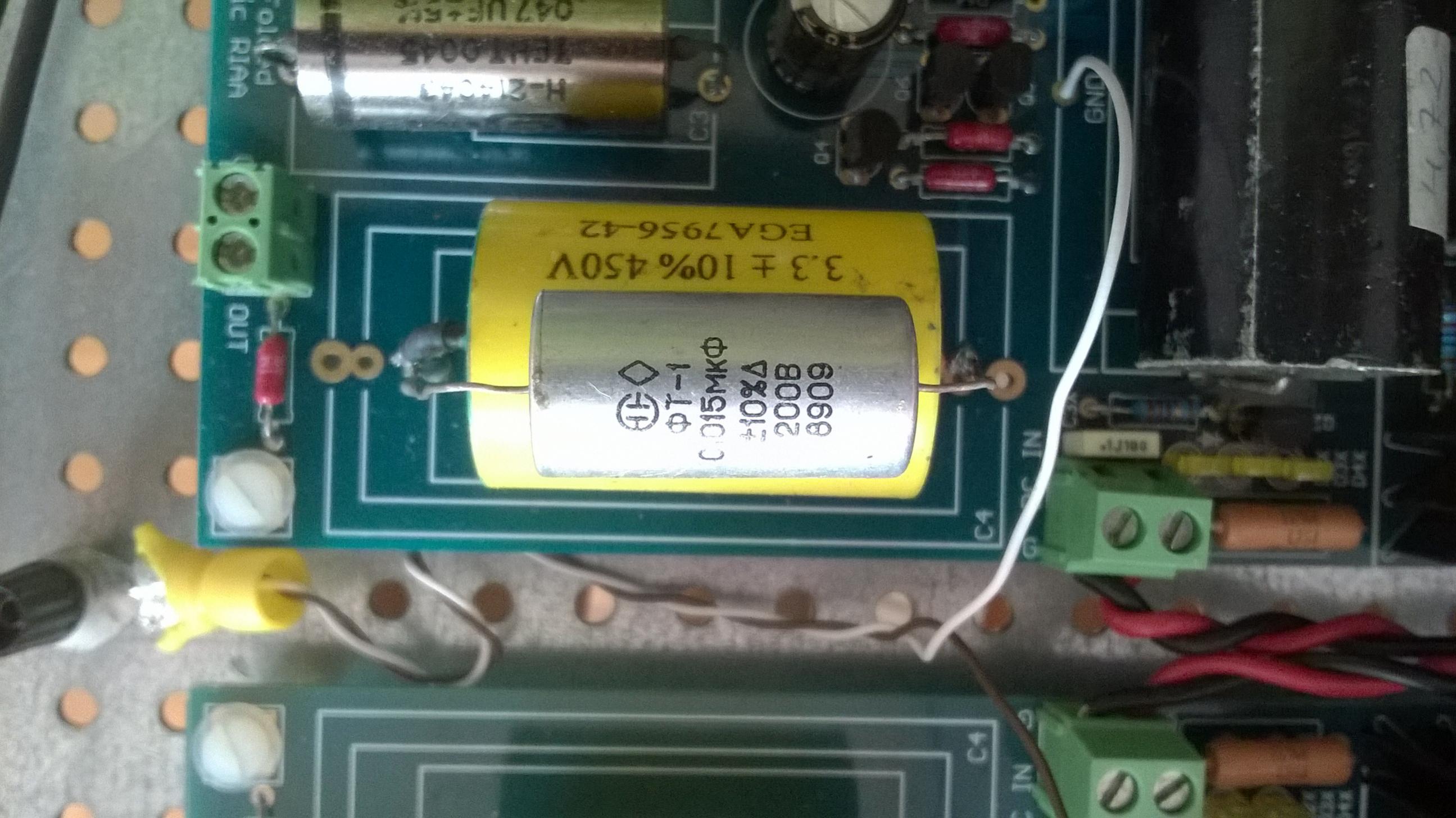

Attached pics FSP build with teflon caps that are the same used in the Itch.
Salas I use 47nF teflon film & foil cap as interstage, if I change to 100nF teflon film & foil I will improve the SQ?
The interstage coupling cap C4 100 nF is set for optimal frequency response at 20 Hz (19,4 to be precise) together with R8 820K. Minus 3 dB response it then at 1,94 Hz. Your 47 nF has optimal bass response down to 41,3 Hz with the 820K, minus 3 dB is at 4,13 Hz. I doubt you will hear any difference tho, and maybe its only doing good for rumble.
47nF USA, 15.70nF Russian ft-1 the same bought togheter Ricardo
Thank you so much..... would you share your american teflon cap supplier ?
If you want your frequency response to be close to what it is with a 100nF coupling then put two 47nF Teflon caps in parallel.
