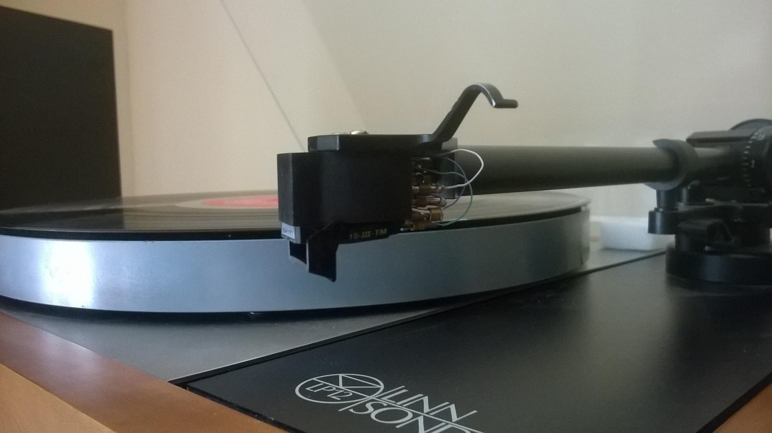

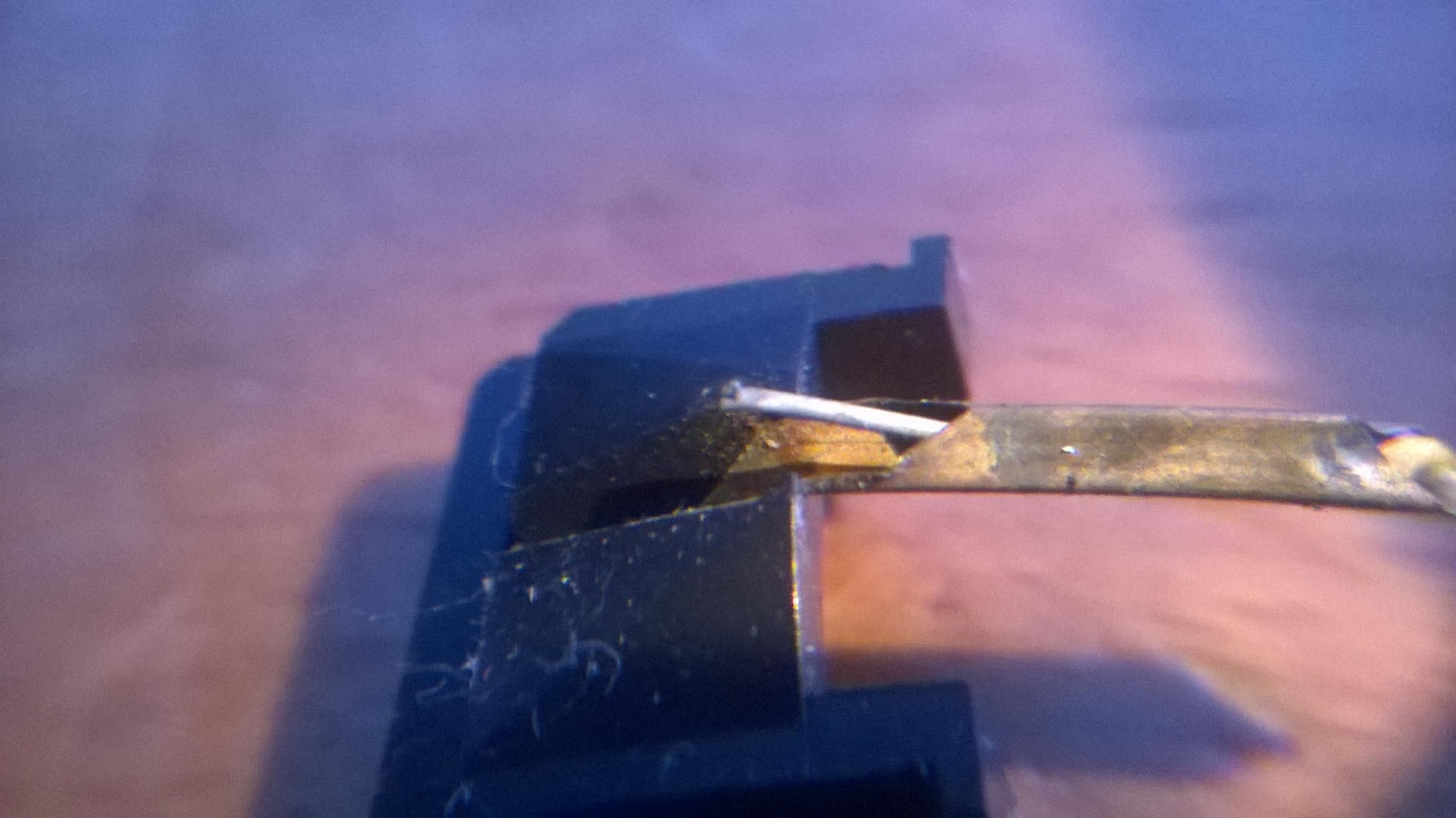

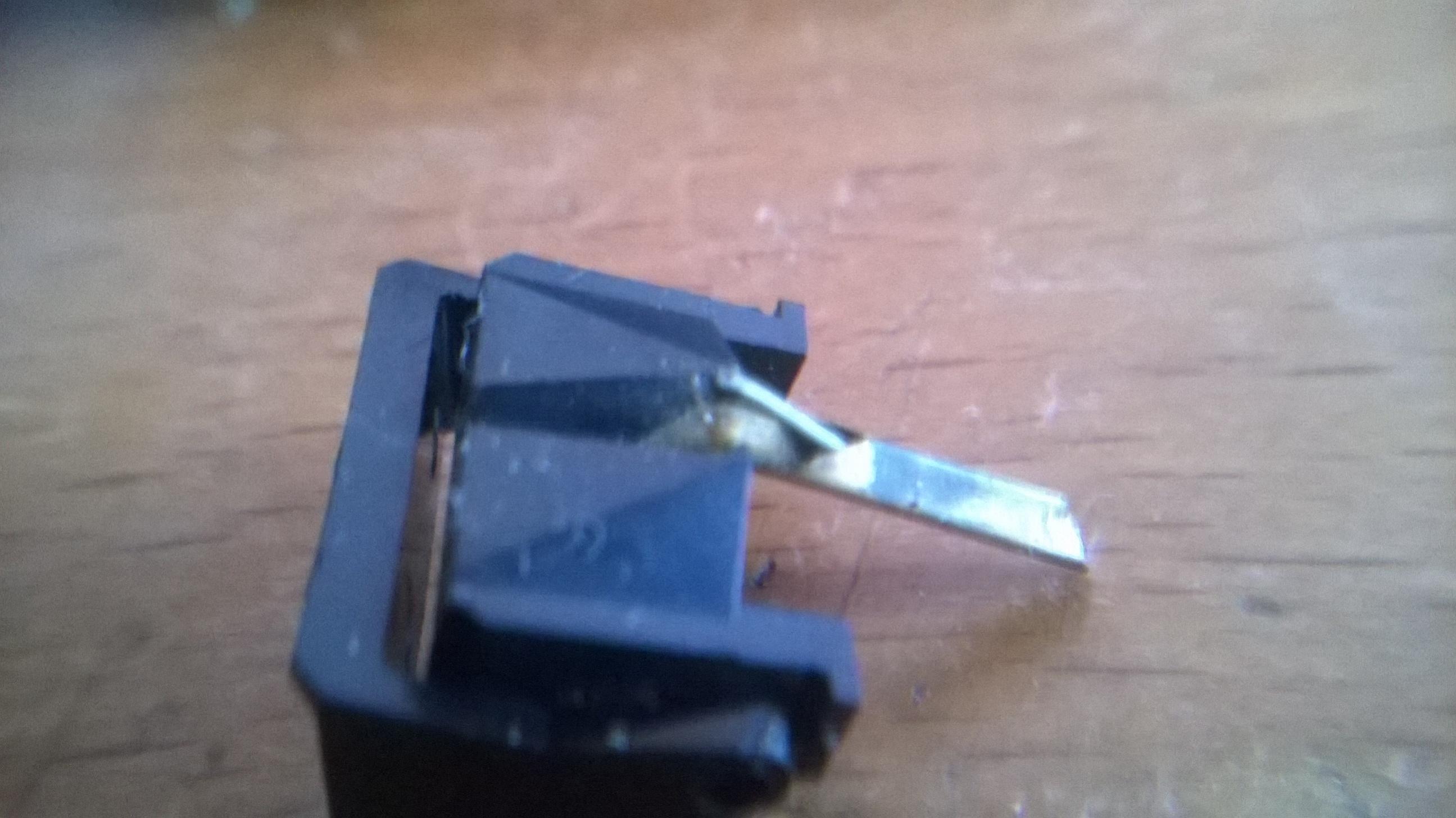

Takes a tripod and spot focus, now blurry.
It's the camera phone.

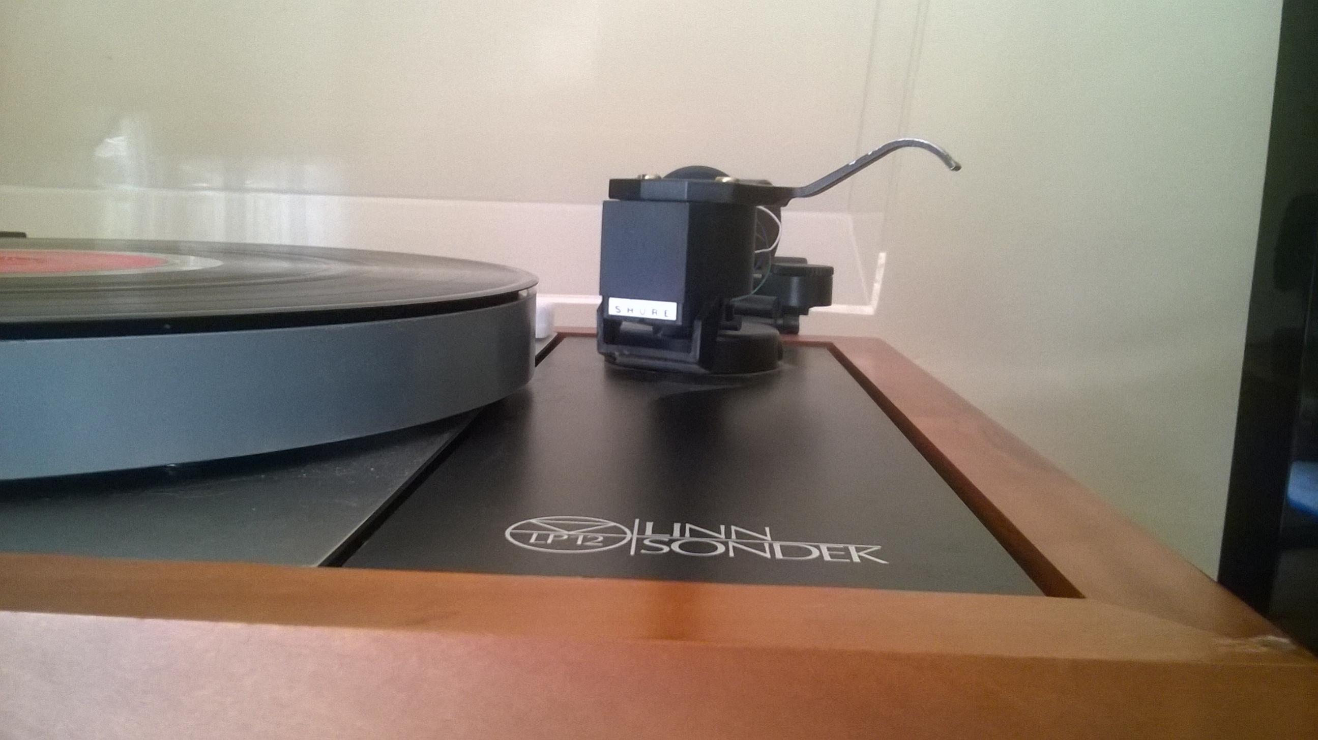

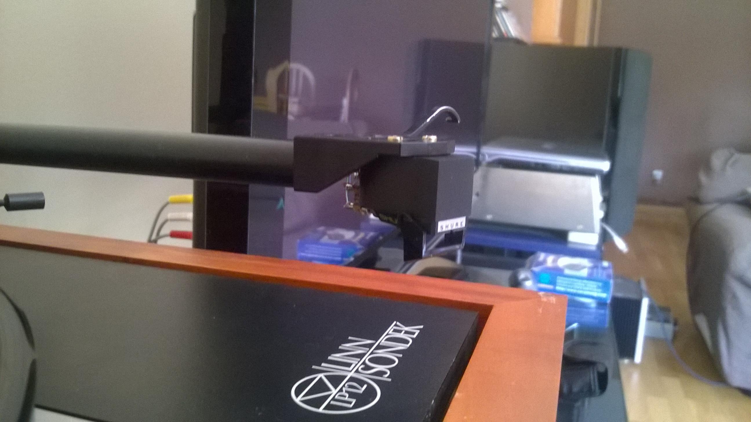

A more informative pic this last one. Looks like the cantilever sits OK straight in its place from this angle.

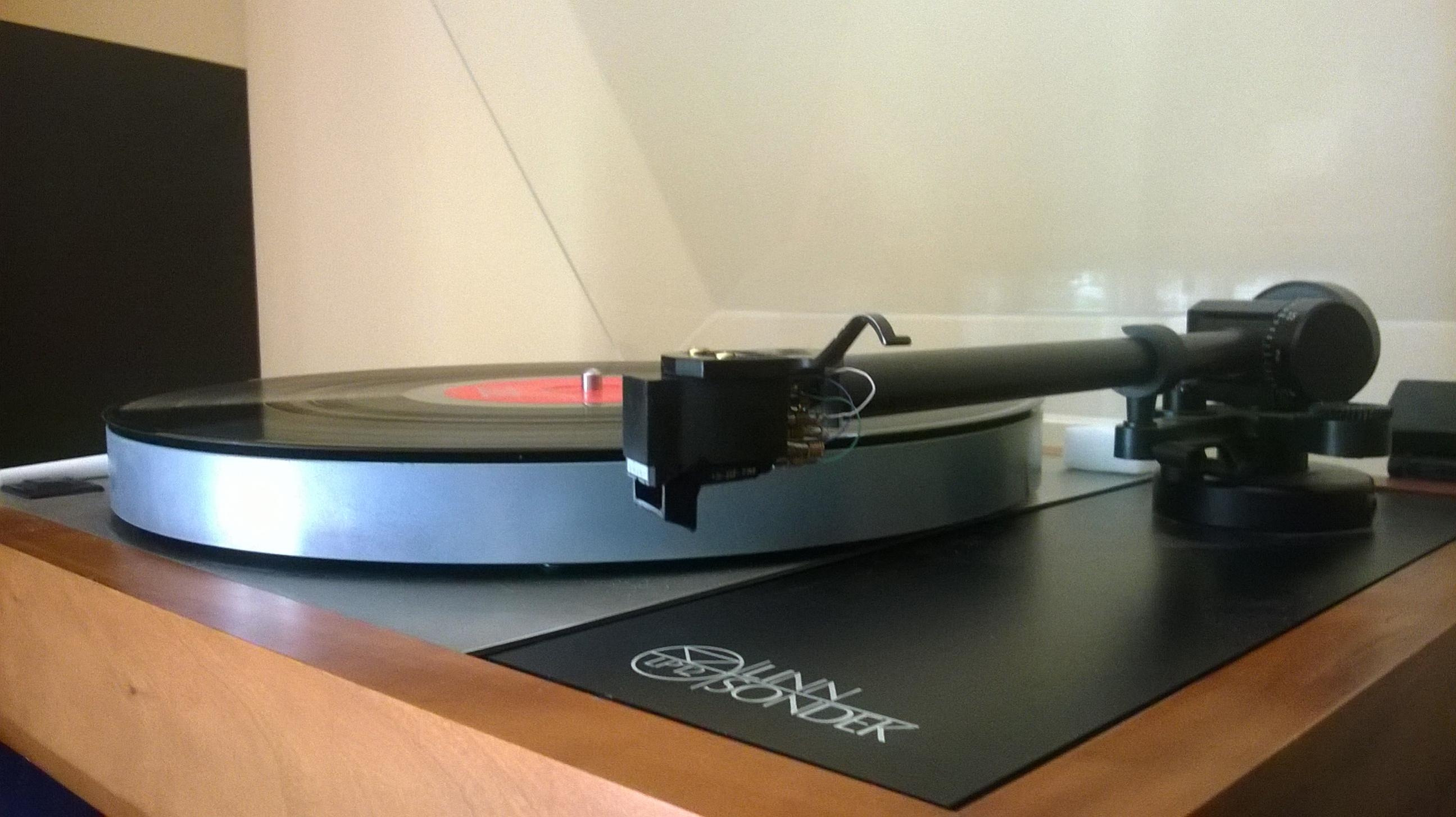

I would not risk to dip it in ultrasonic bath if you mean sophisticated cleaning because I am not informed about what may happen to the suspension, but I am not expert on cleaning either, so better ask more TT people.

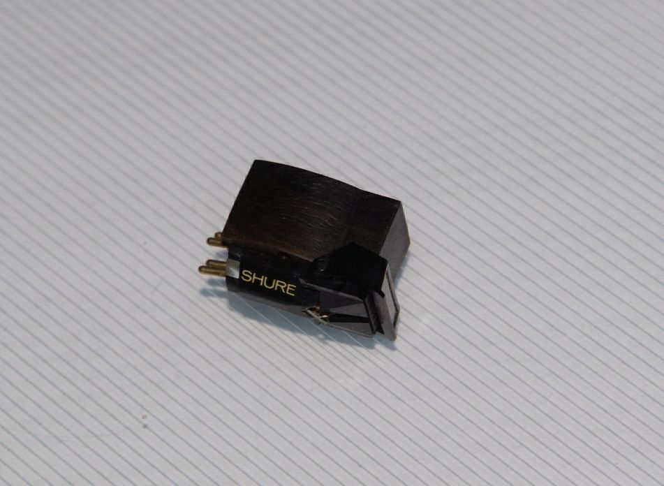

Gives much more classy look. Congratulations. I like it on this arm. I hope it gives something more to SQ also. That would be great combination.

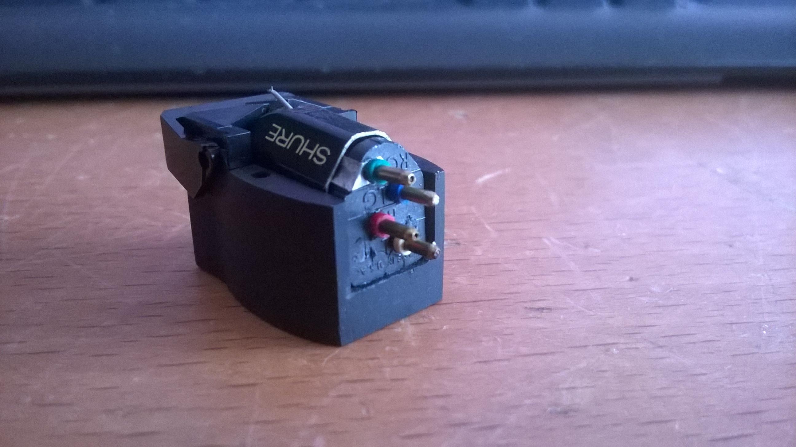

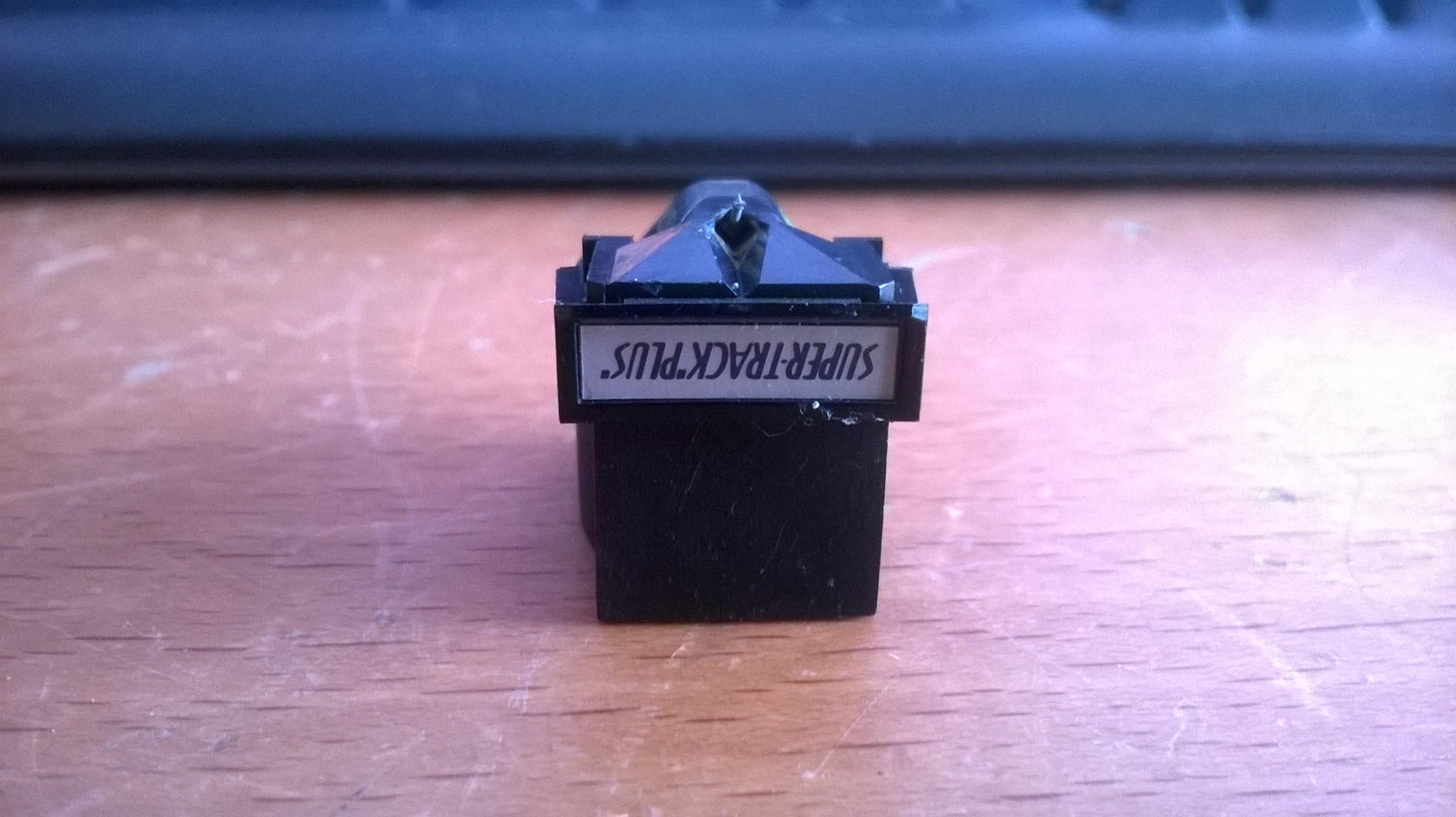

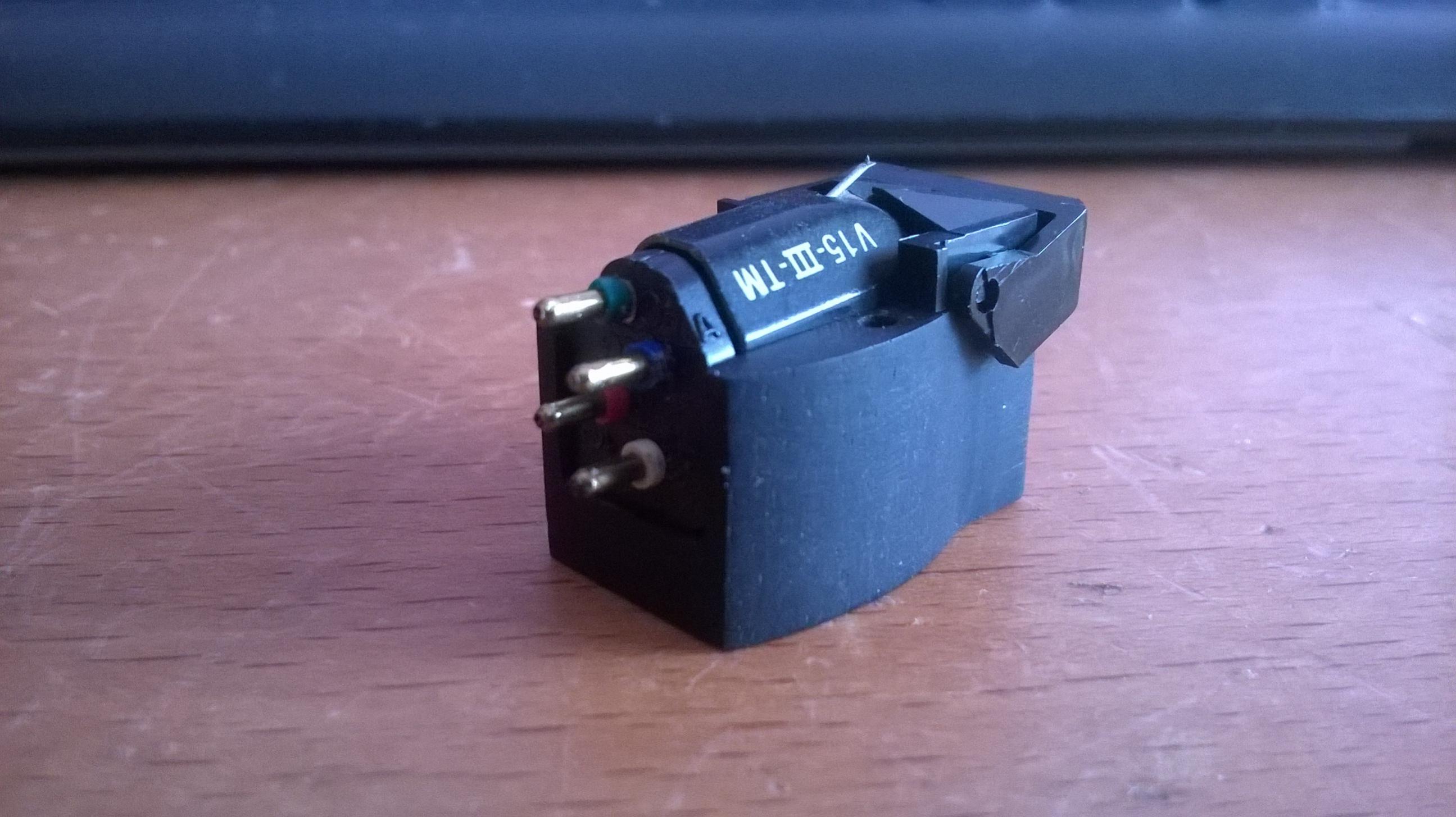

Thanks Salas. Real is more beautiful than the pics. This one is the ebay seller pic:
The soft bass using original plastic body has dissapeared with the ebony body, now more deep, clean & strong. Still playing with input capacitance for optimum SQ.
