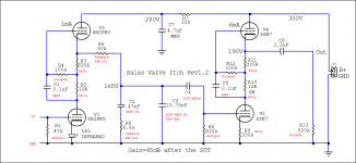

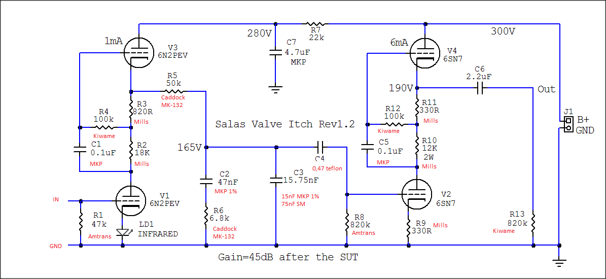

Across R2 and R10 is better because easier for DMM scale. Those 1mA & 6mA are approximate. Ball park indications. Use only individual R13s for each channel output. 1 Meg is good too. Those are to keep the output coupling capacitors always referred to ground. Some don't use any but using is better for pops when connecting / disconnecting RCAs.Salas changed all the resistors according Rev1.2, to measure 1mA across 6N2P-EV is voltage across R3 or R2? to measure 6mA across 6SN7 is voltage across R11 or R10? It's correct to use only one R13 for both GND outputs?
Ordered Ebony😉
Nice. Happy to know if it helped and to see photo. Surely looks like more serious Shure when in ebony. 🙂
"Curve is +/- 0.2dB 100Hz-15kHz including the SUT aberrations" I had wrote back then. Means the curve was checked for V1.2 plus it sounded good on HF too. But this was through MC with Dynavector SUT + my bench gear accuracy + my Hi-Fi system subjectives as comprised at the time. If you feel in your Hi-Fi with your Shure MM directly connected it needs little more bright or dull change the value a little.

I know you told me, only to be sure: Increase capacitance less bright or if decrease capacitance more bright?
Yes you remember well about RIAA HF capacitor manipulation
