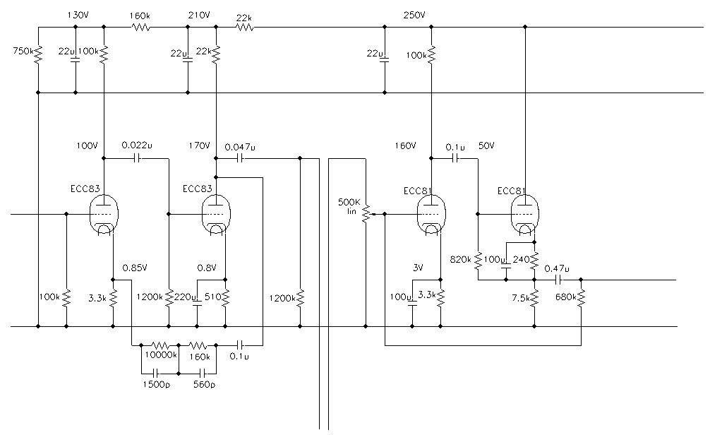

Yes, the Claret was active if I remember and Thorsten had cloned it.
Doctorjohn Cheaptubeaudio: Audio Reviews and More: Review: SHINDO Claret preamplifier
http://community.fortunecity.ws/rivendell/xentar/1179/projects/claret/Claret.html

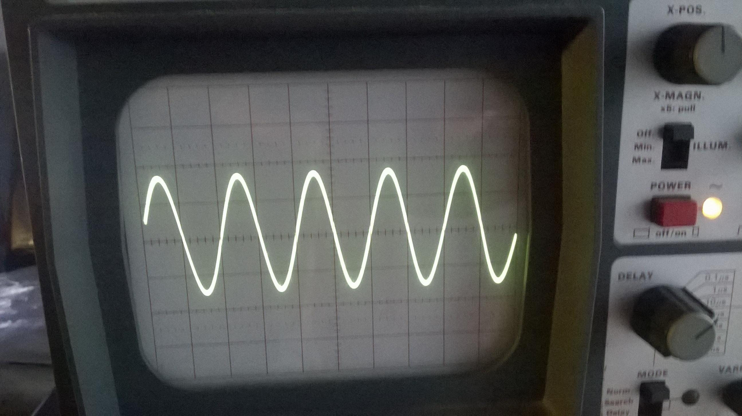

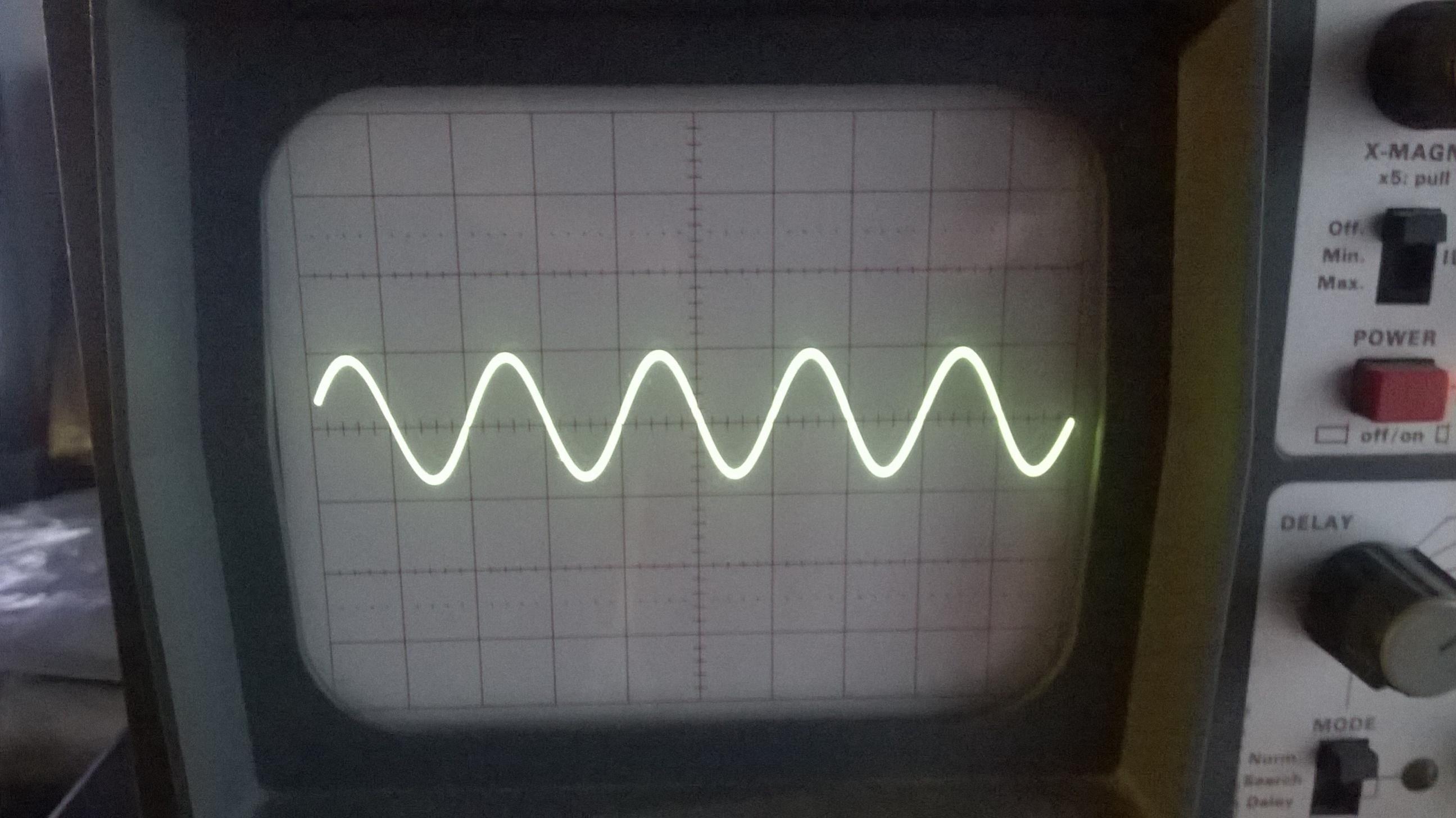

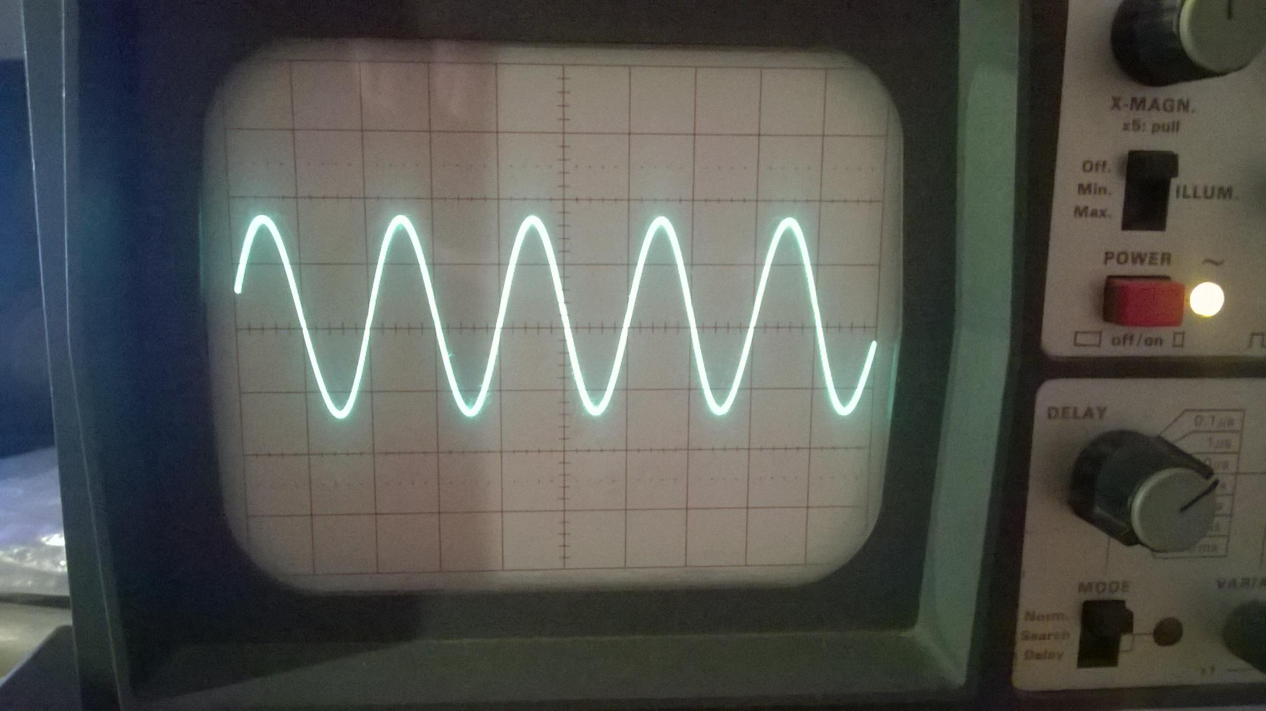

Salas channel right have more gain than channel left, attached scope shot 1kHz 10V/cm 1ms
That's 2dBV difference. Exchange tubes between sockets in their respective stages as George said. Both for input and output ones to average out their gains, not only trying various samples, it helps.

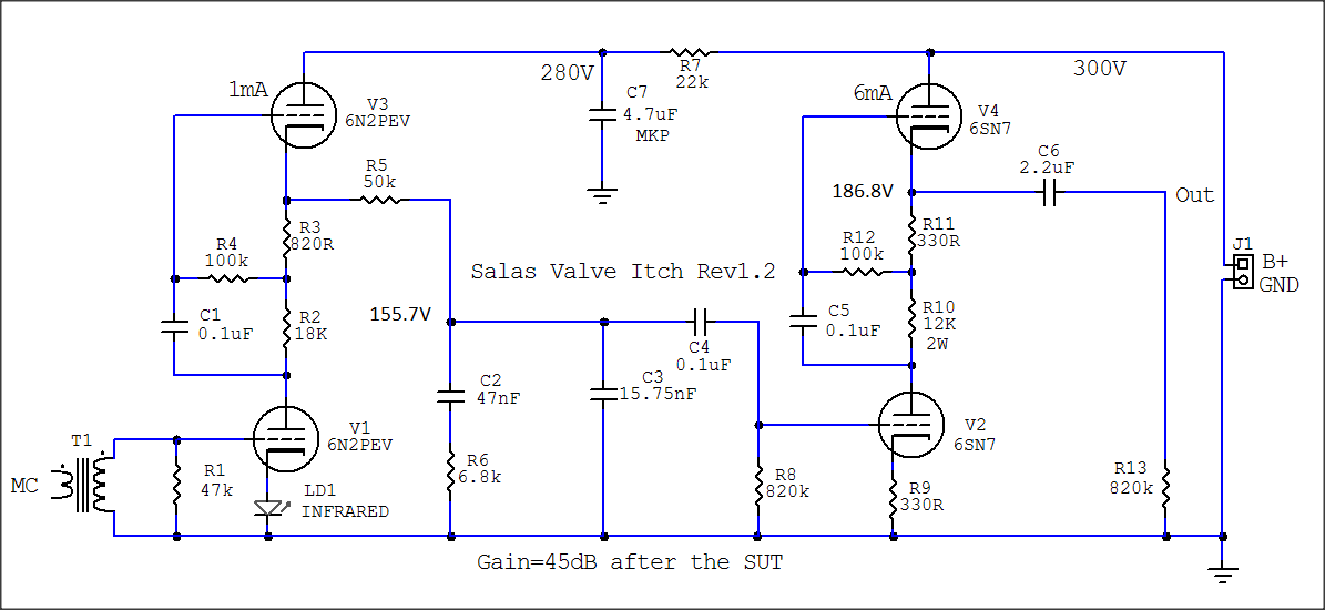

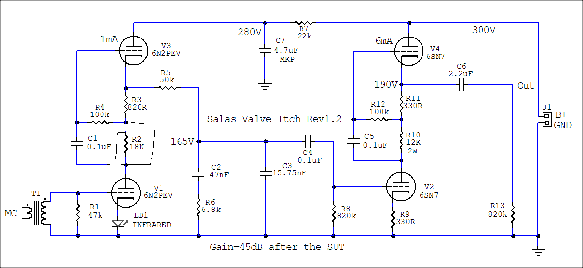

Across R2 left channel 0mA & right channel 0.88mA
Isn't the issue?
Can't be 0mA unless its an error or a tube's section is dead. Measure across R2 (18k) that shows more drop easier.
Measurement is across R2 18K, measurement 0mA left channel still swapping the E283CC, could be a cold joint?
That's a build level thing, you can only find, but check if the infrared is broken or a resistor, whatever is in that same "tree". You should see voltage drop across the series resistors when the respective tube section is conducting. Then translate to mA from Ohm's law regarding their values.
