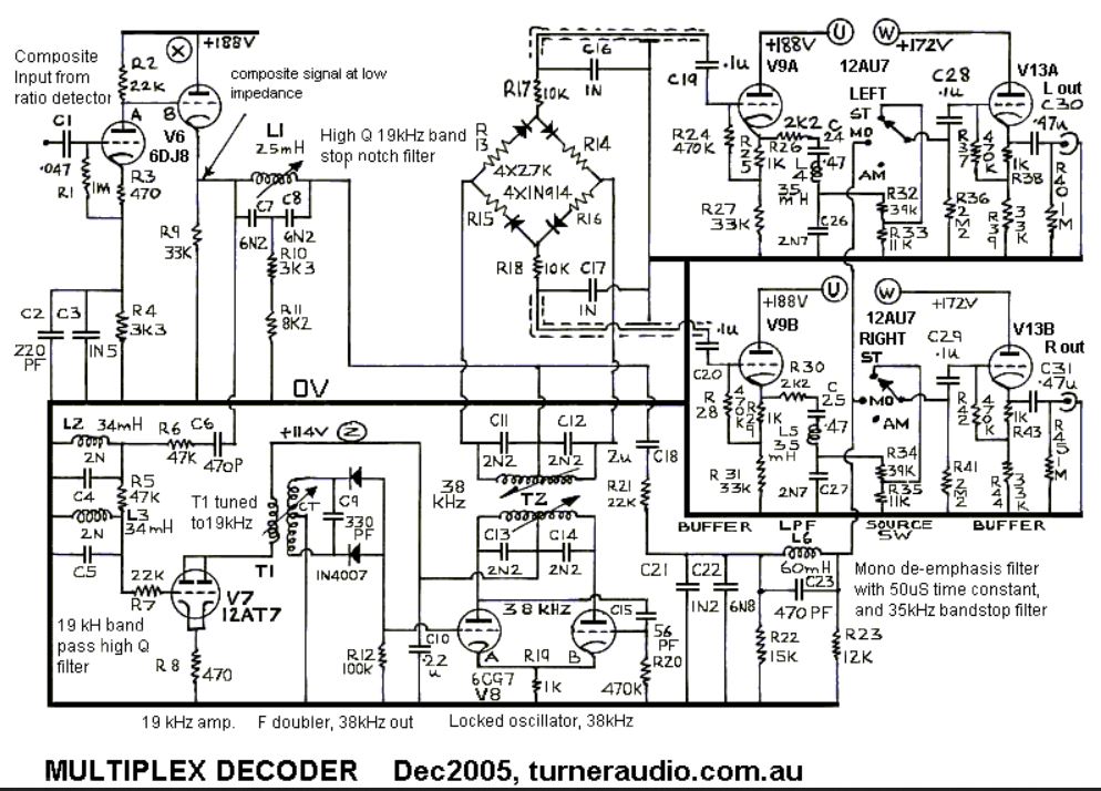

It's not a bad deal if you want something to play with. It uses the TA-7343 for the multiplex which is very common in car stereos from the 80s onward. The tuning cap they are using is kind of a waste for FM because that is typically for an AM tuner but I see they have the end sections for FM. A vacuum tube MPX would be much better and would achieve more of the fundamentals for wanting a tube tuner which is depth and full bodied sound. I would keep looking. I like that it's on a board but there are compromises. I couldn't see the schematic all that well but if it's an FET output in the MPX, that would be ok.

Yep I have the actual kit. It something to try out rather than an end project and learn from. The IF part looks sound and RF is probably wanting in the selectivity and sensitivity department. I will put some ideas on this post as I get get them. I think I saw valve MPX's on another thread.

I don't understand how L6/C23 works as a low pass filter.
It looks like a series trap - blocks the resonant frequency, passes everything else. And the resonant frequency looks way off. Stray capacitance won't be enough to make much difference at these low frequencies.
I would ( did, actually ) use an MC/LM1310 and be done with it.
