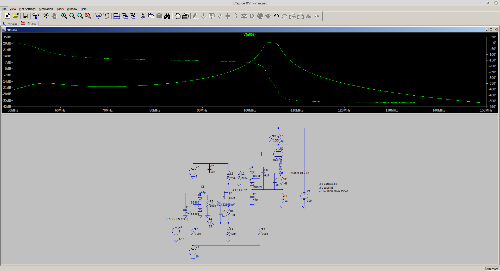

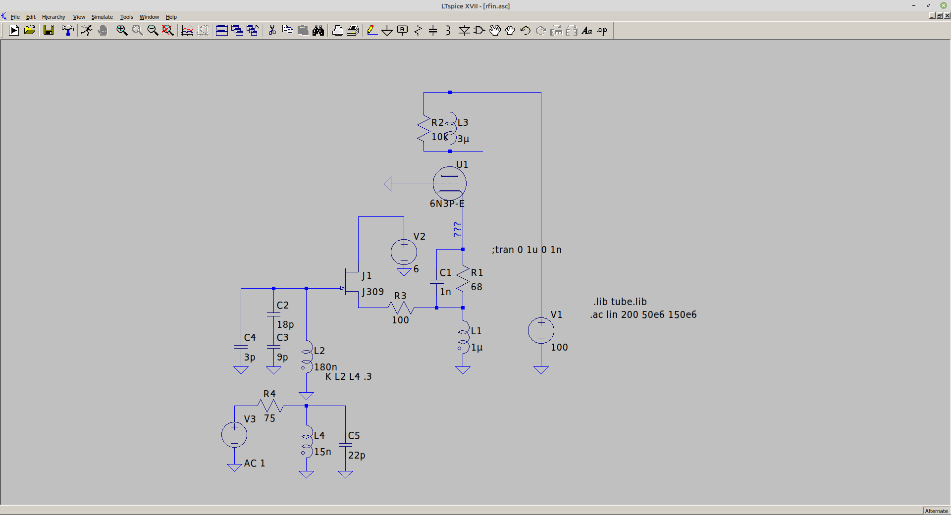

Here's a first go at the TRF input stage. C3 is back to back varicap BB809. The idea it to just bolt onto the existing 6n3p.

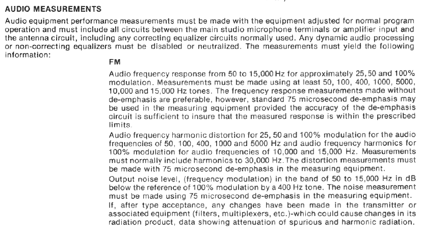

I thought that the FCC requirement for FM broadcasting was 50Hz - 15kHz +/-1dB and operation below 50Hz is permitted with 30Hz being somewhat the typical lower limit. There is no limit on LF extension but concerns about wasting modulation bandwidth on signals most stereos will not reproduce would be a concern.
There are similar requirements for stereo separation IIRC, and definitely WRT overmodulation and accidentally exceeding your allocated channel bandwidth. (200kHz)
I was briefly interested in FM broadcasting in college, and that is what I remember, but I cannot corroborate it. Google isn't always your friend apparently.

FCC needs test to 50Hz. You can do more if you want.
