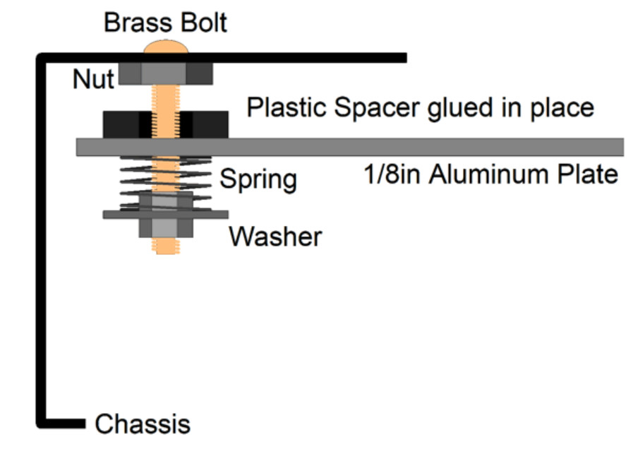

Just had a look at the tubeCAD site and the isolation idea looks really nice.
I get the feeling you would have to attach the whole PCB to the board as stringing the valve holders to the PCB / or other components with wire will act as a damper and counter the springs.
