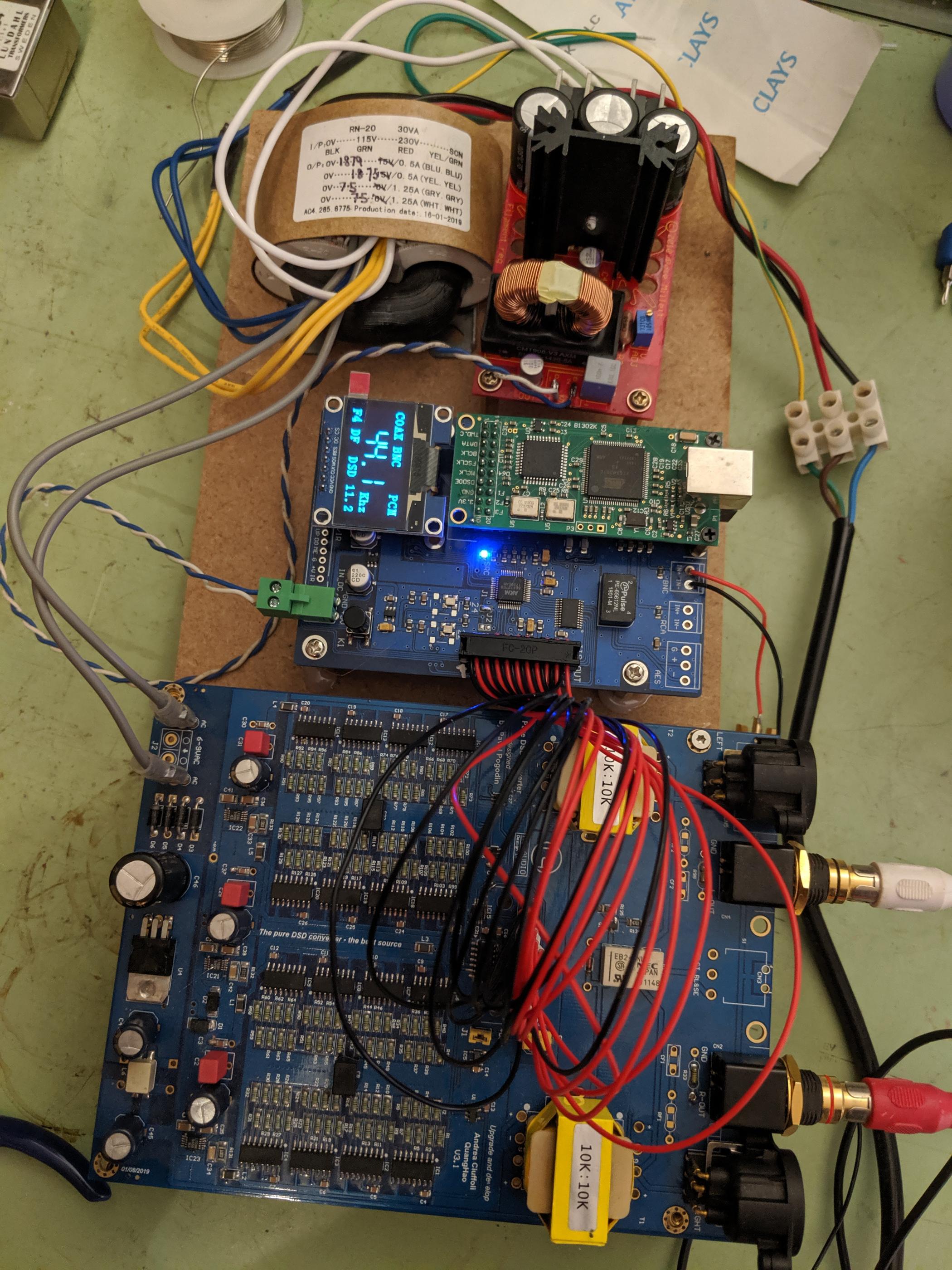

Some progres today, assembled and started testing the various power supplies.
Lower left is the Beaglebone Black (BBB) with its reclocker and power supply. I've had the BBB up and running and all seems fine.
Top left is a Neurochrome Maida regulator that will eventually provide the 300V B+. This tests out OK as per the build manual so ready to test with the full voltage at some point.
The other boards are simple regulators, one for the filaments and the other to power the reclocker and the LEDs I plan to put in the valve bases.

This remark is almost certainly unnecessary, but better safe than sorry: please keep in mind that the valve DAC needs a -300 V B- rather than a +300 V B+. That's just a matter of which side of the 300 V supply is connected to ground, but if the mounting holes on the 300 V regulator PCB make contact with what would normally be ground, they will in fact be at -300 V.
It's OK Marcel - I've got the negative 'B+' in mind and I've taken the precaution of mounting the HV regulator on plastic stand-offs. First thing though is to hook it up and check if I'm getting +300V DC out of it with a dummy load. That's complicated a little by my plan to eventually use the on board (on the DAC board) B- rectifier diodes and caps as the front end to the HV regulator - I have a seperate 'front end' I can use though.

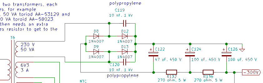

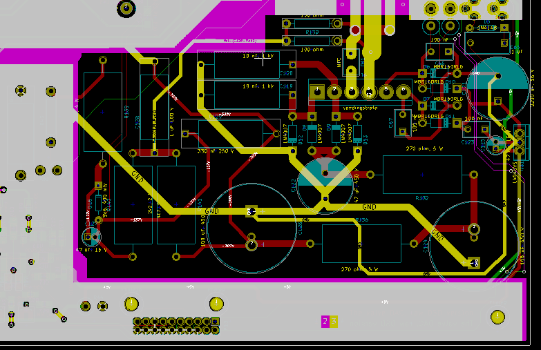

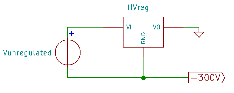

Because of the way a PCB ground track is connected, I wonder if using the DAC board's diodes and capacitors is possible. See the three figures.
The first figure is a positive series regulator connected such that it produces a negative voltage. The unregulated source at the left has neither of its pins connected to ground. I assume this schematic also applies to your regulator.
The second figure shows a fragment of the valve DAC supply schematic (DSD only variant, but the same holds for the original). C122 has its positive pin grounded. When you reverse the diodes and electrolytics, it will have its negative pin grounded, but either way, it has a side connected to ground.
This wouldn't be a big deal if the connection could easily be removed, but it is actually a yellow track in the third figure, and yellow is an inner layer. Maybe you can still drill it out, but that will be tricky.
You're right of course Marcel - I didn't think that through very well
Fortunately I have plans B, C & D to fall back on...

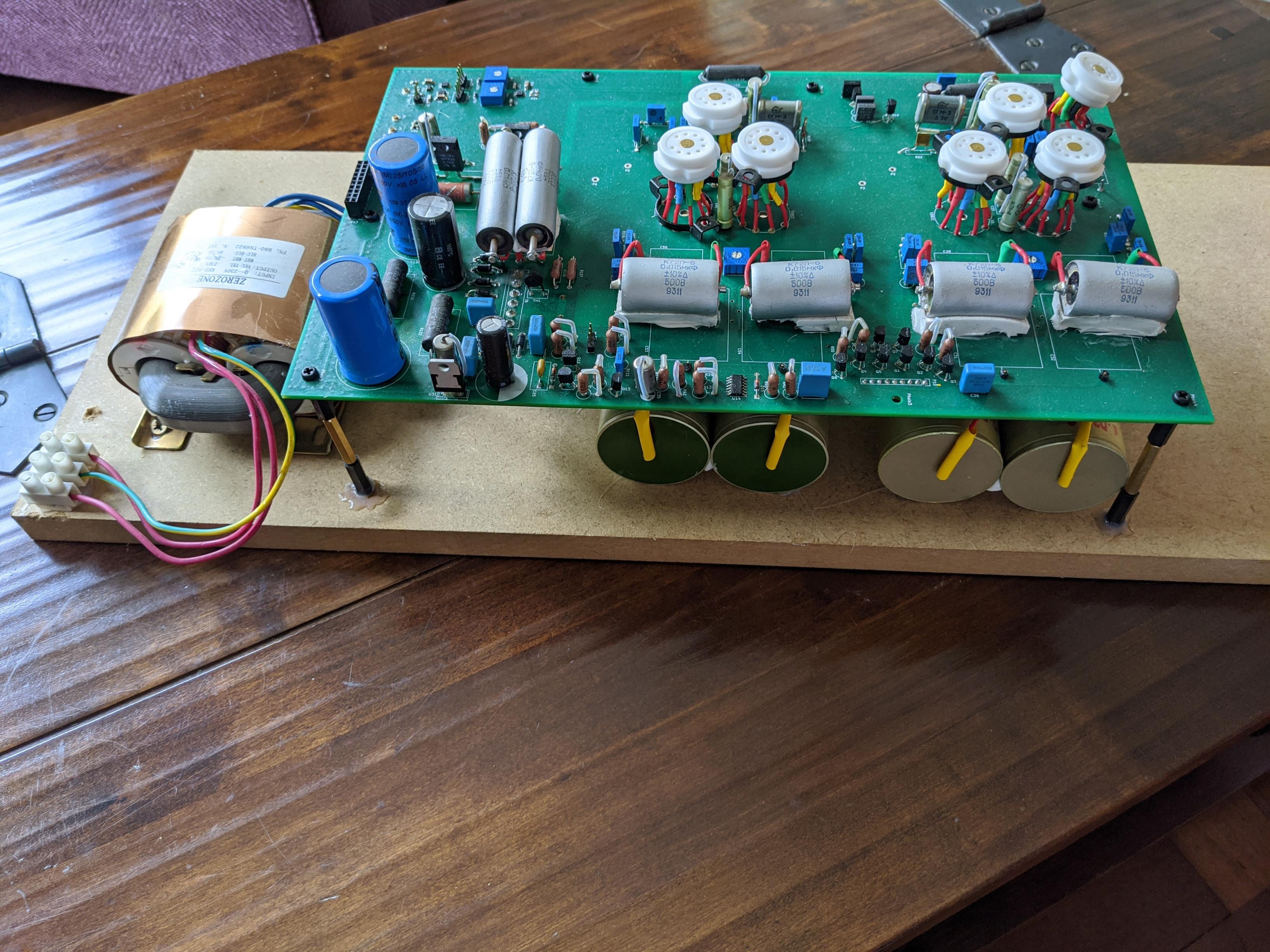

Hi Ray / Marcel / Et al,
Apologies for my hiatus. I have been stuck elsewhere in the world with only a phone and work laptop and arrived back home last week.
Whilst self isolating for the next two - three weeks, with a mountain of post to get through and some uninvited visitors (the animal kind) I am aiming to get back on top of my projects some time this week or next.
Photos of DAC from beginning of Jan before I left show where I got to, along with a DSC1 board testing out the AK4137 conversion of PCM to DSD 256, which works, and will plumb into the Valve DAC board.
Photo's NOT resized so that detail can be reviewed in my shoddy soldering and scum encrusted PCB / Desk.
Having washed / scrubbed it in Isopropanol 2-3 times, how are you supposed to get flux off without leaving that layer of grease?
I don't know, I never get it perfectly clean either. I just scratch off the big chunks when possible without damaging the solder mask, apply isopropyl alcohol with a cotton bud, try to remove it again with a dry cotton bud and hope for the best.
