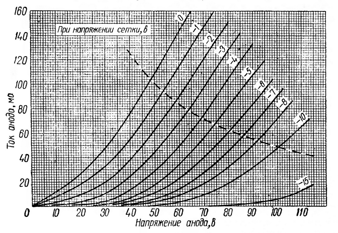

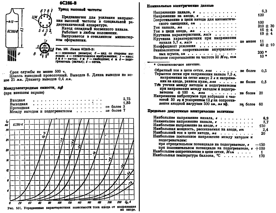

Is anybody has soviet 6S28B/6S29B tubes model?
The datasheet is found here.
Not sure you can model it, try.

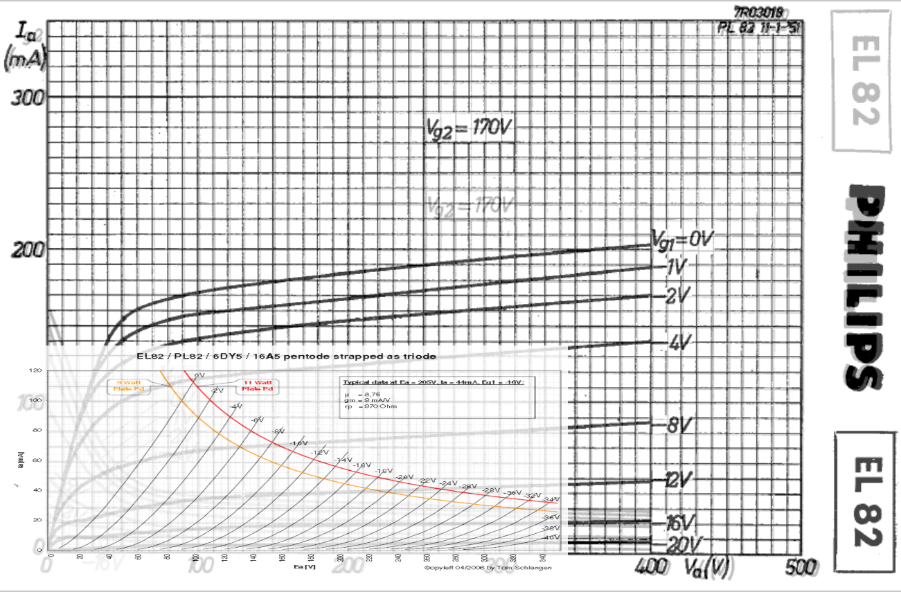

I have not found EL82 model. Does anybody have ?
If it helps, I stumbled onto triode curves, here:
http://audioportal.hi-fi.ru/attachment.php?attachmentid=5278&d=1176045289
My limited understanding is that triode curves are required to create pentode or tetrode model. That's why I posted triode curves. I do not know how to create a spice model, though.

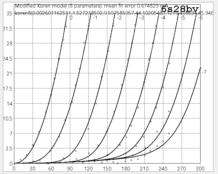

I have created 6s28BV model. Hope I got the capacitance right -see attached
* 6s28bv LTSpice model
.subckt 6s28bv P G K
Bp P K I=(0.002601162511m)*uramp(V(P,K)*ln(1.0+(1.527218592)+exp((9.597585957)+(9.597585957)*((44.10205487)+(1219.438634m)*V(G,K))*V(G,K)/sqrt((45.94661787)**2+(V(P,K)-(-7.057968898))**2)))/(9.597585957))**(2.135670747)
CGK G K 6p
CGP G P 3.1p
CPK P K 7p
.ends 6s28bv

Hey artosalo, would 6P18P be close enough to EL82 for you to use? Maybe you'll want to give it a try.
I've attached a 6P18P datasheet. Interelectrode capacitances are in there.

Also try this EL82 pentode model use pentode and triode curve as input:

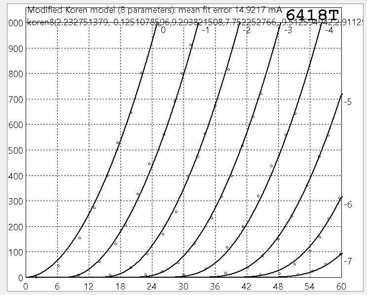

hi, I need the ltspice model of the subminiature jan 6418 valve connected to a triode.
Triode curve is included in the datasheet. Noted the capacitance values are not listed.
Code:
* 6418T LTSpice model
.subckt 6148 P G K
Bp P K I=(2.232751379m)*uramp(V(P,K)*ln(1.0+(-0.1251078596)+exp((9.293821508)+(9.293821508)*((7.752252766)+(-9.512594942m)*V(G,K))*V(G,K)/sqrt((2.911290527e-008)**2+(V(P,K)-(0.3137181941))**2)))/(9.293821508))**(1.896157386)
.ends 6418T

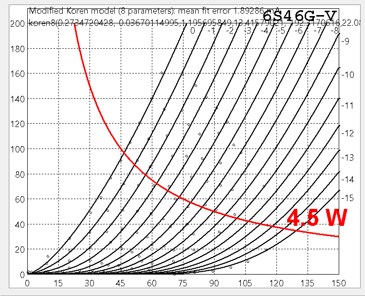

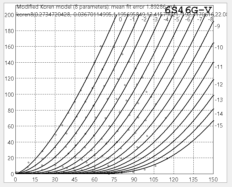

Hi I am looking for LTspice model for 6S46G-V.
Tube data on: 6С46Г-В, Tube 6С46Г-В; Rohre 6С46Г-В ID43226, Double Triode
Triode curves in attach file
Code:
* 6S46G-V LTSpice model
.subckt 6S46G-V P G K
Bp P K I=(0.2734720428m)*uramp(V(P,K)*ln(1.0+(-0.03670114995)+exp((1.195695849)+(1.195695849)*((13.41579021)+(-192.3170616m)*V(G,K))*V(G,K)/sqrt((22.0885471)**2+(V(P,K)-(4.392866787))**2)))/(1.195695849))**(1.454315615)
CGK G K 6.5p
CGP G P 2.2p
CPK P K 7.5p
.ends 6S46G-V
