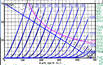

45 SPICE Models
Code:
* Created on 06/04/2024 18:02 using paint_kit.jar 3.1
* www.dmitrynizh.com/tubeparams_image.htm
* Plate Curves image file: *.jpg
* Data source link:
.SUBCKT 45 1 2 3 ; Plate Grid Cathode
+ PARAMS: CCG=4P CGP=7P CCP=3P RGI=2000
+ MU=3.654 KG1=2640 KP=46 KVB=34.88 VCT=3.125E-4 EX=1.302
* Vp_MAX=500 Ip_MAX=75 Vg_step=10 Vg_start=0 Vg_count=14
* Rp=6307.47 Vg_ac=20.92 P_max=10 Vg_qui=-189.71 Vp_qui=474.63
* X_MIN=14 Y_MIN=75 X_SIZE=348 Y_SIZE=210 FSZ_X=1260 FSZ_Y=630 XYGrid=false
* showLoadLine=y showIp=y isDHT=n isPP=n isAsymPP=n showDissipLimit=y
* showIg1=n gridLevel2=n isInputSnapped=n
* XYProjections=n harmonicPlot=n dissipPlot=n
E1 7 0 VALUE={V(1,3)/KP*LOG(1+EXP(KP*(1/MU+(VCT+V(2,3))/SQRT(KVB+V(1,3)*V(1,3)))))}
RE1 7 0 1G ; TO AVOID FLOATING NODES
G1 1 3 VALUE={(PWR(V(7),EX)+PWRS(V(7),EX))/KG1}
RCP 1 3 1G ; TO AVOID FLOATING NODES
C1 2 3 {CCG} ; CATHODE-GRID
C2 2 1 {CGP} ; GRID=PLATE
C3 1 3 {CCP} ; CATHODE-PLATE
D3 5 3 DX ; POSITIVE GRID CURRENT
R1 2 5 {RGI} ; POSITIVE GRID CURRENT
.MODEL DX D(IS=1N RS=1 CJO=10PF TT=1N)
.ENDS

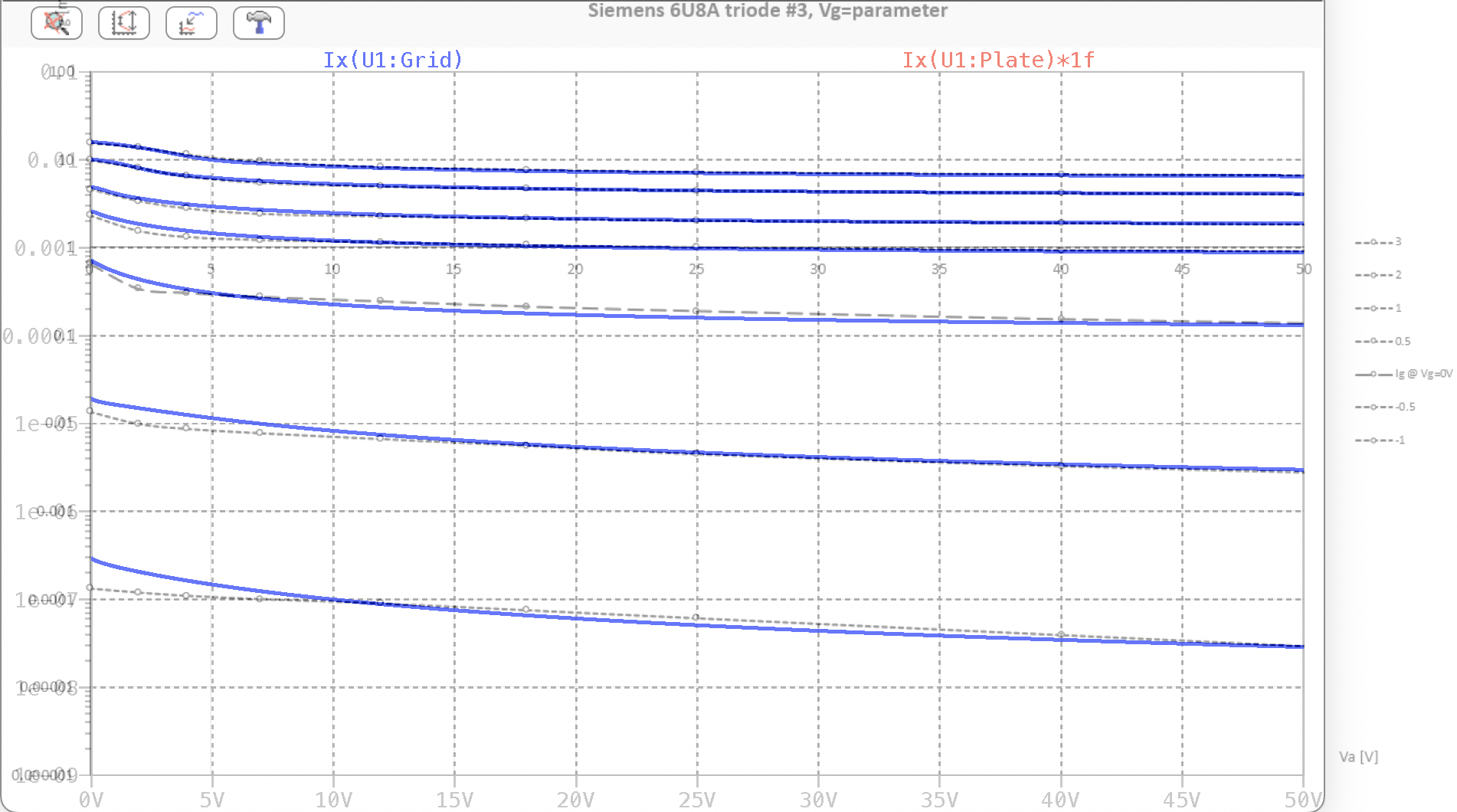

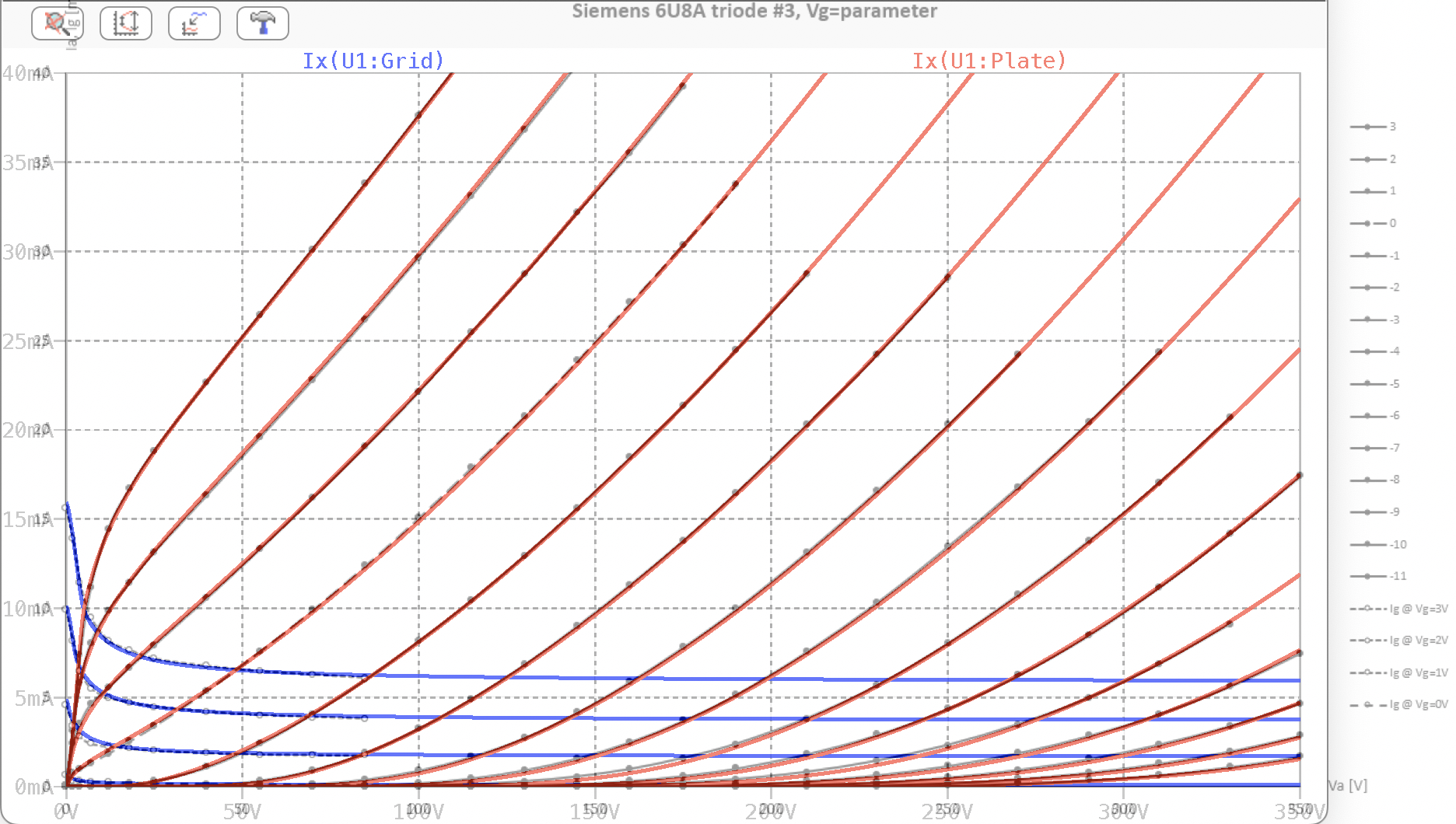

Hi all
Some weeks ago, I presented here my Siemens 6U8A Pentode model.
But the 6U8A contains also a triode - here it is, as an i6 spice model 😉.
Enjoy!
BR Adrian
PS: Be aware that most other tube manufacturer used a different construction of the 6U8A, with a very pronounced island effect for both, the pentode as well as the triode. You can easily identify this construction, as it has a large rectangular window stamped out of a sheet in the pentode construction.

Code:
*6U8A Triode LTspice model based on the generic triode model from Adrian Immler, version i6
*A version log is at the end of this file
*100h BurnIn of 10 Siemens tubes, sample selection and measurements done in Jan 2024
*Params fitted to the measured values by Adrian Immler, June 2024
*This model is accurate for Vg up to 3V.
*The fit quality is presented at adrianimmler.simplesite.com
*History's best of tube describing art (plus some new ideas) is merged to this new approach.
*@ neg. Vg, Ia accuracy is similar to Koren models, and unrivaled for remote cutoff triodes
*@ small neg. Vg, the "Anlauf" current is considered.
*@ pos. Vg, Ig and Ia accuracy is on an unrivaled level (including neg. Va range!)
*This offers new simulation possibilities like grid resistor bias, backward plate modulated stages,
*Audion radio circuits, low voltage amps, guitar distortion stages or pulsed stages.
* Triode section
* | SI=Siemens (Be aware of a quite different 6U8A construction with large rectangular window!)
* | | i6 version is identical to the i5, but measurements done with HOT anode for highest accuracy
* | | | anode (plate)
* | | | | grid
* | | | | | cathode
.subckt 6U8A#T.SIi6 A G K
+ params:
*Parameters for space charge current Is (100% assigned to Ia @ Vg < 0)
+ mu = 44 ;Determines the voltage gain @ constant Ia
+ rad = 5k1 ;Differential anode resistance, set @ Iad and Vg=0V
+ Vct = 0.6 ;Offsets the Ia-traces on the Va axis. Electrode material's contact potential
+ kp = 160 ;Mimics the island effect
+ xs = 1.5 ;Determines the curve of the Ia traces. Typically between 1.2 and 1.8
+ kIsr = 43m ;Va-indepedent part of the Is reduction when gridcurrent occurs
+ kvdg = 110 ;Va-depedent part of the Is reduction when gridcurrent occurs
*Parameters for assigning the space charge current to Ia and Ig @ Vg > 0
+ kB = 0.45 ;Describes how fast Ia drops to zero when Va approaches zero.
+ radl = 310 ;Differential resistance for the Ia emission limit @ very small Va and Vg > 0
+ tsh = 12 ;Ia transmission sharpness from 1th to 2nd Ia area. Keep between 3 and 20. Start with 20.
+ xl = 1.3 ;Exponent for the emission limit
*Parameters of the grid-cathode vacuum diode
+ kg = 610 ;Inverse scaling factor for the Va independent part of Ig (caution - interacts with xg!)
+ Vctg = 0.02 ;Offsets the log Ig-traces on the Vg axis. Electrode material's contact potential
+ xg = 1.15 ;Determines the curve of the Ig slope versus (positive) Vg and Va >> 0
+ VT = 0.102 ;Log(Ig) slope @ Vg<0. VT=k/q*Tk (cathodes absolute temp, typically 1150K)
+ rTr = 0.9 ;ratio of VT for Igr. Typically 0.8
+ kVT = 5m ;Va dependant koeff. of VT
+ gft1 = 0.02 ;reduces the steering voltage around Vg=-Vg0, for finetuning purposes
+ gft1a= 0.25 ;reduces the steering voltage around Vg=-Vg0. Effect decreases with 1/(1+kB*Va)
+ gft2 = 1 ;finetunes the Igr drop @ incrasing Va and around Vg=-Vg0
*Parameters for the caps
+ cag = 1p8 ;From datasheet
+ cak = 0p35 ;From datasheet
+ cgk = 2p5 ;From datasheet
*special purpose parameters
+ os = 1 ;Overall scaling factor, if a user wishes to simulate manufacturing tolerances
+ murc = 10 ;Mu of the remote cutoff triode
+ ksrc = 10G ;Inverse Iarc gain factor for the remote cuttoff triode
+ kprc = 1k ;Mimics the island effect for the remote cotoff triode
+ Vbatt = 0 ;heater battery voltage for direct heated battery triodes
+ Vdrmax = 2 ;max voltage of internal Vg drop, for convergence improvements
*Calculated parameters
+ Iad = {100/rad} ;Ia where the anode a.c. resistance is set according to rad.
+ ks = {pow(mu/(rad*xs*Iad**(1-1/xs)),-xs)} ;Reduces the unwished xs influence to the Ia slope
+ ksnom = {pow(mu/(rad*1.5*Iad**(1-1/1.5)),-1.5)} ;Sub-equation for calculating Vg0
+ Vg0 = {Vct + (Iad*ks)**(1/xs) - (Iad*ksnom)**(2/3)} ;Reduces the xs influence to Vct.
+ kl = {pow(1/(radl*xl*Ild**(1-1/xl)),-xl)} ;Reduces the xl influence to the Ia slope @ small Va
+ Ild = {sqrt(radl)*1m} ;Current where the Il a.c. resistance is set according to radl.
*Space charge current model
Rak A K 100G ;avoids "floating net" errors
Bft ft 0 V=1/(1+pow(2*abs(v(G,Ki)+Vg0),3)) ;an auxiliary voltage to finetune the triode around Vg=-Vg0
Bggi GGi 0 V=(v(Gi,Ki)+Vg0)*(1/(1+kIsr*max(0, v(G,Ki)+Vg0))) - gft1*v(ft) - gft1a*v(ft)/(1+kB*v(Ahc)) ;Effective internal grid voltage.
Bahc Ahc 0 V=uramp(v(A,Ki)) ;Anode voltage, hard cut to zero @ neg. value
Bst St 0 V=uramp(max(v(GGi)+v(A,Ki)/(mu), v(A,Ki)/kp*ln(1+exp(kp*(1/mu+v(GGi)/(1+v(Ahc)))))));Steering volt.
Bs Ai Ki I=os/ks*pow(v(St),xs) ;Langmuir-Childs law for the space charge current Is
*Bstrc Strc 0 V=uramp(max(v(GGi)+v(Ahc)/(murc), v(Ahc)/kprc*ln(1+exp(kprc*(1/murc+v(GGi)/(1+v(Ahc)))))));FOR REMOTE CUTOFF TUBES ONLY
*Bsrc Ai Ki I=os/ksrc*pow(v(Strc),xs) ;FOR REMOTE CUTOFF TUBES ONLY
*Anode current limit @ small Va
.func smin(z,y,n) {pow(pow(z+1f, -n)+pow(y+1f, -n), -1/n)} ;Min-function with smooth trans.
.func ssmin(z,y,n) {min(min(z,y), smin(z*1.003,y*1.003,n))};smin-function which suppresses small residual differencies
Ra A Ai 1
Bgl Gi A I=uramp(i(Ra)-ssmin(1/kl*pow(v(Ahc),xl),i(Ra),tsh)) ;Ia emission limit
*Grid model
Rgk G K 10G ;avoids "floating net" errors
Bvdg G Gi I=1/kvdg*pow(v(G,Gi),1.5) ;Reduces the internal effective grid voltage when Ig rises
Bcoh G Gi I=pow(uramp(v(G,Gi)-Vdrmax),2) ;A convergence help which softly limits the internal Vg voltage drop.
Rgip G Gi 1G ;avoids some warnings
.func fVT() {VT*exp(-kVT*sqrt(v(A,Ki)))}
.func Ivd(Vvd, kvd, xvd, VTvd) {if(Vvd < 3, 1/kvd*pow(VTvd*xvd*ln(1+exp(Vvd/VTvd/xvd)),xvd), 1/kvd*pow(Vvd, xvd))} ;Vacuum diode function
Bgvd G Ki I=Ivd(v(G,Ki) + Vctg + min(0,v(A,Ki)/mu), kg/os, xg, fVT()) ;limits the internal Vg for convergence reasons
Bstn Stn 0 V=v(GGi)+min(0,v(A,Ki))/mu ;special steering voltage, sensitive to negative Anodevoltages only
Bgr Gi Ai I= ivd(v(Stn),ks/os, xs, rTr*fVT())/(1+(kB+v(ft)*gft2)*v(Ahc));Is reflection to grid when Va approaches zero
*Bgr Gi Ai I=(ivd(v(Stn),ks/os, xs, rTr*fVT())+os/ksrc*pow(v(GGi),xs))/(1+(kB+v(ft)*gft2)*v(Ahc));FOR REMOTE CUTOFF TUBES ONLY
Bs0 Ai Ki I=uramp(ivd(v(Stn),ks/os, xs, rTr*fVT()) - os/ks*pow(v(Stn),xs))
Bbatt Ki K V=Vbatt/2 ;for battery heated triodes; Offsets the average cathode potential to the half heater battery voltage
*Caps
C1 A G {cag}
C2 A K {cak}
C3 G K {cgk}
.ends
*Version log
*i1 :Initial version
*i2 :Pin order changed to the more common order A G K (Thanks to Markus Gyger for his tip)
*i3 :bugfix of the Ivd-function: now also usable for larger Vvd
*i4: Rgi replaced by a virtual vacuum diode (better convergence). ft1 deleted (no longer needed)
;2 new prarams for Ig finetuning @ Va and Vg near zero. New overall skaling factor os for aging etc.
*i5: improved convergence performance. PosVg/NegVa area now correct. Also accurate now for remote cutoff triodes!
*i6: identical to the i5, but tubes measured with hot anode (Pa=0.7*Pmax) for highest accuracy

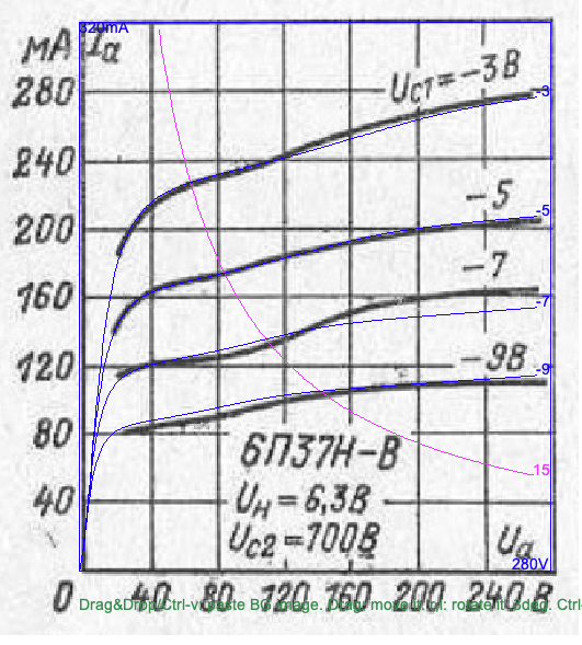

Here's a model for the 6P37N-V (6П37Н-В) Russian power beam tetrode nuvistor:
Code:
**** SCREENSHOT 2024_06_16 AT 2 ******************************************
* Created on 06/16/2024 15:08 using paint_kip.jar
* Plate Curves image file: /Users/mark/Desktop/Screenshot 2024-06-16 at 2.22.23 PM.png
* Data source link: https://lampes-et-tubes.info/rt/6P37N-V.pdf
.SUBCKT SCREENSHOT 2024_06_16 AT 2 P G2 G K ; LTSpice tetrode.asy pinout
* .SUBCKT SCREENSHOT 2024_06_16 AT 2 P G K G2 ; Koren Pentode Pspice pinout
+ PARAMS: MU=19.75 KG1=3731.2 KP=8.656 KVB=0.5 VCT=0.272 EX=2.563 KG2=1029 KNEE=12.74 KVC=2.57
+ KLAM=5.319E-5 KLAMG=1.68E-4 KD=0.003648 KC=0.1008 KR1=0.003744 KR2=0.04288 KVBG=0.009 KB1=1.8 KB2=3.4 KB3=1.84 KB4=1 KVBGI=1.597 KNK=-0.05547 KNG=0.00426
+ CCG=28P CGP=5.5P CCP=0.4P RGI=2000.0
* Vp_MAX=280 Ip_MAX=320 Vg_step=2 Vg_start=-3 Vg_count=4
* X_MIN=86 Y_MIN=21 X_SIZE=430 Y_SIZE=501 FSZ_X=1639 FSZ_Y=1187 XYGrid=false
* Rp=1400 Vg_ac=20 P_max=15 Vg_qui=-6 Vp_qui=300
* showLoadLine=n showIp=y isDHP=n isPP=n isAsymPP=n isUL=n showDissipLimit=y
* showIg1=n isInputSnapped=y addLocalNFB=n
* XYProjections=n harmonicPlot=y dissipPlot=n
* UL=0.43 EG2=100 gridLevel2=n addKink=n isTanhKnee=n advSigmoid=y
RE1 7 0 1G ; DUMMY SO NODE 7 HAS 2 CONNECTIONS
E1 7 0 VALUE= ; E1 BREAKS UP LONG EQUATION FOR G1.
+{V(G2,K)/KP*LOG(1+EXP((1/MU+(VCT+V(G,K))/SQRT(KVB+V(G2,K)*V(G2,K)))*KP))}
RE2 6 0 1G ; DUMMY SO NODE 6 HAS 2 CONNECTIONS
E2 6 0 VALUE={(PWR(V(7),EX)+PWRS(V(7),EX))} ; Kg1 times KIT current
E4 8 0 VALUE={V(P,K)/KNEE/(KVBGI+V(6)*KVBG)}
E5 81 0 VALUE={PWR(V(8),KB1)}
E6 82 0 VALUE={PWR(V(8),KB2)}
E7 83 0 VALUE={PWR(V(8),KB3)}
E8 9 0 VALUE={PWR(1-EXP(-V(81)*(KC+KR1*V(82))/(KD+KR2*V(83))),KB4)*1.5708}
RE4 8 0 1
RE5 81 0 1
RE6 82 0 1
RE7 83 0 1
RE8 9 0 1
G1 P K VALUE={V(6)/KG1*V(9)*(1+KLAMG*V(P,K))+KLAM*V(P,K)}
G2 G2 K VALUE={V(6)/KG2*(KVC-V(9))/(1+KLAMG*V(P,K))}
RCP P K 1G ; FOR CONVERGENCE
C1 K G {CCG} ; CATHODE-GRID 1
C2 G P {CGP} ; GRID 1-PLATE
C3 K P {CCP} ; CATHODE-PLATE
R1 G 5 {RGI} ; FOR GRID CURRENT
D3 5 K DX ; FOR GRID CURRENT }
.ENDS
* The following triode model is derived from pentode model, see above.
* In the triode model, all spice parameters come directly from the pentode model, except for Kg1,
* which for triode-strapped pentodes is derived from pentode's Kg1, Kg2 and Kvc as
* 4Kg1Kg2 / ((2Kvc-Pi)(2Kg1+PiKg2))
* Created on 06/16/2024 15:08 using paint_kit.jar 4.7
.SUBCKT TRIODE_SCREENSHOT 2024_06_16 AT 2 1 2 3 ; Plate Grid Cathode
+ PARAMS: CCG=28P CGP=5.5P CCP=0.4P RGI=2000
+ MU=19.75 KG1=718.55 KP=8.656 KVB=0.5 VCT=0.272 EX=2.563
* showLoadLine=n showIp=y isDHT=n isPP=n isAsymPP=n showDissipLimit=y
* showIg1=n gridLevel2=n isInputSnapped=y
.ENDS

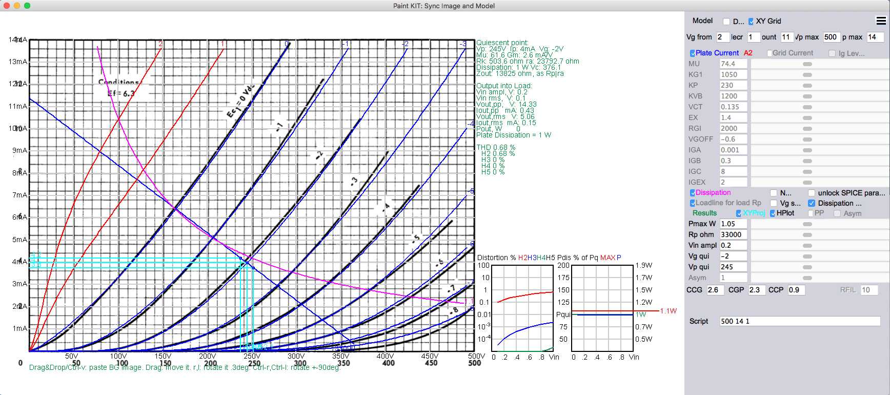

Hi 🙂
CK6247WA Raytheon model.
Code:
* Created on 06/20/2024 19:22 using paint_kit.jar 3.1
* Plate Curves image file: /Users/zoran/Desktop/Model_Paint_Tools/Graph/
* Data source link:
.SUBCKT CK6247WA 1 2 3 ; Plate Grid Cathode
+ PARAMS: CCG=2.6P CGP=2.3P CCP=0.9P RGI=2000
+ MU=74.4 KG1=1050 KP=230 KVB=1200 VCT=0.135 EX=1.4
* Vp_MAX=500 Ip_MAX=14 Vg_step=1 Vg_start=2 Vg_count=11
* Rp=33000 Vg_ac=0.2 P_max=1.05 Vg_qui=-2 Vp_qui=245
* X_MIN=58 Y_MIN=56 X_SIZE=868 Y_SIZE=607 FSZ_X=1736 FSZ_Y=770 XYGrid=true
* XYProjections=y harmonicPlot=y dissipPlot=y
.ENDS CK6247WA
For biasing with battery of 1.5V (-Ug)
CK6247 for 25mV p-p input @ Riv for 1.9V p-p output. Quite a bit higher output impedance, some sub-miniature tube buffer can help... 🙂
Also could be used as MM 1st and 2nd stage with same settings...
In the datas noted that CK6247 is very low microfonic tube, high vibration resistance...
