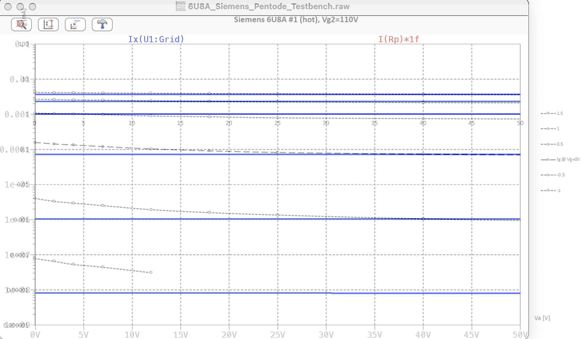

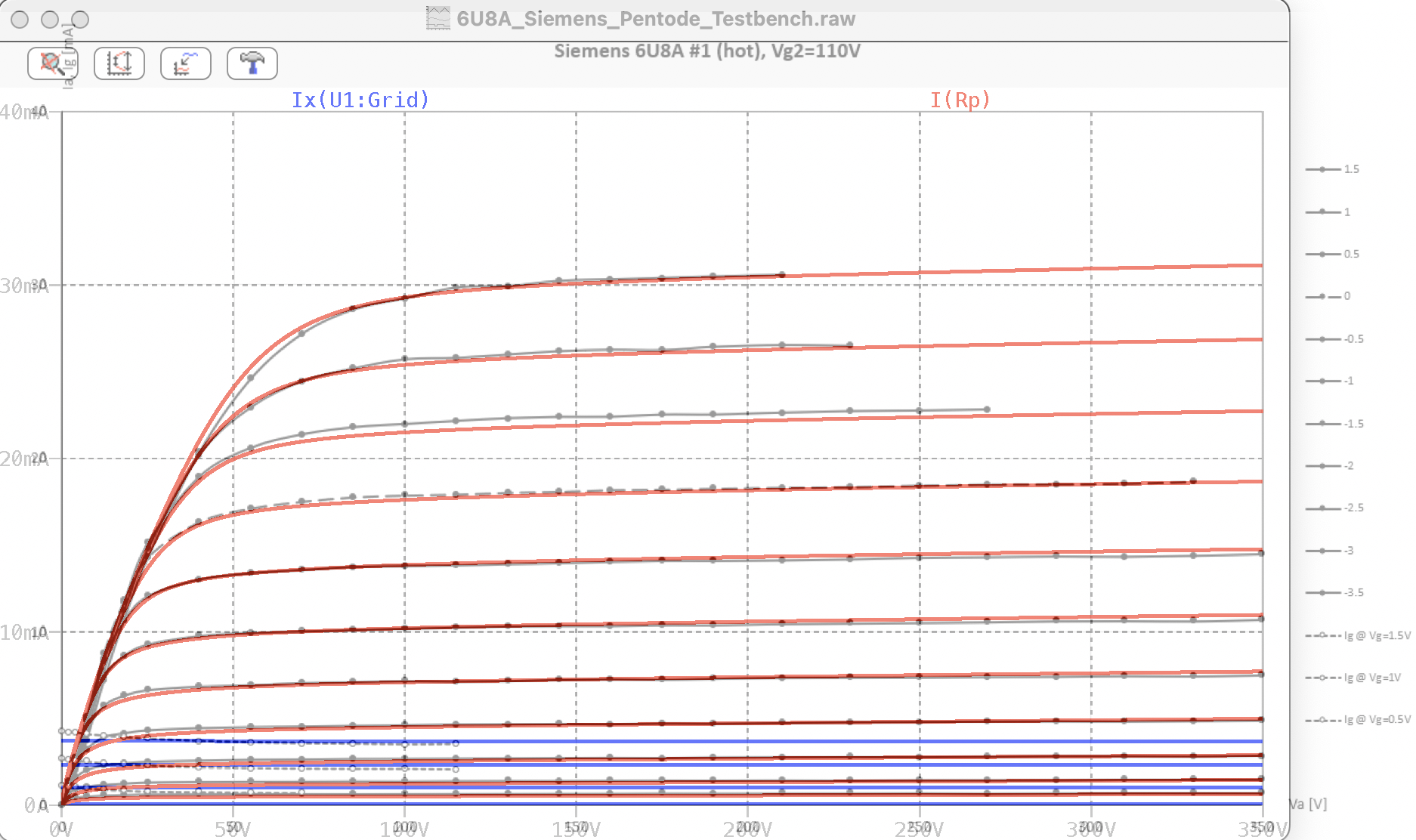

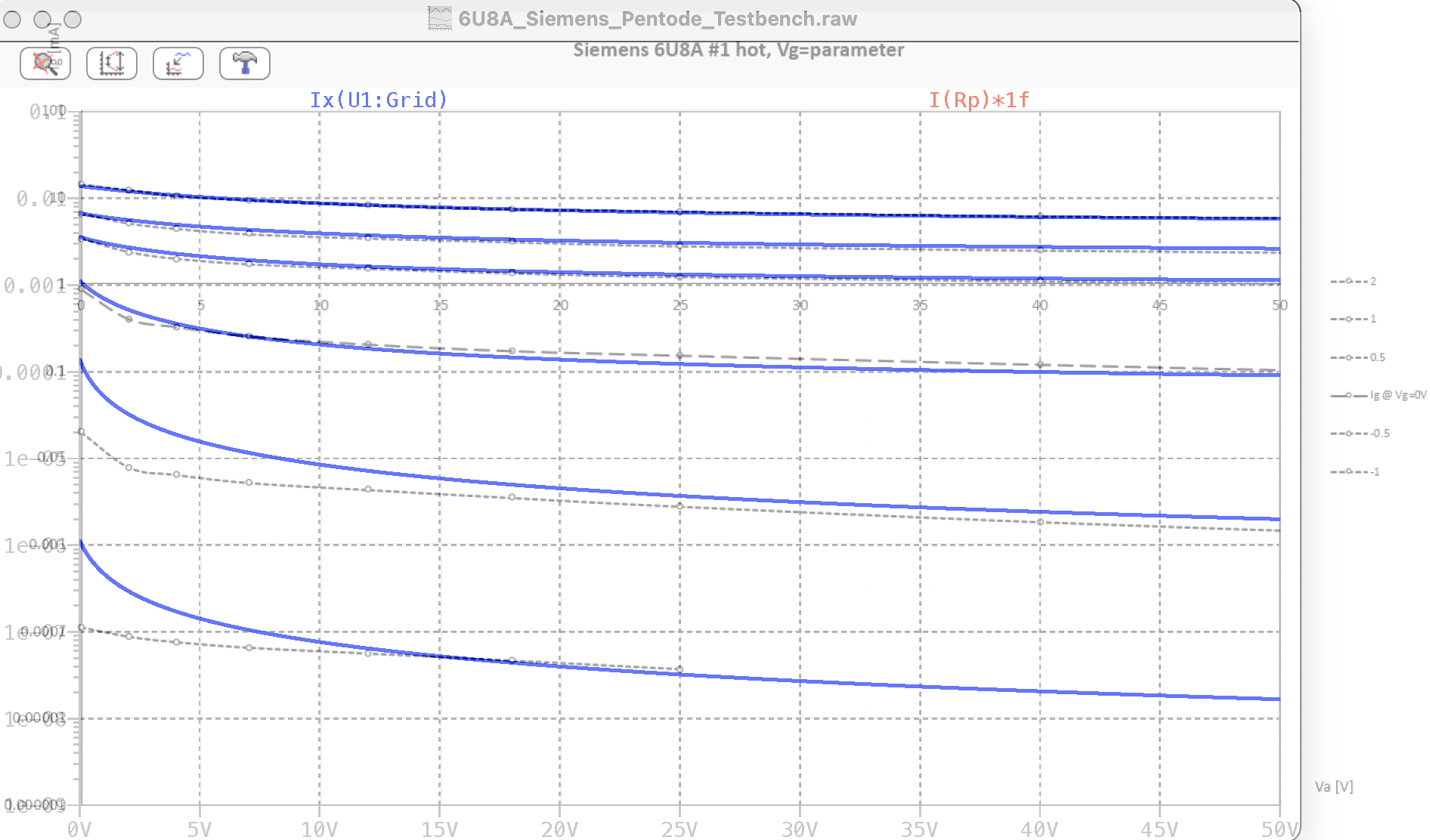

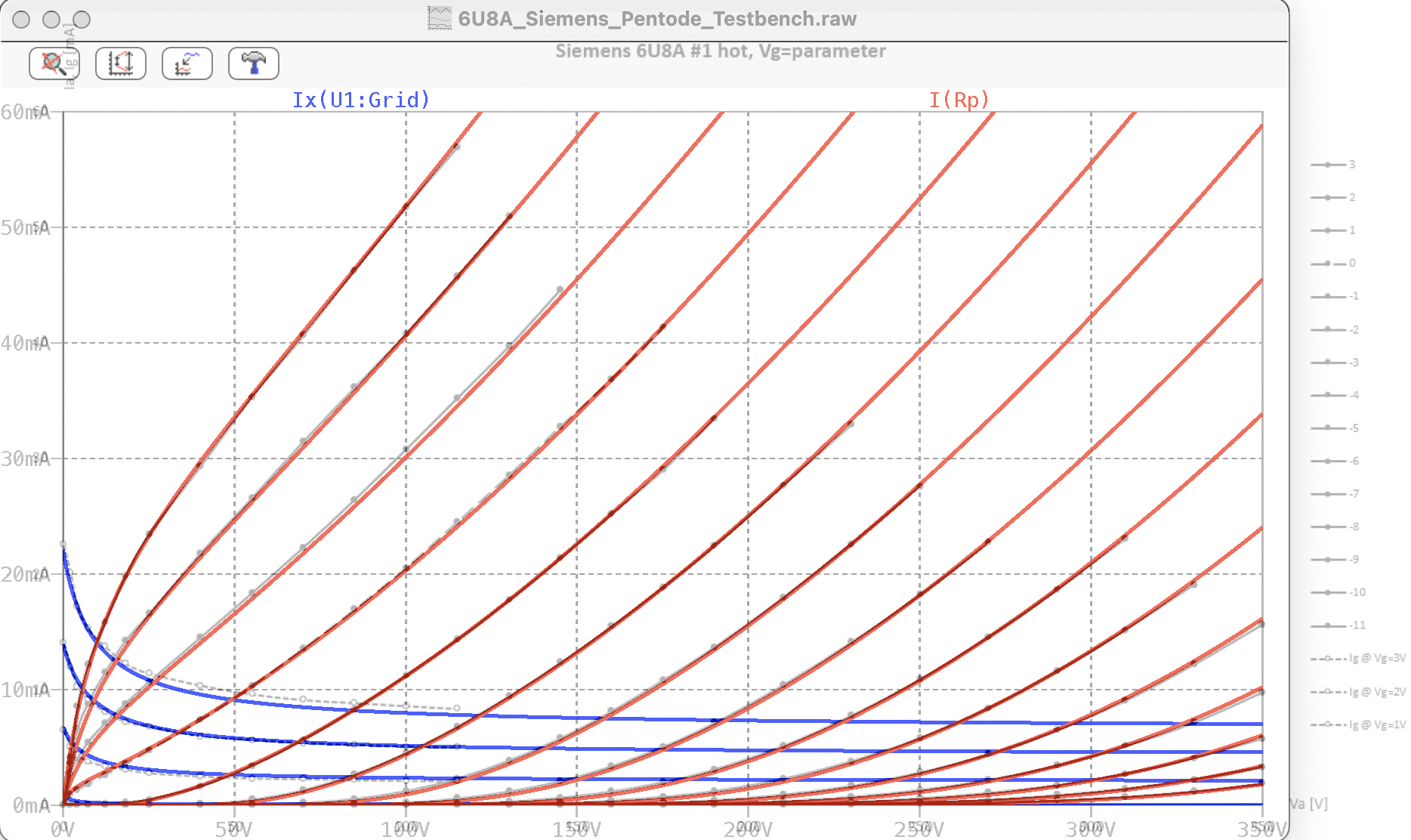

Hi all
The last half year, I worked on updating my pentode model to i6 level, means that:
The first tube I fitted to this new generic model is the Siemens 6U8A pentode.
Enjoy!
BR Adrian
- it is equal to my i6 triode model when g2 and plate is connected together
- it has an enhanced convergence performance compared to earlier pentode versions of mine
- the plate emission limit is now finetuned for both modes, triode-connected as well as pentode-connected
Enjoy!
BR Adrian
