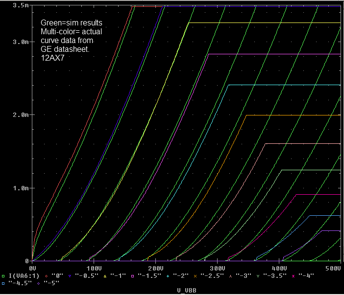

I already do most of the procedure you outlined, but I was most curious how you overlayed the two graphs. Now we know, thanks.
One of the reasons I have extracted detailed xy data from the 12AX7 curves is so I can import this into PSpice Probe and view the manufacturer curves right along with the simulator output. This is the ultimate comparison imo.
The next step for me will be to use PSpice Optimizer which will hopefully optimize the tube model parameters for me. In this sense, I'll be able to create models all from within the PSpice native environment, all I need is detailed curve data and good skeleton paramaterized models, such as Koren's, Rydel's, and Ayumi's.

P.S. I look at the 12AX7 graph you attach, this is a nice comparing job but the model you have is a quite off the GE datasheet curves ...

What I posted was a comparison between the SPICE model simulation results, and the datasheet curves. Isn't that how we know if our tube SPICE model is close enough for practical use?
Perhaps I missed your point?

In PSpice Probe, there is an "append" button that allows me to merge the two "dat" files, and as such, I can plot traces from either dat file in the same window. Before I can append a dat file, I have to import the csv data into probe, and it converts the data to the native probe data format in a "dat" file.
So I run the simulation as normal, and I get the sim results. Then I append my datasheet xy data (in dat format) to the existing sim results, and voila, instant comparison!
Yes, I know. As I said, this is a 12AX7 model taken from the EXCEM publication. It is not the best fit, but serves to demonstrate what I am explaining.P.S. I look at the 12AX7 graph you attach, this is a nice comparing job but the model you have is a quite off the GE datasheet curves ...

I got many news tonight,That's great news.

I select all the digitized curves and highlight them to be able to compare them easily to the SiMetrix generated curves from the model I talk about yesterday on this thread preceding page. This is a much faster way to work than "superposing" the SiMetrix graph on the company graph because there is no need to measure the number of pixels of those graphs and adjusting the window size to fit them, the results are very close ... 😉
