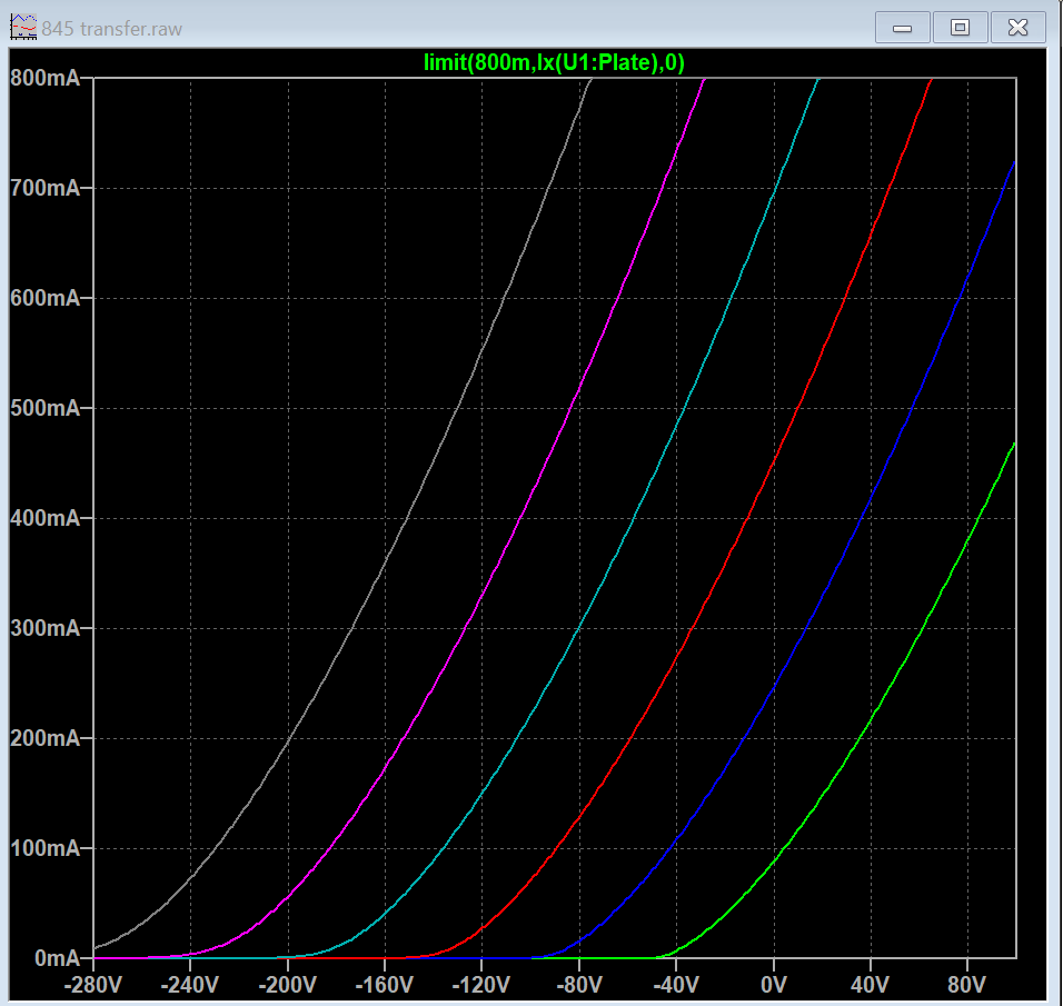

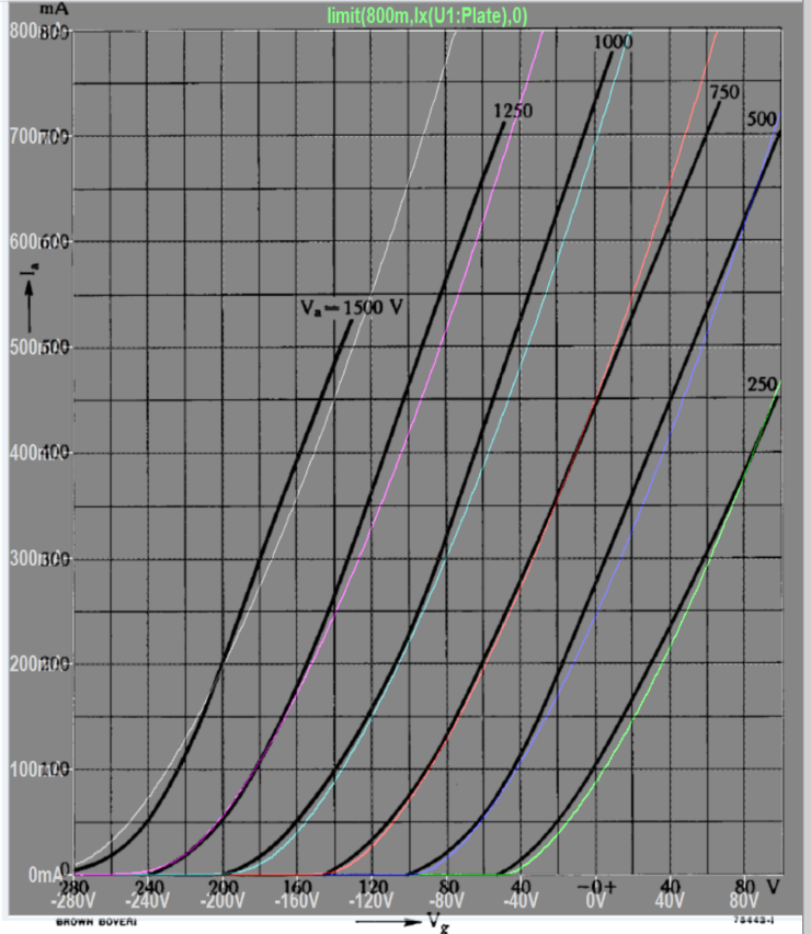

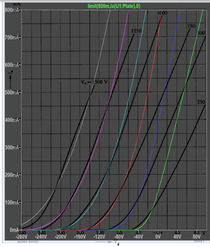

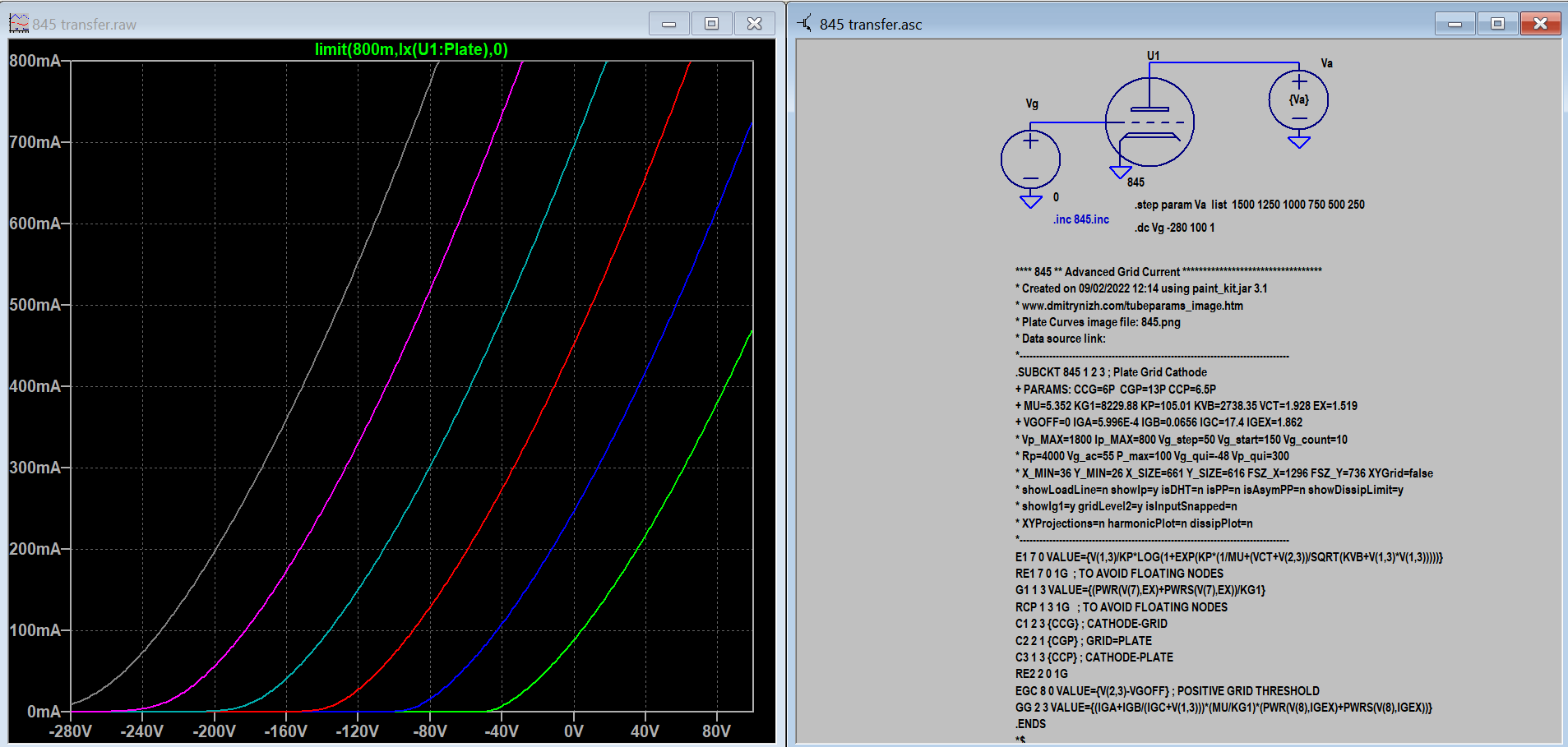

Hi, welcome, see attached transfer curve plot when compared to the curve you posted. Here is 845 model I painted:
Code:
**** 845 ** Advanced Grid Current **********************************
* Created on 09/02/2022 12:14 using paint_kit.jar 3.1
* www.dmitrynizh.com/tubeparams_image.htm
* Plate Curves image file: 845.png
* Data source link:
.SUBCKT 845 1 2 3 ; Plate Grid Cathode
+ PARAMS: CCG=6P  CGP=13P CCP=6.5P
+ MU=5.352 KG1=8229.88 KP=105.01 KVB=2738.35 VCT=1.928 EX=1.519
+ VGOFF=0 IGA=5.996E-4 IGB=0.0656 IGC=17.4 IGEX=1.862
* Vp_MAX=1800 Ip_MAX=800 Vg_step=50 Vg_start=150 Vg_count=10
* Rp=4000 Vg_ac=55 P_max=100 Vg_qui=-48 Vp_qui=300
* X_MIN=36 Y_MIN=26 X_SIZE=661 Y_SIZE=616 FSZ_X=1296 FSZ_Y=736 XYGrid=false
* showLoadLine=n showIp=y isDHT=n isPP=n isAsymPP=n showDissipLimit=y
* showIg1=y gridLevel2=y isInputSnapped=n
* XYProjections=n harmonicPlot=n dissipPlot=n
E1 7 0 VALUE={V(1,3)/KP*LOG(1+EXP(KP*(1/MU+(VCT+V(2,3))/SQRT(KVB+V(1,3)*V(1,3)))))}
RE1 7 0 1G  ; TO AVOID FLOATING NODES
G1 1 3 VALUE={(PWR(V(7),EX)+PWRS(V(7),EX))/KG1}
RCP 1 3 1G   ; TO AVOID FLOATING NODES
C1 2 3 {CCG} ; CATHODE-GRID
C2 2 1 {CGP} ; GRID=PLATE
C3 1 3 {CCP} ; CATHODE-PLATE
RE2 2 0 1G
EGC 8 0 VALUE={V(2,3)-VGOFF} ; POSITIVE GRID THRESHOLD
GG 2 3 VALUE={(IGA+IGB/(IGC+V(1,3)))*(MU/KG1)*(PWR(V(8),IGEX)+PWRS(V(8),IGEX))}
.ENDS

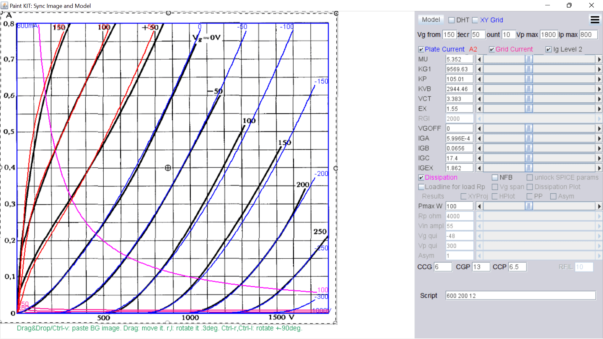

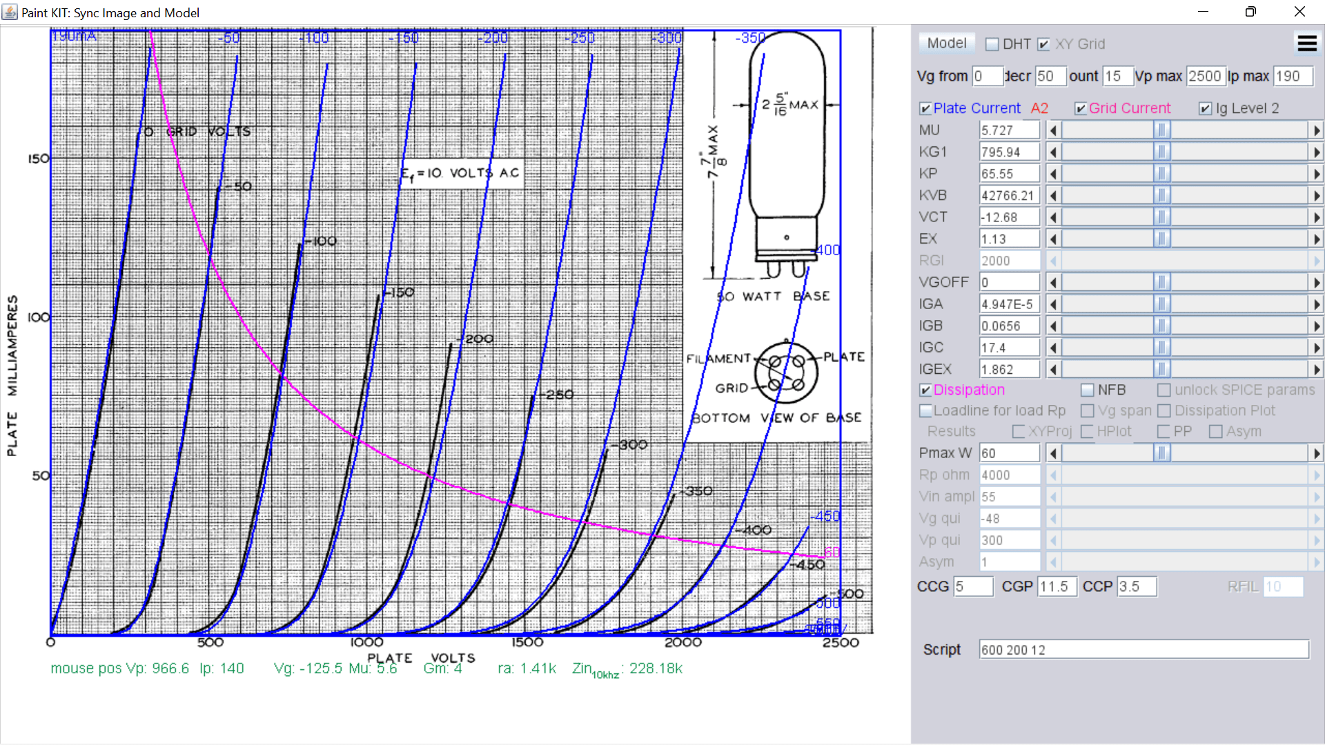

This is 845 Amprex model, which is close to previous model T110-1:

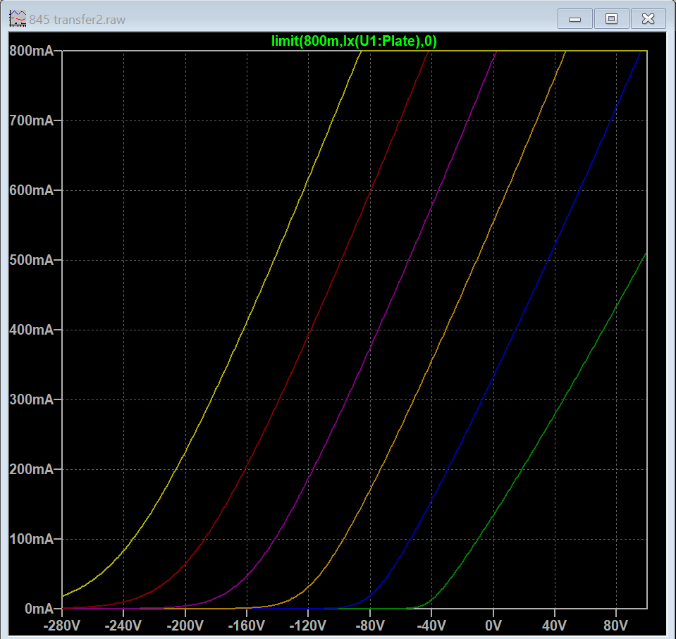

Thanks very much, this new data set gives much better fit to the Amperex 845 data.

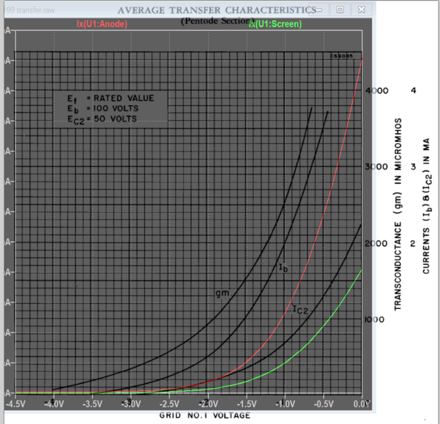

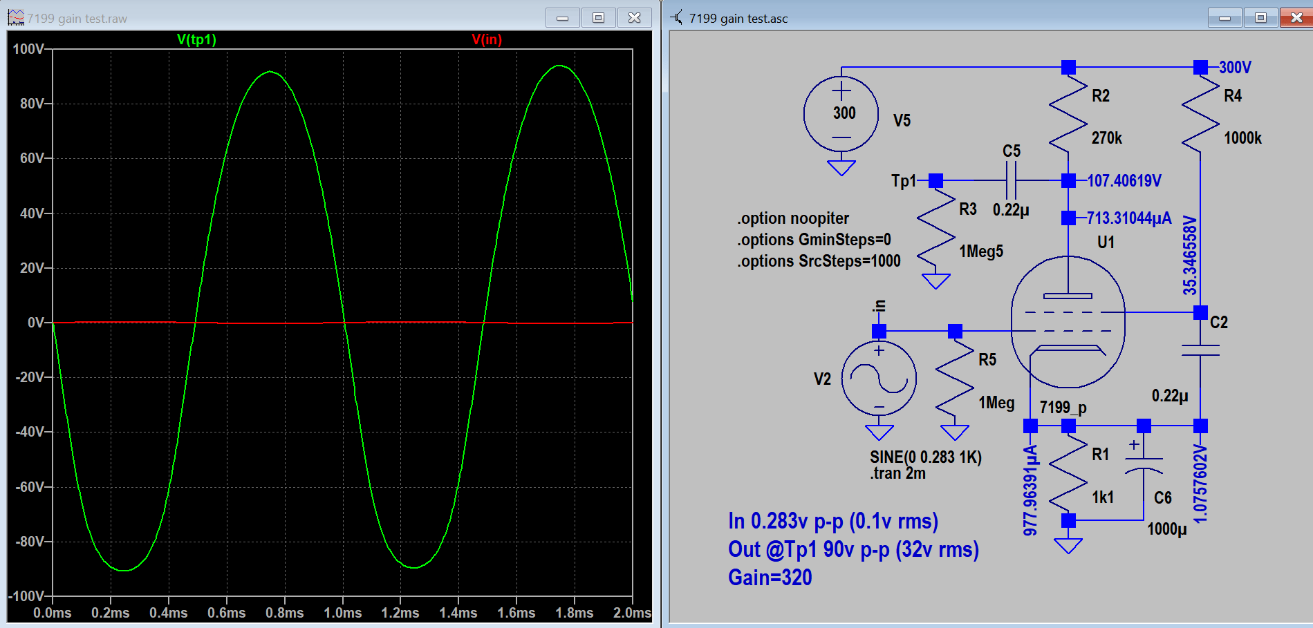

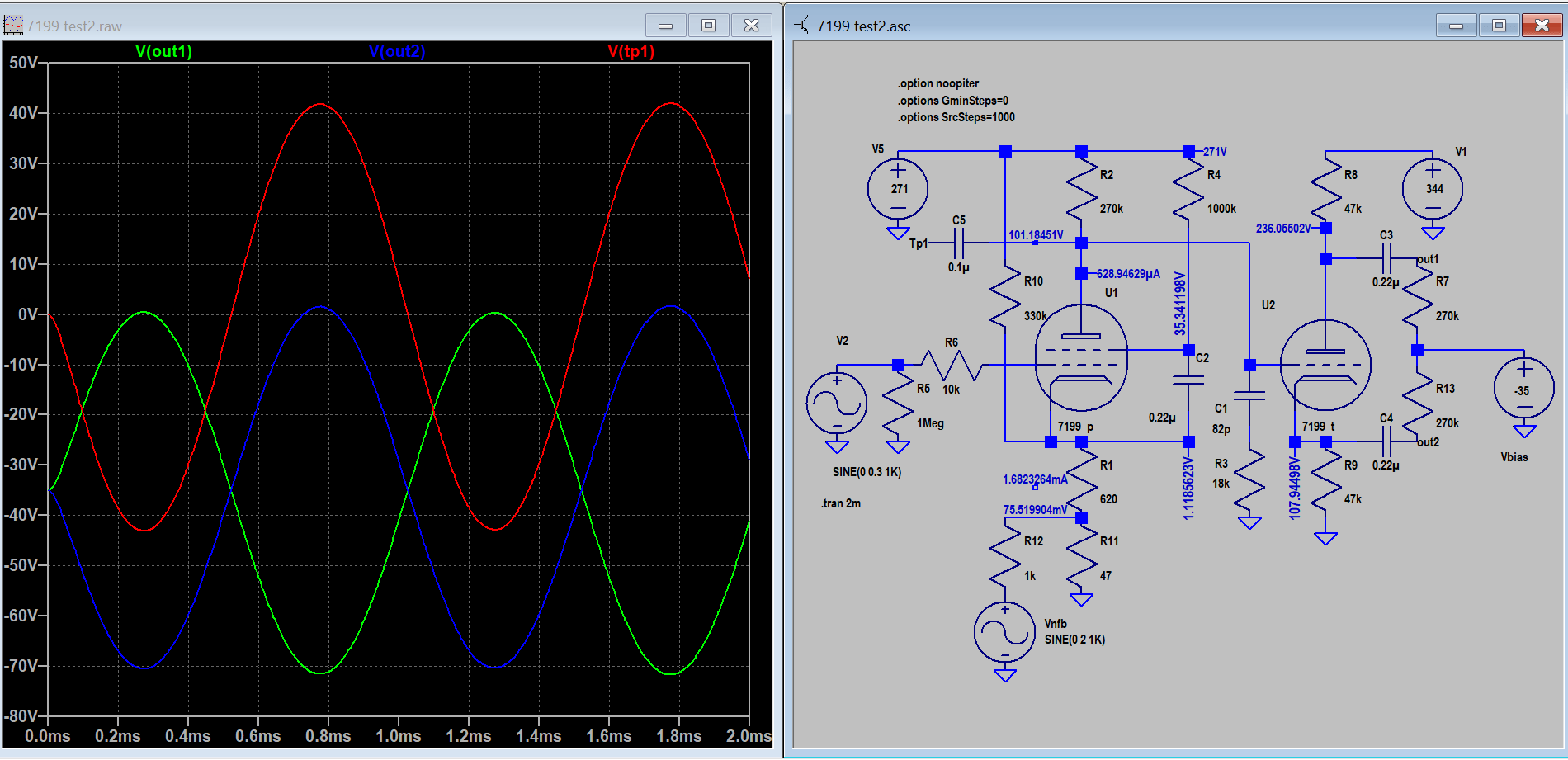

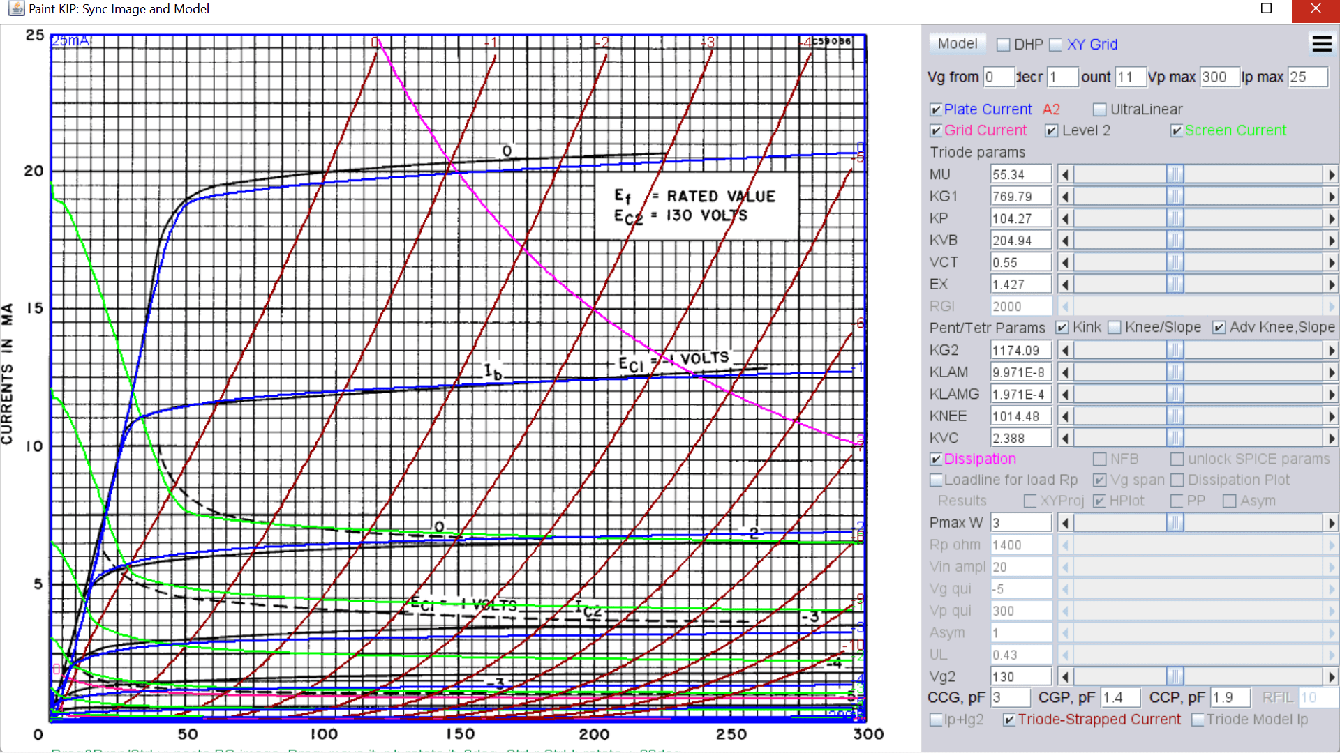

I have used this 7199 pentode model for simulating the Dynaco St-70. I have compared the model with published plots in the attached 7199.pdf datasheet. I can accurately duplicate the Plate Characteristics curve on pg. 5, in which the screen grid is 130 V. The same model performs poorly modeling the Transfer Characteristics curve on pg. 6. Here, the screen is 50 V. LTSpice is producing both plate and screen currents that are roughly half of the published values, over a range of grid 1 voltages. This is as if the model was generated using a screen grid voltage of 130, and it falls apart with smaller screen voltages.
Back to the Dynaco simulation, the screen runs at a lower voltage, and the pentode is not conducting nearly enough for the phase splitter stage to work (pentode plate voltage way too high). Does anyone have experience or insight into this pentode model? Or how to adjust the model to handle a range of screen potentials?
Thanks in advance,
Bill S.

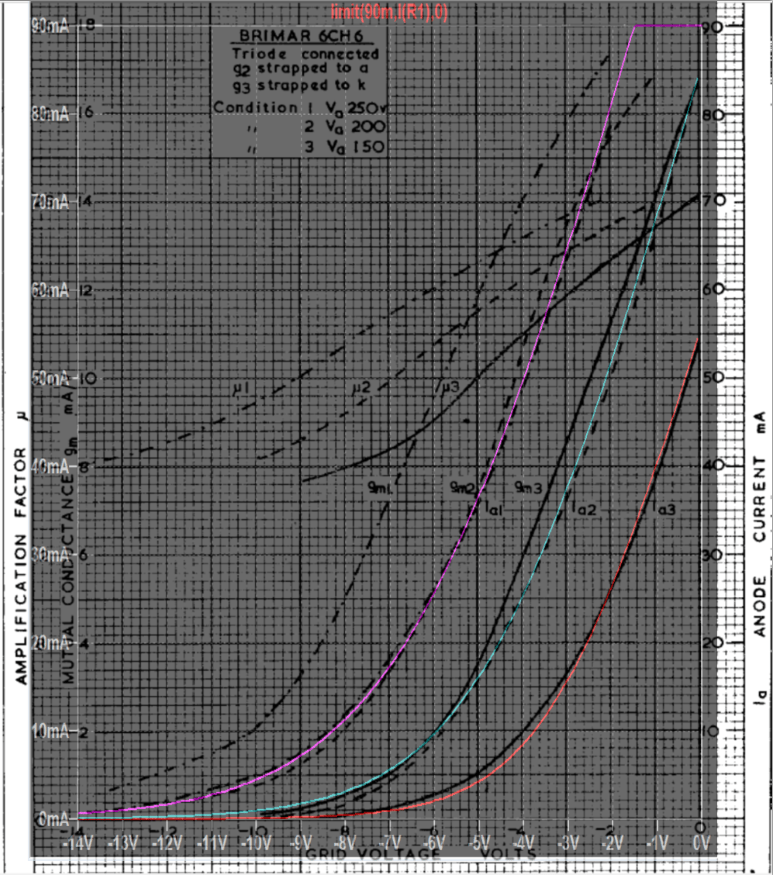

Thank you for bringing up this issue to our attention but have U got another brand IV curve to compare? Paint Tool is (quite) accurate in ploting transfer curve for other tubes, say for 845 awhile ago.

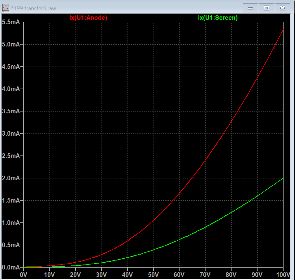

As no triode connected curve is available, param VCT can not be precisely specified. So by trial and error, the transfer curve has finally matched the original by adjusting VCT (that shift the curve left or right) Give it another try:
Code:
**** 7199_P ******************************************
* Created on 09/08/2022 01:37 using paint_kip.jar
* Plate Curves image file: 7199-p.png
* Data source link: <plate curves URL>
.SUBCKT 7199_P P G2 G K ; LTSpice tetrode.asy pinout
* .SUBCKT 7199_P P G K G2 ; Koren Pentode Pspice pinout
+ PARAMS: MU=55.34 KG1=769.79 KP=104.27 KVB=1078.62 VCT=0.55 EX=1.427 KG2=1174.09 KNEE=1014.48 KVC=2.388
+ KLAM=9.971E-8 KLAMG=1.971E-4  KD=4.272E-6 KC=1.188E-10 KR1=1.624 KR2=0.02688 KVBG=0.00734 KB1=1.95 KB2=8.603 KB3=2.46 KB4=0.1404 KVBGI=1.589E-4 KNK=0.1675 KNG=0.05509 KNPL=0.02375 KNSL=0.0739 KNPR=0.2612 KNSR=14.72
+ CCG=3P CGP=1.4P CCP=1.9P VGOFF=-1.5 IGA=0.002687 IGB=0.05343 IGC=13.36 IGEX=1.764
* Vp_MAX=300 Ip_MAX=25 Vg_step=1 Vg_start=0 Vg_count=11
* X_MIN=49 Y_MIN=10 X_SIZE=777 Y_SIZE=657 FSZ_X=1296 FSZ_Y=736 XYGrid=false
* Rp=1400 Vg_ac=20 P_max=3 Vg_qui=-5 Vp_qui=300
* showLoadLine=n showIp=y isDHP=n isPP=n isAsymPP=n isUL=n showDissipLimit=y
* showIg1=y isInputSnapped=y addLocalNFB=n
* XYProjections=n harmonicPlot=y dissipPlot=n
* UL=0.43 EG2=130 gridLevel2=y addKink=y isTanhKnee=n advSigmoid=y
RE1  7 0  1G    ; DUMMY SO NODE 7 HAS 2 CONNECTIONS
E1   7 0  VALUE=  ; E1 BREAKS UP LONG EQUATION FOR G1.
+{V(G2,K)/KP*LOG(1+EXP((1/MU+(VCT+V(G,K))/SQRT(KVB+V(G2,K)*V(G2,K)))*KP))}
RE2  6 0  1G    ; DUMMY SO NODE 6 HAS 2 CONNECTIONS
E2  6 0  VALUE={(PWR(V(7),EX)+PWRS(V(7),EX))} ; Kg1 times KIT current
E4   8 0  VALUE={V(P,K)/KNEE/(KVBGI+V(6)*KVBG)}
E5  81 0  VALUE={PWR(V(8),KB1)}
E6  82 0  VALUE={PWR(V(8),KB2)}
E7  83 0  VALUE={PWR(V(8),KB3)}
E8   9 0  VALUE={PWR(1-EXP(-V(81)*(KC+KR1*V(82))/(KD+KR2*V(83))),KB4)*1.5708}
RE4  8 0  1
RE5 81 0  1
RE6 82 0  1
RE7 83 0  1
RE8  9 0  1
RE21 21 0 1
E21  21 0 VALUE={V(6)/KG1*V(9)} ; Ip with knee but no slope and no kink
RE22 22 0 1 ; E22: kink curr deviation for plate
E22  22 0 VALUE={V(21)*LIMIT(KNK-V(G,K)*KNG,0,0.3)*(-ATAN((V(P,K)-KNPL)/KNSL)+ATAN((V(P,K)-KNPR)/KNSR))}
G1   P K  VALUE={V(21)*(1+KLAMG*V(P,K))+KLAM*V(P,K) + V(22)}
G2   G2 K  VALUE={V(6)/KG2*(KVC-V(9))/(1+KLAMG*V(P,K)) - V(22)}
RCP  P K  1G     ; FOR CONVERGENCE
C1   K G  {CCG}  ; CATHODE-GRID 1
C2   G P  {CGP}  ; GRID 1-PLATE
C3   K P  {CCP}  ; CATHODE-PLATE
RE23 G 0 1G
GG G K VALUE={(IGA+IGB/(IGC+V(P,K)))*(MU/KG1)*
+(PWR(V(G,K)-VGOFF,IGEX)+PWRS(V(G,K)-VGOFF,IGEX))}
.ENDS

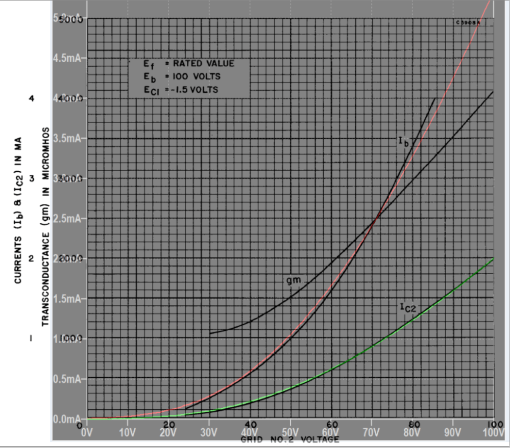

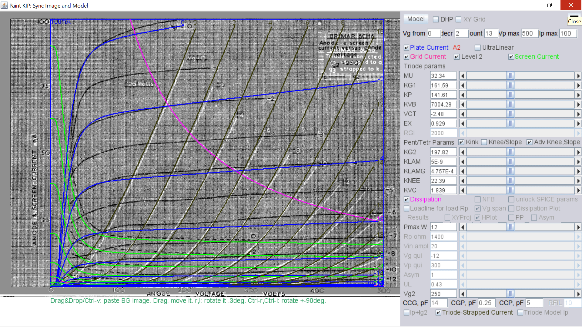

Reactions: Yurik_V
I further adjusted param VGOFF to 0, and verified with another schematic measurement:

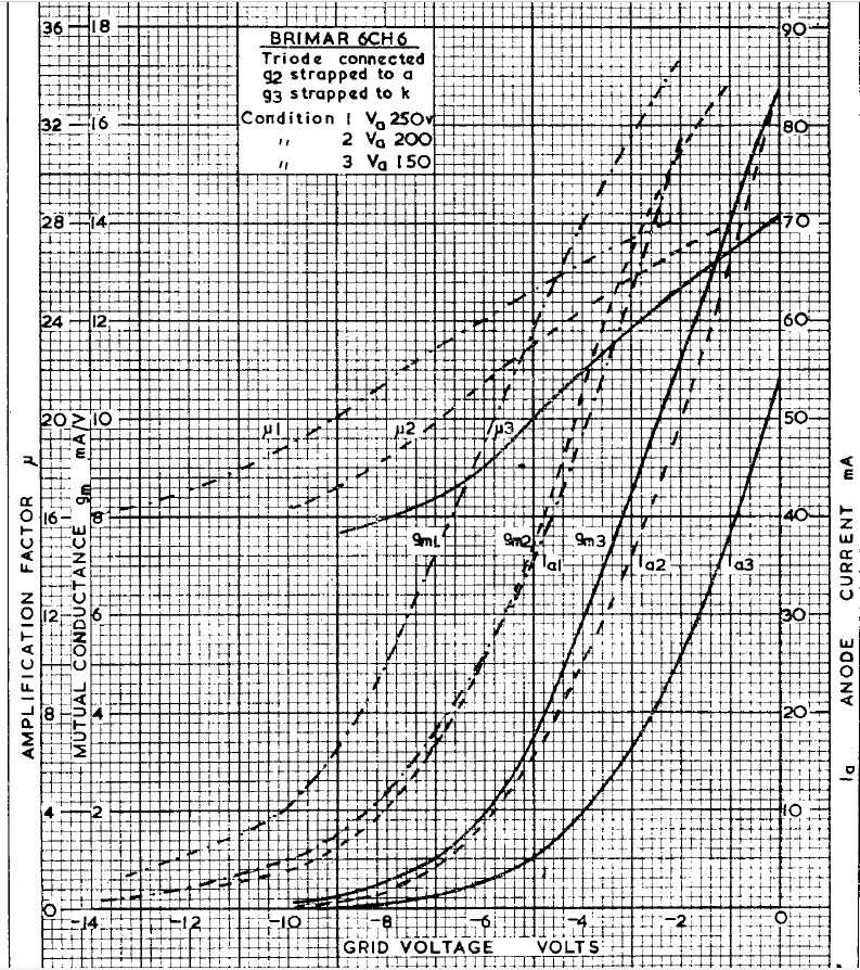

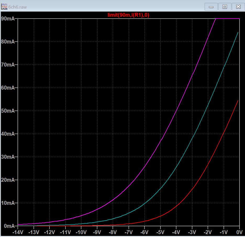

Try this STC/Brimar 6ch6 pentode model:
Code:
*** 6CH6_P ******************************************
* Created on 09/16/2022 01:44 using paint_kip.jar
* Plate Curves image file: 6ch6-p.png
.SUBCKT 6CH6_P P G2 G K ; LTSpice tetrode.asy pinout
* .SUBCKT 6CH6_P P G K G2 ; Koren Pentode Pspice pinout
+ PARAMS: MU=32.34 KG1=161.59 KP=141.61 KVB=7004.28 VCT=-2.48 EX=0.929 KG2=197.82 KNEE=22.39 KVC=1.839
+ KLAM=5E-9 KLAMG=4.757E-4  KD=78.41 KC=0.02893 KR1=8.15E-4 KR2=0.03169 KVBG=1.641E-7 KB1=0.5652 KB2=2.289 KB3=2.366 KB4=55.99 KVBGI=2.618E-5 KNK=0.03384 KNG=1.068E-4 KNPL=0.003524 KNSL=8.783E-4 KNPR=287.7 KNSR=37835.67
+ CCG=14P CGP=0.25P CCP=5P VGOFF=-0.6 IGA=0.001 IGB=0.3 IGC=8 IGEX=2
* Vp_MAX=500 Ip_MAX=100 Vg_step=2 Vg_start=0 Vg_count=13
* X_MIN=111 Y_MIN=19 X_SIZE=733 Y_SIZE=588 FSZ_X=1296 FSZ_Y=736 XYGrid=false
* Rp=1400 Vg_ac=20 P_max=12 Vg_qui=-12 Vp_qui=300
* UL=0.43 EG2=250 gridLevel2=y addKink=y isTanhKnee=n advSigmoid=y
RE4  8 0  1
RE5 81 0  1
RE6 82 0  1
RE7 83 0  1
RE8  9 0  1
RE21 21 0 1
RE23 G 0 1G
.ENDS
