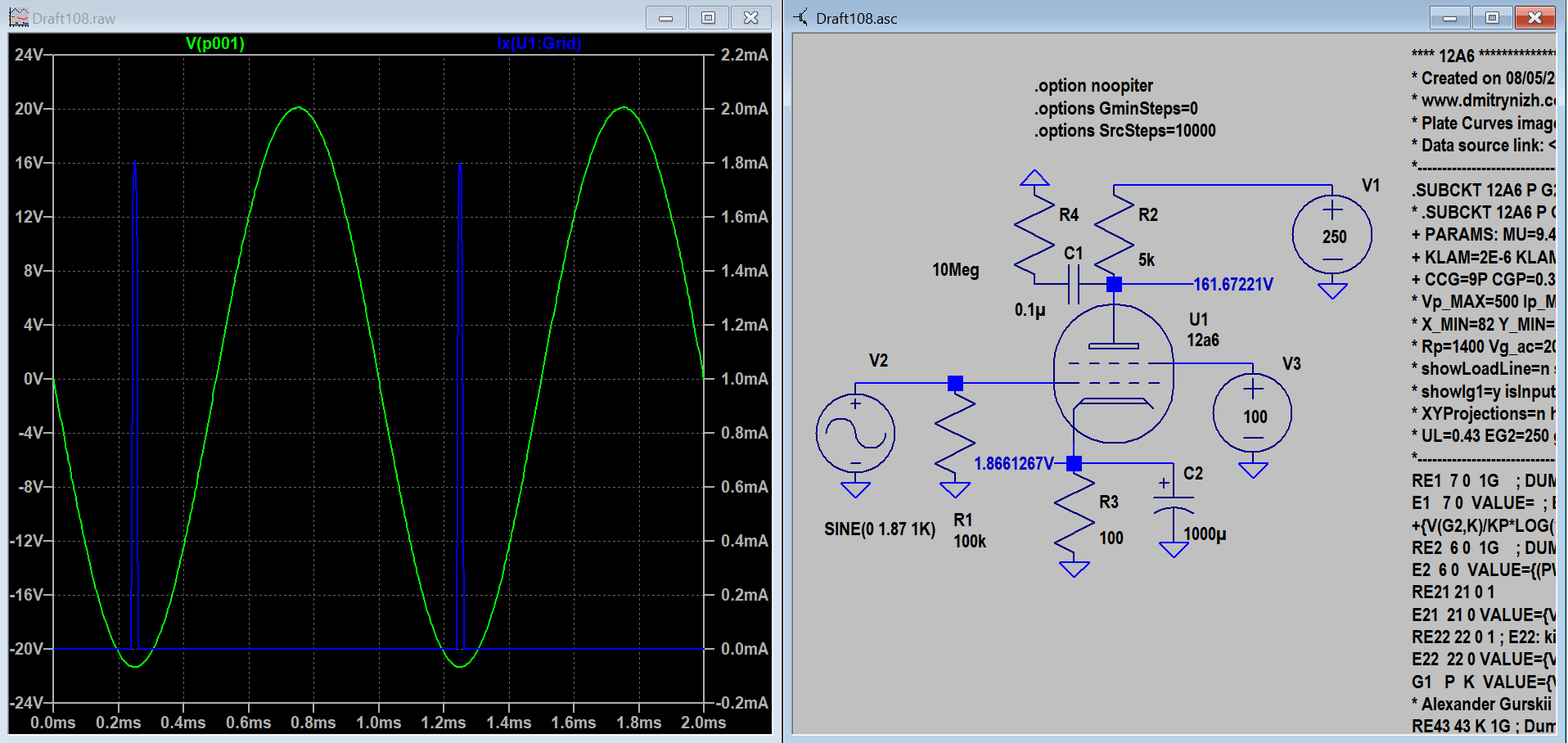

It takes forever to simulate a transient response in LTSpice and in the end I get a bogus result.
DC analysis works fine, but AC doesn't
Thanks, I had another look at it, and the model seems to be very picky when the signal is clipped even a little bit.You can try these options:
.option noopiter
.options GminSteps=0
.options SrcSteps=1000

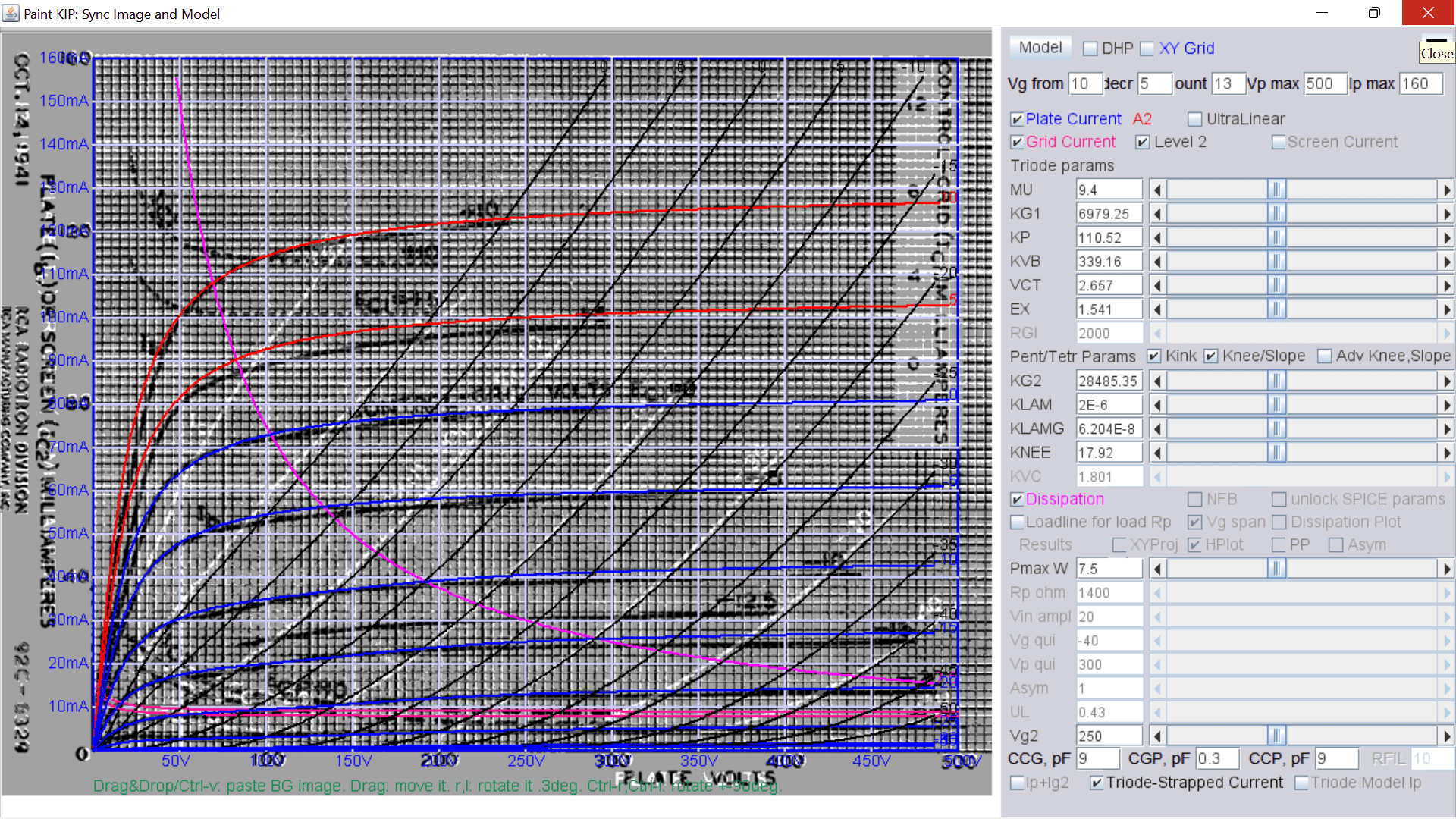

Here is revised12a6 RCA model as previous model draws too much grid1 current, hence VGOFF is adjusted to 0V from -1.8V and grid current scale readjusted. Attached shown is grid current drawn just slightly over driven, that is normal behaviors I believe.
Please try again:
Please try again:

Thanks again!Here is revised12a6 RCA model as previous model draws too much grid1 current, hence VGOFF is adjusted to 0V from -1.8V and grid current scale readjusted. Attached shown is grid current drawn just slightly over driven, that is normal behaviors I believe.
Please try again:

I don't see a lot of difference, and that weird clipping behavior is also still there.
It seems to be a quirk in LTSpice with certain models (not only tube related).
With some parts you just have to clip ever so slightly and it won't work it seems?
That grid current fix maynot address your issue. But I don't understand exactly what is the problem so as to give you a fix. To help us, can you post some snapshots of simulation or files?
I have seen this particular behaviour, where the slightest hint of clipping makes the simulation unstable. It's unpredictable, at least in my experience.Thanks again!
During clipping grid 1 went into oscillation esp with cap coupled input. If in A2 (direct coupled) mode rather than A1(cap coupled), it's fine. So I want to post here a less complex grid current model (RGI), but less accurate where everything else is not affected.

Thank you so much again for all the effort!!During clipping grid 1 went into oscillation esp with cap coupled input. If in A2 (direct coupled) mode rather than A1(cap coupled), it's fine. So I want to post here a less complex grid current model (RGI), but less accurate where everything else is not affected.
12a6 RGI grid current model:

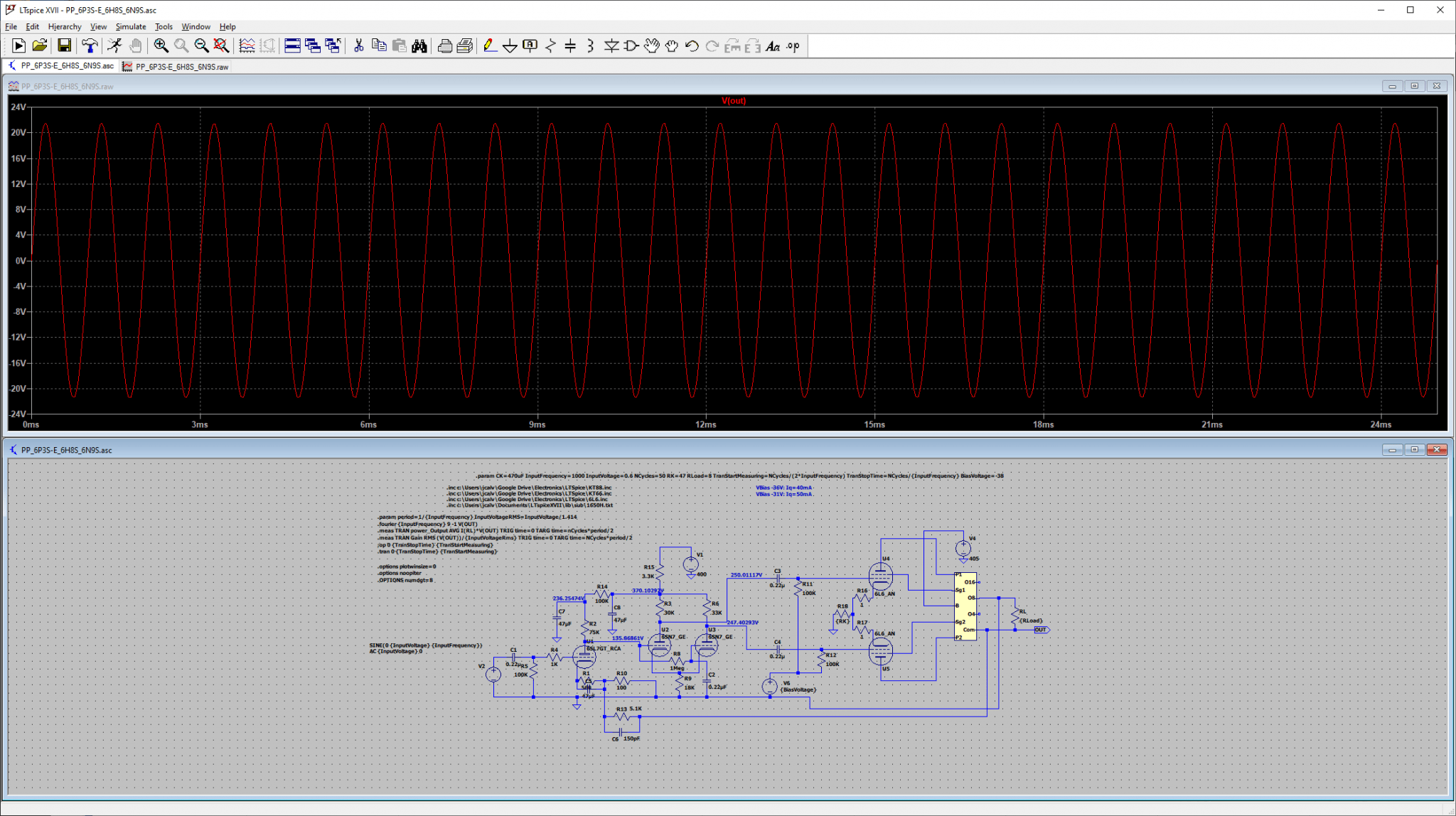

I know this thread is really for LTspice tube models, but I was wondering if someone has an LTspice simulation file with models for a push-pull tube power amp? Doesn't matter which tubes, I just want to check something out.
Would save me a lot of time, appreciated!
Jan
Jan
Here is one, based on EICO HF-89, built first, then simulated.I know this thread is really for LTspice tube models, but I was wondering if someone has an LTspice simulation file with models for a push-pull tube power amp? Doesn't matter which tubes, I just want to check something out.
Jan
I will send a PM with a zip fileThanks, that's a nice circuit for me to play with. Could you also post the .asc?
Jan
Edit: my post shows the asc attached, can you see it?
Missing stuff in the archive.Yes I do, sorry I missed it.
Missing triode-w1-ddtransppul , probably a .inc file?
Jan
Jan
Almost! I think I also need .inc c:\Users\jcalv\Google Drive\Electronics\LTSpice\6L6.inc or at least the 6L6.inc .
There are 3 other .inc files which I believe I do not need.
Jan
Jan
Attached, just rename it to 6L6.incAlmost! I think I also need .inc c:\Users\jcalv\Google Drive\Electronics\LTSpice\6L6.inc or at least the 6L6.inc .
Jan
