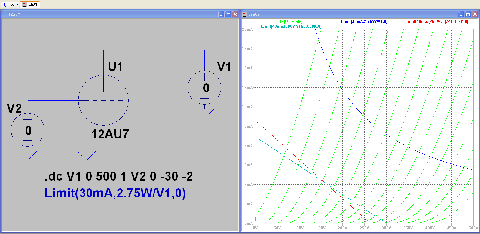

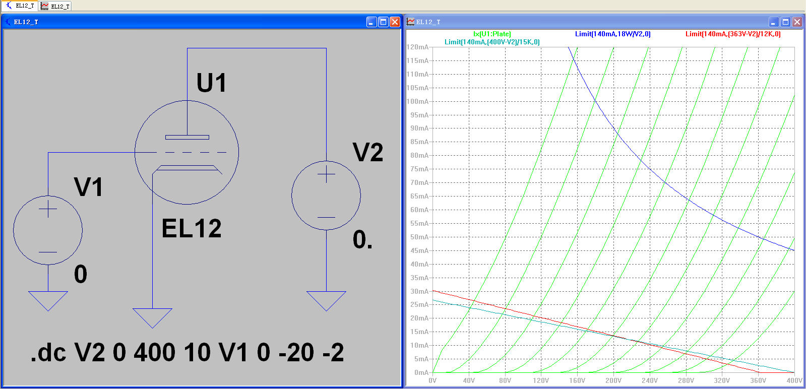

"Ix(U1😛late)" trace is not limited in your plot, try to use same Limit range in all expressions. Say if Limit(140m, ... , 0) then use same range for any other added expression.
Which bracket do you use: [] or ()? I use (). It appears to me you have a space in Limit function: Limit(1 30m, ...., 0)? You can paste the expression here if you wish.
No need to include "Ix(U1😛late)" in all expressions of the trace plots other than the "Ix(U1😛late)" plot itself. I can plot one myself later to confirm you try again.
You have plotted the same trace "Ix(U1😛late)" twice, one with and one without Limit, remove the one without the Limit..

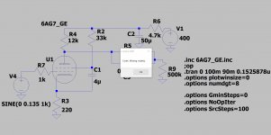

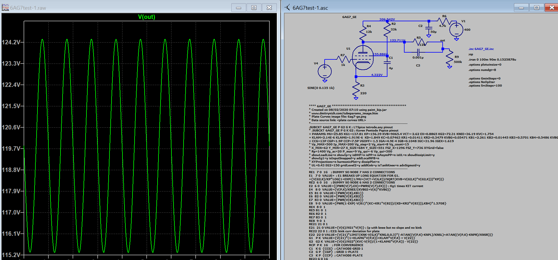

Koonw, did you (or anyone else) try the 6AG7_GE model in post 2532 in LTSpice? I get a missing node error. Thx
I tried 6AG7_GE is fine. You probably have one or more unknown spice directive, maybe you mislabel a net name as spice directive?
I added this spice directives it works.
.options GminSteps=0
.options NoOpIter
.options SrcSteps=100
.options NoOpIter
Still doesn't work for me. Here is the screen shot with the added directives.
I was running the same basic circuit with the same exact directives today with several other tubes, no problem at all. It only refused to run with 6AG7_GE.
Is the model correct for LTSpice as posted or is it for PSpice?
Thanks. It was the model indeed. It took me a while to figure it out but something got corrupted when I copied the model from post #2532. I don't know what or how it happened, but I re-copied it and it works fine now. It looked the same, I didn't go through it letter by letter. I must have accidentally touched a keyboard key while cut-and-pasting it. I appreciate your help.
intersting, the Y axis changed to mV 😡
Oh I realise we need to be more specific about the exact unit. 11mA is more exact instead of 11m which it treated as 11mV, so it should be as below:
Limit(11mA,(263V-V1)/24.812K,0)
Cool thx @sorento. Similar shape and pattern to the Ayumi model in triode mode though difficult to judge the voltage and current levels.

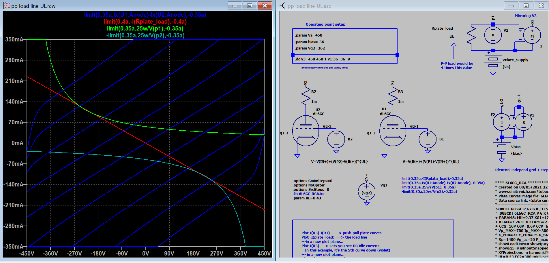

I am looking for a circuit to model the ultralinear curves for a pentode/tetrode. Does anyone know how this is done? Jazbo8 and Jackinnj were discussing a few years back but links to pics are dead now.
Below is the latest discussions on Triode, Pentode and Ultra linear curve plots, the results are assumed more accurate:
Vacuum Tube SPICE Models
Here is pseudo ultra-linear model for PP for SE Amp. There are Composite PP curve model as well on this forum, maybe need a little correction. I see if I can locate them.
Push Pull Load Lines - revisited - Intact Audio
The above site has a composite curve for Pentode and I added UL mode, but you can run any other mode by changing UL=0 pentode, UL=1 triode, UL=0.43 UL, of course you can too plot single ended UL curve.
