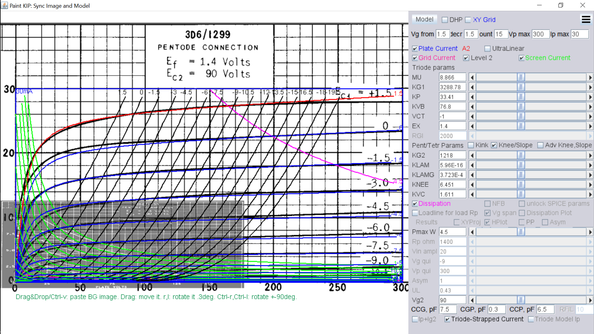

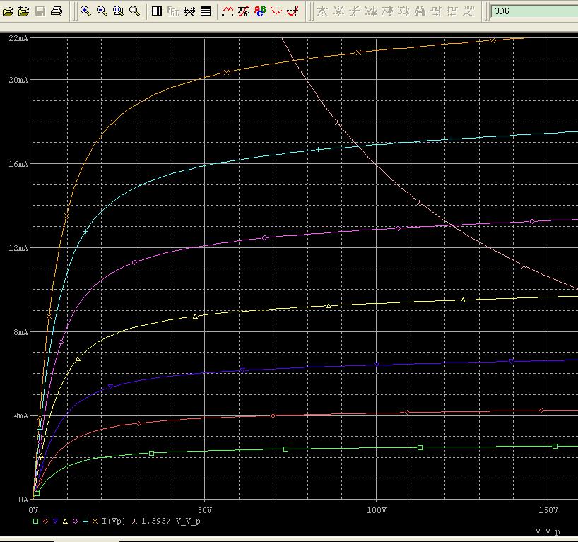

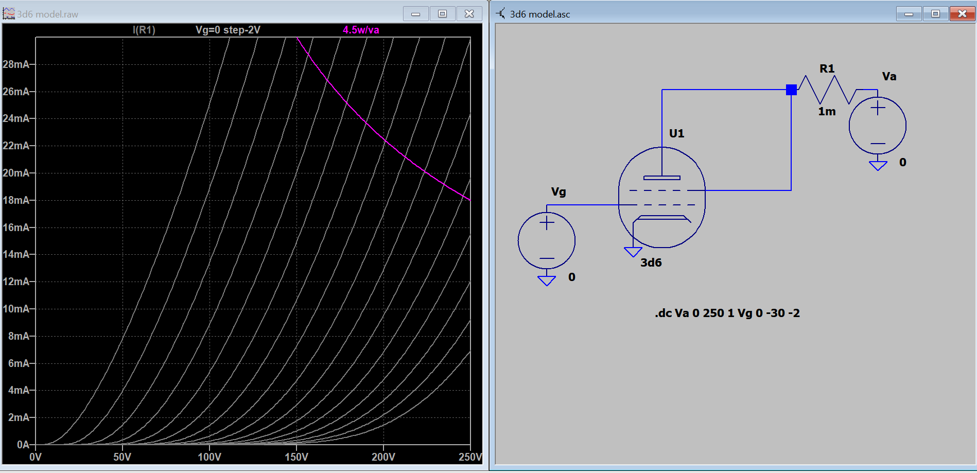

Hi Koonw, I am looking for PSpice Pentode & Triode models of 1F5-G, 3D6, 6SG7. Please help, Thank You.
3D6 model:
Code:
* [url=http://www.dmitrynizh.com/tubeparams_image.htm]Model Paint Tools: Trace Tube Parameters over Plate Curves, Interactively[/url]
* Plate Curves image file: 3d6.png
* Data source link: <plate curves URL>
.SUBCKT 3D6 P G2 G K ; LTSpice tetrode.asy pinout
* .SUBCKT 3D6 P G K G2 ; Koren Pentode Pspice pinout
+ PARAMS: MU=8.866 KG1=3288.78 KP=33.41 KVB=76.8 VCT=-1 EX=1.4 KG2=1218 KNEE=6.451 KVC=1.611
+ KLAM=5.96E-16 KLAMG=3.723E-4 KNEE2=0.7359 KNEX=0.02344 KNK=-0.14 KNG=0.00937
+ CCG=7.5P CGP=0.3P CCP=6.5P VGOFF=-1 IGA=0.00104 IGB=0.336 IGC=37.92 IGEX=3.46
* Vp_MAX=300 Ip_MAX=30 Vg_step=1.5 Vg_start=1.5 Vg_count=15
* X_MIN=34 Y_MIN=168 X_SIZE=834 Y_SIZE=417 FSZ_X=1296 FSZ_Y=736 XYGrid=false
* Rp=1400 Vg_ac=20 P_max=4.5 Vg_qui=-9 Vp_qui=300
* showLoadLine=n showIp=y isDHP=n isPP=n isAsymPP=n isUL=n showDissipLimit=y
* showIg1=y isInputSnapped=y addLocalNFB=n
* XYProjections=n harmonicPlot=y dissipPlot=n
* UL=0.43 EG2=90 gridLevel2=y addKink=n isTanhKnee=y advSigmoid=n
RE1 7 0 1G ; DUMMY SO NODE 7 HAS 2 CONNECTIONS
E1 7 0 VALUE= ; E1 BREAKS UP LONG EQUATION FOR G1.
+{V(G2,K)/KP*LOG(1+EXP((1/MU+(VCT+V(G,K))/SQRT(KVB+V(G2,K)*V(G2,K)))*KP))}
RE2 6 0 1G ; DUMMY SO NODE 6 HAS 2 CONNECTIONS
E2 6 0 VALUE={(PWR(V(7),EX)+PWRS(V(7),EX))} ; Kg1 times KIT current
G1 P K VALUE={V(6)/KG1*ATAN((V(P,K)+KNEX)/KNEE)*TANH(V(P,K)/KNEE2)*(1+KLAMG*V(P,K))+KLAM*V(P,K)}
* Alexander Gurskii screen current, see audioXpress 2/2011
RE4K 4K K 1G ; Dummy, per Alex request
E4K 4K 4 VALUE={0} ; Dummy, per Alex request
G4K 4K K VALUE={V(6)/KG2*(KVC-ATAN((V(P,K)+KNEX)/KNEE)*TANH(V(P,K)/KNEE2))/(1+KLAMG*V(P,K))}
RCP P K 1G ; FOR CONVERGENCE
C1 K G {CCG} ; CATHODE-GRID 1
C2 G P {CGP} ; GRID 1-PLATE
C3 K P {CCP} ; CATHODE-PLATE
RE23 G 0 1G
GG G K VALUE={(IGA+IGB/(IGC+V(P,K)))*(MU/KG1)*
+(PWR(V(G,K)-VGOFF,IGEX)+PWRS(V(G,K)-VGOFF,IGEX))}
.ENDS
Hello Koonw, thank you very much

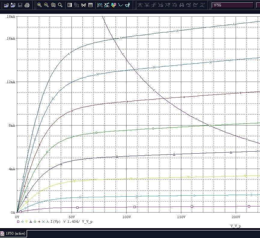

The 3D6 pentode model worked great with PSpice! Please provide the Triode model together 🙂

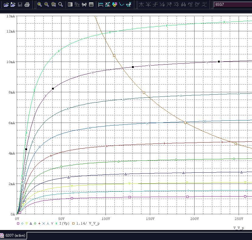

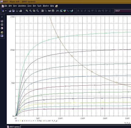

6SG7 model:
Code:
* [URL="http://www.dmitrynizh.com/tubeparams_image.htm"]www.dmitrynizh.com/tubeparams_image.htm[/URL]
* Plate Curves image file: 6sg7.png
.SUBCKT 6SG7 P G2 G K ; LTSpice tetrode.asy pinout
* .SUBCKT 6SG7 P G K G2 ; Koren Pentode Pspice pinout
+ PARAMS: MU=48.75 KG1=706.16 KP=40.28 KVB=36.69 VCT=-1.648 EX=1.61 KG2=865.83 KNEE=13.03 KVC=2.213
+ KLAM=7.226E-11 KLAMG=6.961E-5 KNEE2=5.919 KNEX=0.0525 KNK=-0.044 KNG=0.006
+ CCG=8.5P CGP=0.003P CCP=7P VGOFF=-0.6 IGA=0.001 IGB=0.3 IGC=8 IGEX=2
* Vp_MAX=500 Ip_MAX=12.5 Vg_step=2 Vg_start=0 Vg_count=20
* X_MIN=75 Y_MIN=105 X_SIZE=556 Y_SIZE=562 FSZ_X=1296 FSZ_Y=736 XYGrid=false
* Rp=1400 Vg_ac=20 P_max=3 Vg_qui=-19 Vp_qui=300
* UL=0.43 EG2=100 gridLevel2=y addKink=n isTanhKnee=y advSigmoid=n
RE23 G 0 1G
.ENDS

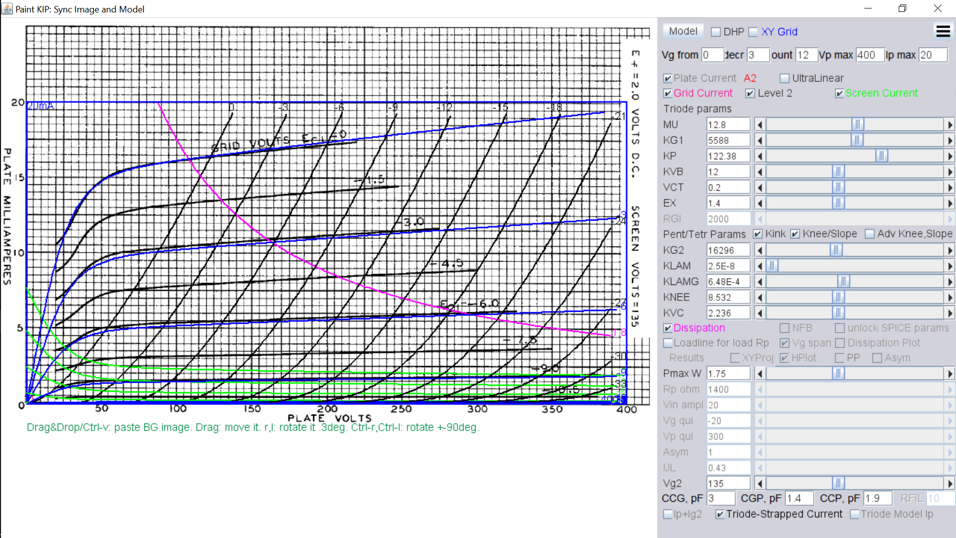

1f5g model:
Code:
*** 1F5G ******************************************
* Created on 06/22/2021 11:18 using paint_kip.jar
* Plate Curves image file: 1f5g.png
.SUBCKT 1F5G P G2 G K ; LTSpice tetrode.asy pinout
* .SUBCKT 1F5G P G K G2 ; Koren Pentode Pspice pinout
+ PARAMS: MU=12.8 KG1=5588 KP=122.38 KVB=12 VCT=0.2 EX=1.4 KG2=16296 KNEE=8.532 KVC=2.236
+ KLAM=2.5E-8 KLAMG=6.48E-4 KNEE2=26.13 KNEX=69.3 KNK=-0.044 KNG=0.006 KNPL=50 KNSL=11 KNPR=120 KNSR=29
+ CCG=3P CGP=1.4P CCP=1.9P VGOFF=-0.6 IGA=0.001 IGB=0.3 IGC=8 IGEX=2
* Vp_MAX=400 Ip_MAX=20 Vg_step=3 Vg_start=0 Vg_count=9
* X_MIN=36 Y_MIN=113 X_SIZE=803 Y_SIZE=404 FSZ_X=1296 FSZ_Y=736 XYGrid=false
* Rp=1400 Vg_ac=20 P_max=1.75 Vg_qui=-12 Vp_qui=300
* UL=0.43 EG2=135 gridLevel2=y addKink=y isTanhKnee=y advSigmoid=n
