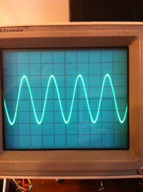

Full 6c33c..
At 8/9/10/11/12V...I did manage 13V however the 1.6A T fuse blew..so no picks ...didn't want to try it again..drawing 1.7A
Again X10 probe so you have to multiply..
Regards
M. Gregg
Just want to check I'm reading this correctly. You are getting a maximum of about 12V peak-to-peak, into 7.9 ohms? That would be about 2.8W continuous power. That seems pretty low. Are you sure about the voltages? You mentioned blowing a 1.6A fuse at 13V peak-to-peak, but that would be only 4.6V rms, which doesn't seem like it should be enough to blow the fuse.
Could something be wrong with your voltages?
Chris

I agree something is not right,
Just looking at your wave on the scope..
I will have a look there is something strange...
If power is that low...it does not sound low...

Can you put a DVM on the output, and measure the rms voltages?
Chris
Chris
Something is wrong the ouput RMS voltage is 4.6V...That can't be correct...Don't know if I have a fault...

Well 4.6V rms is certainly consistent with your scope trace showing 13V peak to peak.
I believe autobias could be expected to give a lower output power than fixed bias, but I'd be surprised if it should be as low as you are finding.

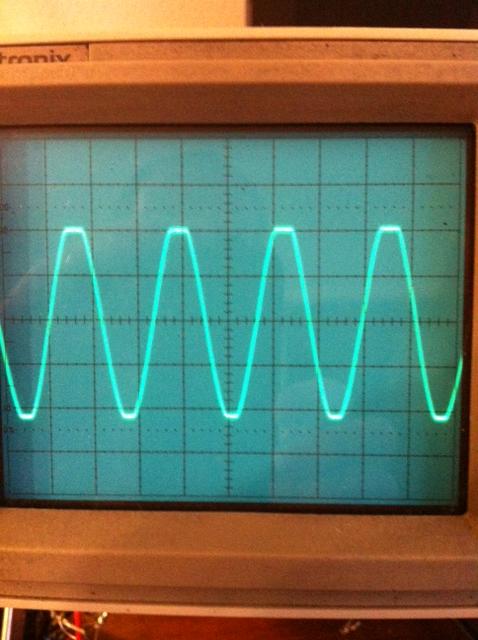

OK Right--Here goes....
Yup--I Boobed, I'm an idiot, a total fool--Go on, you might as well all larf at me.....
Today I did some semi-proper testing using my Tektronix 454 Scope and a pukka sig-gen, and some much,-- now obvious-- Tuning Up!.
(This is why its taken me a while to do this, Setting all this gear up when I have the place to myself....)
I found that the PI cannot currently swing more than around 20V p-p before flat-topping/distortion, similar to what M-Gregg was having.
I have increased the values of the two PI resistors to 47K and now have 60V p-p before any mishaping/distortions, just a nice sine-wave.
PI +B Supply is 320V...
I've also dropped the Grid resistor to PI to 100K.
Running PL509, a single pair, the amp will drive 11V p-p of CLEAN, Perfect sine wave @1KHz with No sign of distortions or flat-topping, into 8 ohms.
Increasing the O/P to apprx 11.5V, we get the usual flat-topping (Symetrical) And Crossover Distortion, Caused by the Cathode-Caps charging and altering the bias of O/P valves.
This was done into an 8 Ohm non-inductive wire-wound resistor.
So, The Peak Watts value I currently have from a single channel with only a single pair of PL509 is 15.125W --Undistorted.
This equates to--If my maths is good-- to 10.6 Watts, RMS.
--Which means the O/P valves are supplying 1.375 Amps of Current.
--So, Although the O/P pair COULD make More Power if Fixed-Bias, the Self-Bias is effectively limiting the Current Passed to just a Little Under the Max Pulse value in the data-sheet (1.4A for the '509), which cant be bad.
I left it running just before the point of clip like this to see what happened to the O/P valves.
--The answer was, Nothing! They got fairly warm but no red-plates or glowing screens, just worked...

Hang on, there's something wrong here. 11V peak-to-peak means 11/(2 sqrt(2)) V RMS, i.e. about 3.9V RMS. This means the continuous power (RMS power) is about (3.9)^2/8 which is about 1.9W.

Think I know why.....
Steady-State measurements aint gonna tell the power of this amp....
Because, The By-Pass caps in the cathode-circuits of O/P tubes charge up under these conditions, upsetting the bias....
