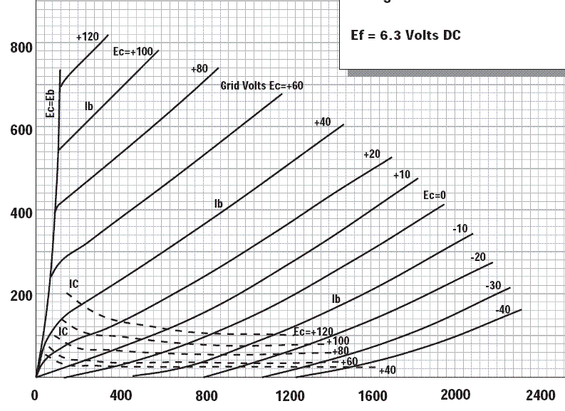

I cant seem to get usable data
I am trying to build a model for an 812A Triode.
I have followed all the instructions I can find to build the model, however
once the devcie model is drawn, some of the curces are dropped, and what remains is an incredably bad fit. In addition all the Loren modle did not compute #INF mA
Here is the curve I am trying to fit to as well as my captured data set.
I would be greatfull if somone could give me some pointers?
I have renamed the .crv file with a .txt extension to allow it to be attached
Regards
Roger
  • 812ACurves_crv.txt
    812ACurves_crv.txt
