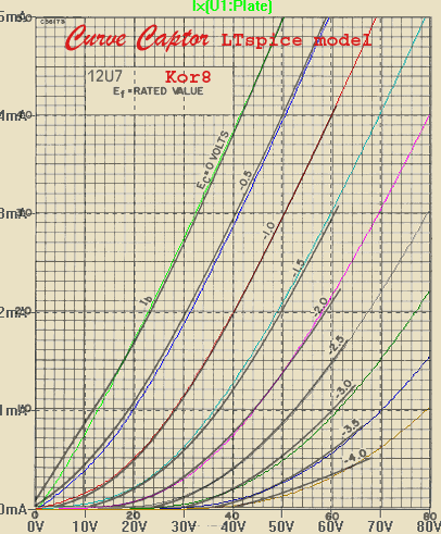

Yeah, they are Pspice models, LTspice is compatible with pspice models, but gives errors on curly brackets etc(probably why I have to tweak them) . One of the things nice about your program is it displays the curves, Teodoro's just generates the params from the capture, then I plug them into LTspice and create my own tube chart. I use Photoshop to do overlays of the spice model with the bogey chart to refine the model.
I don't trust my model until I get a reasonable fit, using this method. I guess if your tool will make the model without the need to tweak, then the Params layout wouldn't be needed.

WoW!!
Andrei,
Thanks for getting the Pspice and LTspice support up so quick!
The curves draw up real nice within curve captor, but the first few times in LTspice I got bad results checked the error log ran the schematic again and ...bang-boom dead-on results!
(I'm not really sure why my first test were so wrong, same models, same schematic? just win98 doing its thing, probably)
Anyway ...You're my hero!
Thanks again,
Luap
