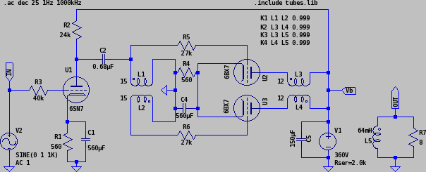

I am a little strapped for time right now. I have designed a neat little amplifier (6SN7-6BX7, single PCB construction, commodity parts, gets 5W without feedback) a while back using Curve Captor, but had not had a chance to build it (which is outrageous, as I even have the PCBs made). Once I test it, and if nothing explodes, I'll promote Curve Captor to 1.0, and get on to further development...

Dominique_free said:With something as:
Cgp G P <value>
Cgk G k <value>
Ckp K P <value>
I've just tried this way but the simulation is not reliable...
The source sees a load equivalent to the Cgp value, Miller effect seem to be missed! 🙄
Many thanks for the link!
The declarations for the capacitance must be in the subcircuit, that mean between the lines .subckt and .ends
I use most ngslpice and don't have problem with the miller capacitance with it. In the past when using windows at home, it was no problem with microcap. Maybe it is a syntax problem. Pspice syntax is not always the same as spice syntax, and especialy with subcircuits. I don't remember if microcap can use both syntaxes.
Another soft that run both on windose and linux is LTspice. I don't like the shematic part but the simulation part is better as microcap, and its free software without limitation. http://www.linear.com/company/software.jsp
