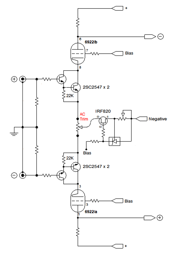

Not known, but later we discussed using Darlington pairs, low noise matched bipolars. The idea came from Rowan McCombe before he passed away, better known as the guru in Allen's book. You guys might like to try it. Just be sure to match hfe and the 2SC2547 was a favourite of Allen's.
Value 2 x 22K may be tried or left out altogether. Vref for the CS is a TL431 and the "Bias" resistor for it would be typically 15K. The AC Trim may be replaced with two fixed resistors as AC balance should be fine if the Darlington pairs are well matched. The Bias voltage for the 6922a/b and CS I would use +20V, but +15V would likely be OK too.

Hi Joe,
Very interesting! What value would be needed for the resistors in the CS and the trimmers ( both AC Trim and trimmer at the right hand side of the IRF820 ) and even more important what is the gain of this circuit? Is it comparable with MAT02 or slightly lower?

The CS is only a suggestion, that part could be done in a number of different ways. What is shown as IRF820 and reference by TL431, has the advantage, if set up right, can handle fairly high negative voltage.
The current can be anything from 4-5mA and up to 9-10mA per phase (up to 20mA in total if you want to push it), the Anode resistor value you would need to figure out depending on the current, but 25-33K seems to be about right. The gain is very high and probably some local degeneration resistors via emitters to CS. The 22K may best be left out, but you can adjust and report the sound here.
If the stage is used as a front-end to a tube output stage and output transformers, then you must leave the 22K out as it tends to impede very large voltage swings. The B+ will likely need to be 300V, but with around 5-6mA current (10-12mA CS) and 25K, you might get it down to 250V. If used in a power amp, the voltage needs to be higher and I would use 33K. You just have to use common sense, depending on what you want to do.
That should cover it so far?
Cheers, Joe
Cheers, Joe
Hi Joe,
Thank you very much for your answers.
If I maybe do this mod I will apply it in Allen's latest version of the RTP3 phono stage ( link to schematic given above under #806 ) as this is the easiest way by replacing T1 and T2 ( SSM2210 ) with these Darlington's. This circuit makes use of separate current sources for inverted and non-inverted phases around the 2SK170 Fet's and they are set to 9mA each, so ok. But of course they can also be made adjustable by replacing
R20/21 ( 1k3 ) with trimmers so AC Trim in your schematic can be omitted. Anode resistors and B+ voltage are also correct in Allen's circuit, so this modification can relatively easy be done I guess.
Only thing still visible there is R1 instead of your AC Trim and with this resistor the gain of the circuit can be changed. According to the kit instructions value can be set to 0 Ohm for MC or 634 Ohm for MM so this value must be checked of course with the Darlington's in order to get the right gain I would assume.
Cheers, Günter

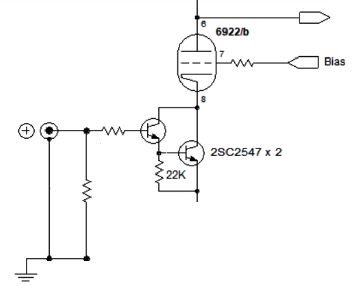

Hi Terry
I hear you, but...
I seem to recall having this discussion before. 😉
The stage I posted in #803 and here is the part where the Darlington pair sits:
As we both know, I do not use 2SC2547 pair. They are different, as per our dicussion.
But there was something that emerged afterwards that we never discussed. That 22K limits maximum voltage swing in that particular application, for example if this was a power amp and not a preamp. If you don't need to swing a lot of volts coming off the Anode of the 6922, then I would use 1K. If this was used in a power amp, then you cannot use anything that low.
In the power amp I have here, that needs to swing 200V, then no resistor can be had in that circuit. The output is current and that is current driving the 6922 through the Cathode. The Darlington is a transconductance stage, volts converted to current.
That resistor, depending on value, analyse the circuit and it will limit the final voltage swing the stage can achieve.
Like you said, there is a compromise(s) to be made.
Cheers, Joe
Terry,
Honestly said I'm a bit surprised to read this when you say that the 22k resistor will result in only 30uA current. Joe is talking about 4 - 5mA current and up to 9 - 10mA depending on the Anode resistors under #810. Your remark would imply that the 22k resistor needs to be lowered significantly in order to receive a much higher current or not? And Joe is even suggesting to leave the 22k resistor out and that would be the equivalent of having a resistor with infinite high resistance at that particular position so quite the opposite. So I'm wondering what is right and what is wrong here.
Could you comment on that? Thanks
Günter
Terry is talking about the current of the first transistor driving the base of the second being 25-30uA with 22K resistor (0.6V/22K=0.000027A=27uA).
Adding a lower value resistor there increase that current. But in the application here, there is a downside, it has an effect on the max voltage swing available to the stage. I only found this out in practice when I ran into trouble. In a power amp where the output tubes have near to no gain (1.5x, which is very unusual) and the need to swing crazy amounts of voltage, then you can't use a resistor at all. But another way to improve the situation was found, but I was helped by Terry, so credit to him.
