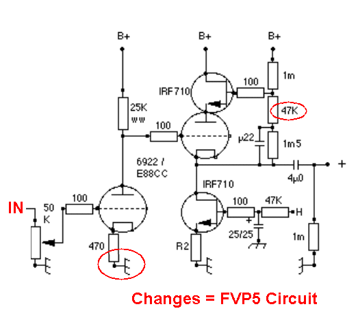

Look at this circuit (#1) even if it is not the same amp but the same output stage (Mosfet instead of tube).
A little bit of history. It may not seem like it, but the RTP5 circuit is actually earlier than the RTP3C. Yes, the phono stage is effectively the same (some very slight variations in values that you can see).
See the attachment below, which is one-half of the FVP5 circuit. It looks like half of the RTP5 and it is, except the triode gain stage is grounded (no current source, as is used in the RTP5 circuit)
What I have actually done is changed the RTP5 into the FVP5 preamps made in Australia and they are that closely related.
The "FVP5" line stage as single-ended is in fact the circuit Allen and I decided upon in 1997 for the FVP. I remember the year because it was the time when he turned up in Australia and had told me he had just turned fifty. I had suggested the circuit for the FVP (later the SVP) rather than use SRRP and he had agreed that the "Super-Linear Cathode Follower" was WAY better.
He then said that doubling up and add the current source to the input would make it the line stage for the RTP preamp and he understood that I had come to that conclusion as well. It was so obvious the way to go with the RTP line stage.
That is the circuit became the RTP5.
Note the 47K resistor encircled in red, which was Allen's solution to deal with the high gate capacitance of the MOSFET. The use of IRF710 here is that it has lower gate capacitance than what we used initially IRF820.
The RTP3C adds complexity to the line stage, the use of a cascoded gain stage and even better/complex current source for the "Super-Linear Cathode Follower" and is all Allen design decisions. Tube number goes up to ten. I have built about a dozen RTP5's and not a single RTP3C or similar. Full disclosure.
Cheers, Joe
PS: Note the FVP and SVP variants are all inverting. This is of course avoided in the RTP variants.

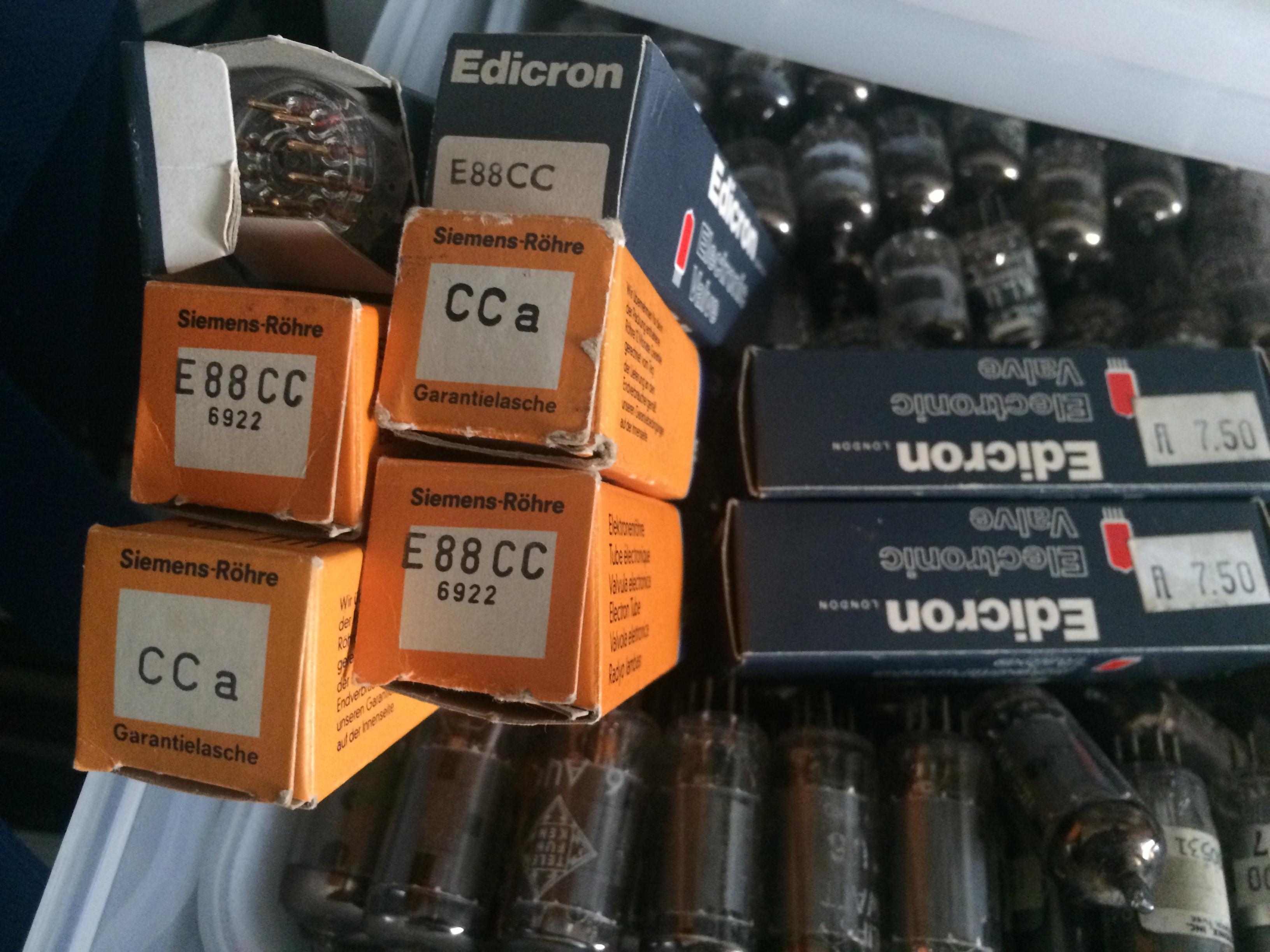

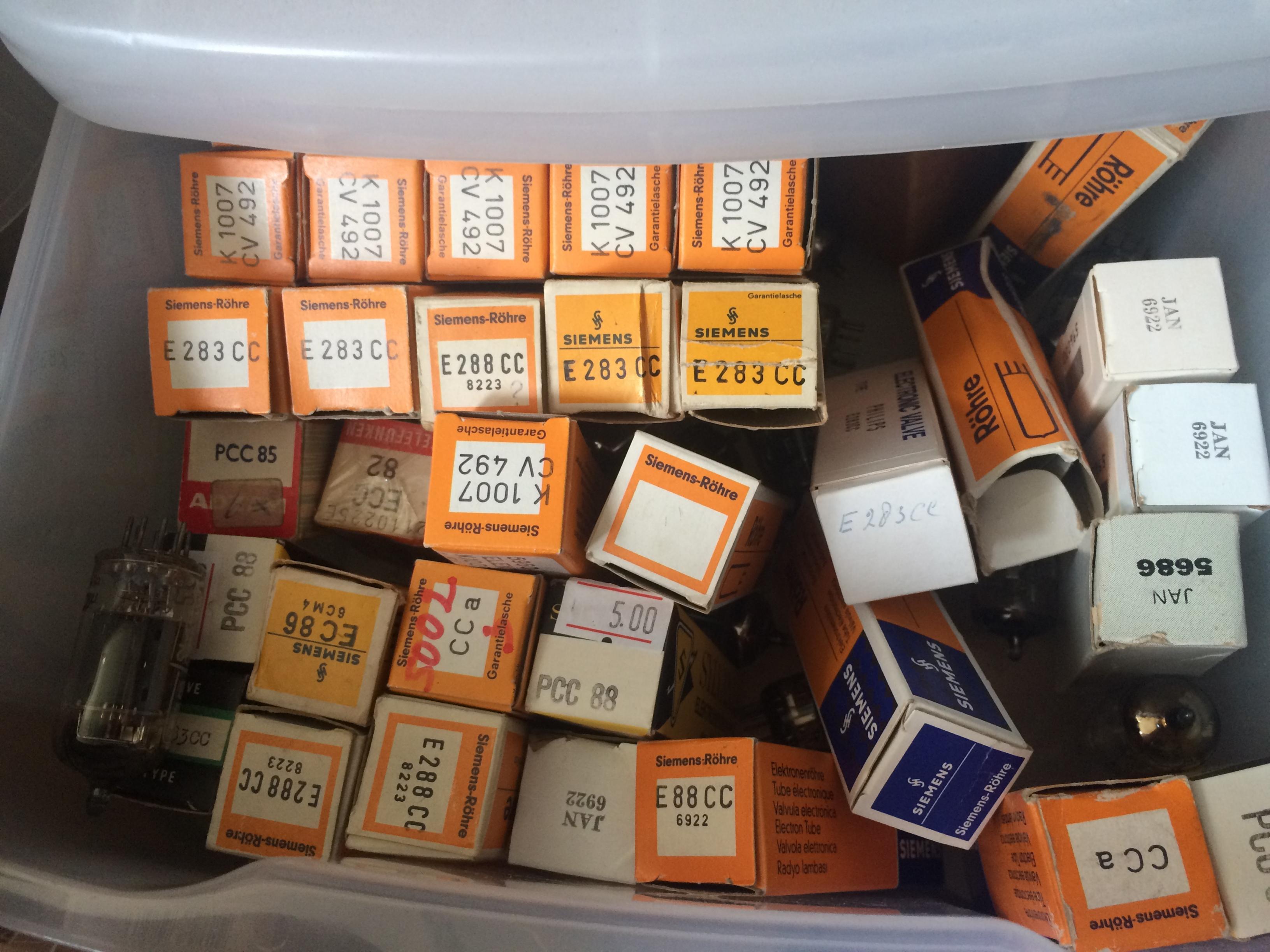

I should ask Thomas what tubes the Vacuum State preamps ship with. I started with used tubes then switched to new JJs. The JJs began to fail so I looked for something better. Ended up with nos Siemens Halske (early 70's) in matched pairs. It took a while to find them all but worth it. Beautifully musical. Detailed. Well worth selling a body part.

Your parts box is much nicer than mine...
Is that a bed of Telefunkens that you rest your CC's on? 😀

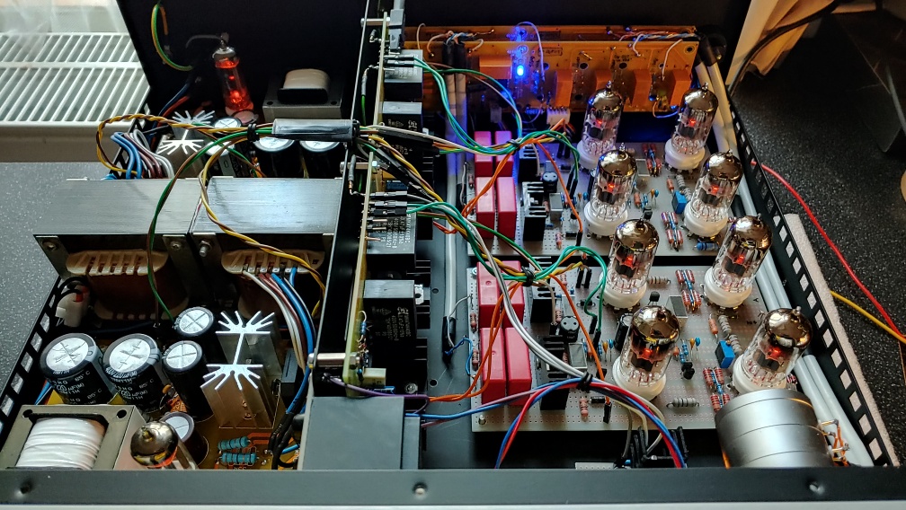

hi all,
so finally here is my build - aka RTP3C, line stage only, with IRF820 at output stage bootstrap instead 5-th tube.
the case is some Aliexpress Reisong/marantz7 model, I had to bought 2pcs at past, so I have used its power supplies and input switching PCBs.
good news is, after assembly it still keeps about 1MHz bandwith - it sounds really nice.
> thanx Allen <

Congratulations on completing your build - it really is a special design. Your photos don't appear, by the way.
Alex
