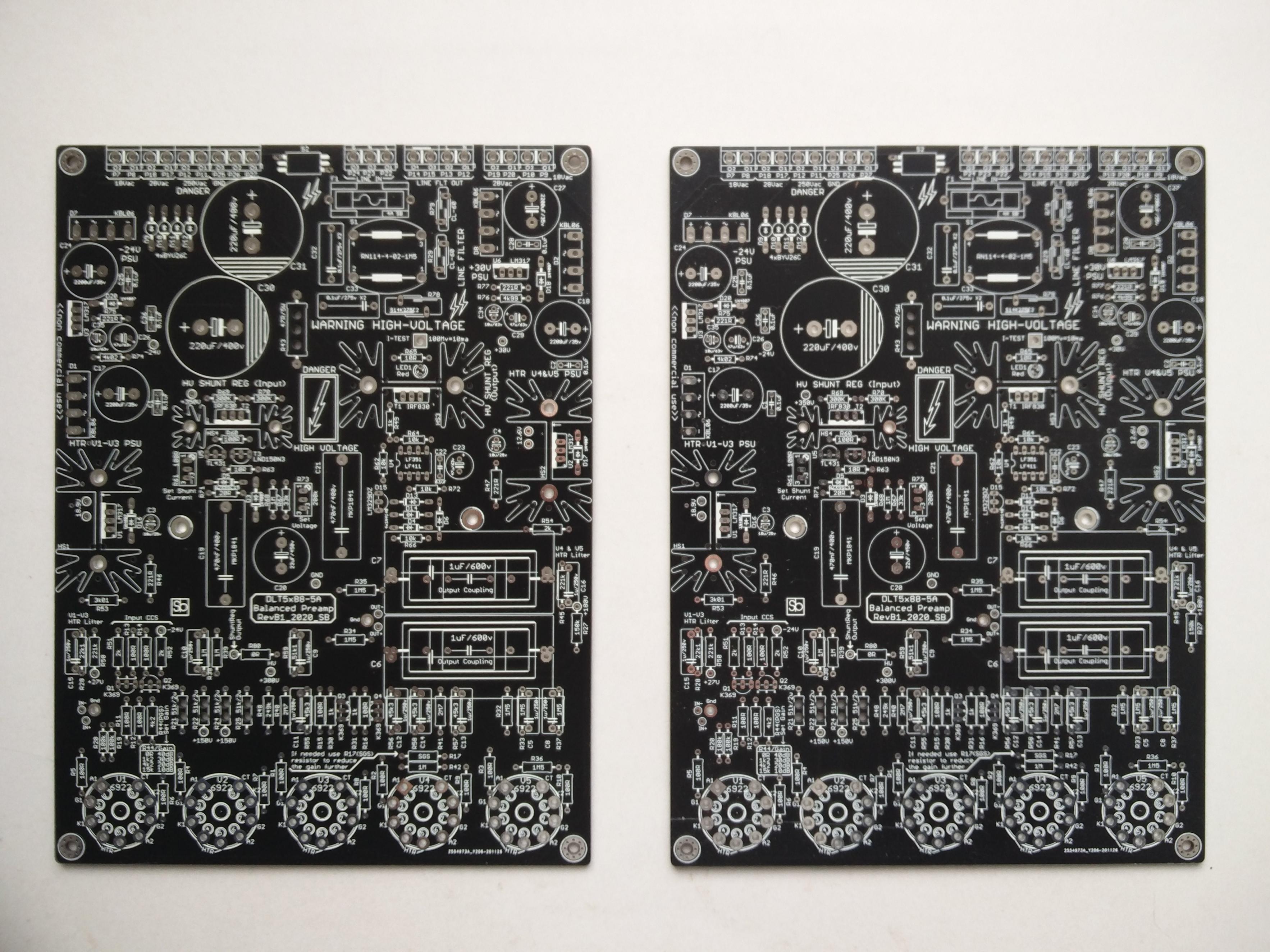

If you want to make this preamp I have a pair of pcb available, making the build of it much easier, with full schematic and detailled parts list, see:
FS: Pair of RTP3 Platine Tube Preamp PCB

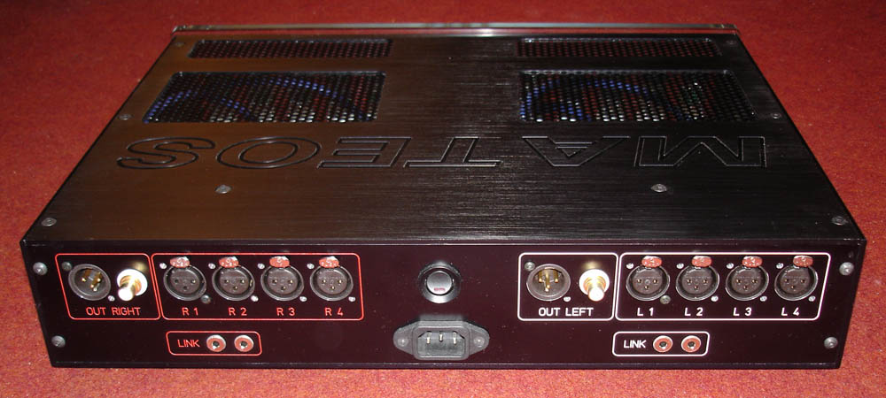

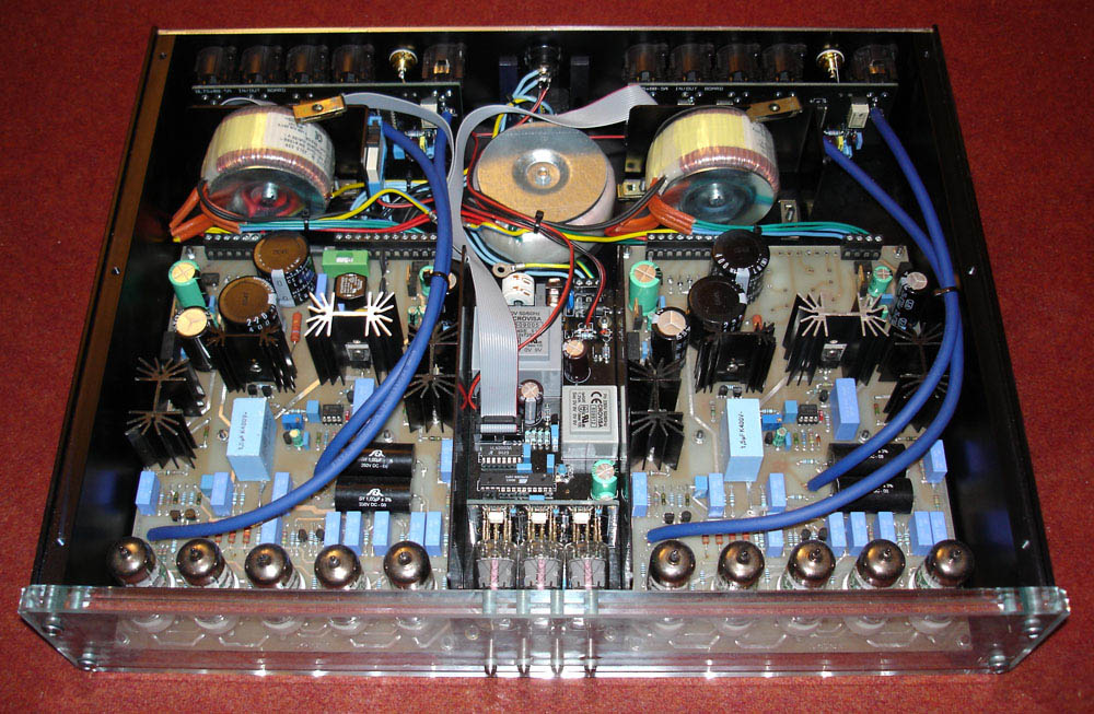

A few pictures of the original preamp using these pcb... You can see the rear using input selector pcb, the power transformers (I would mount them into a separate enclosure if it was me). The PCB will come with the original project files that I found. The front has three nixie tubes, they were used in the original project to display the source selection I think. I now nothing of this feature and they are not needed for the preamp.

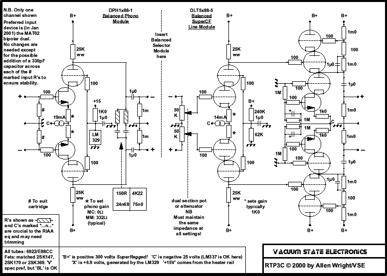

Hi guys,
I am planning to diy line-stage part of RTP3.
here at discussion was mentioned RTP3D version, even above PCBs are of this model - could be possible to get schematics for this circuit?
At VacuumState website is only RTP3C schematics and I am confused a bit how to properly set and supply points for current sources etc...

The difference is the current source at high voltage side of the follower. So you have one tube less.

do you mean it is realised vacum-tube currnent source at ver. RTP3D instead of resistor 25K which is seen at ver. RTP3C?
nevretheless, at link you posted (I already have seen this nice webpage) I could not find schematics of ver.RTP3D, all internal links of this page shows empty destinantions..
so - the need for RTP3D schematics is still here 🙂
The audio circuits of the C and D model are similar, and, apart from minor details, similar to the published circuit . And there is (Caution! Shameless plugging ahead!) a book available that answers all your questions about this circuit and the current sources for it.
One uses a mosfet as current source and the other a triode, that’s all. And indeed, the details can be found in his “cookbook”. If you do not understand the circuit and can not read schematics it is maybe unwise to start this project as it is not for beginners. (I hope you now try to prove me wrong and succeed in it! )

Concerning the schematics, I am asking for detailed (RTP3D) circuit namely because at published RTP3C circuit are resistors at right of the output stage listed as 1m0 for example, which I guess is some value left from circuit simulation and do not reflect really needed values...
Simillary with all CSs, I can imagine some different types of CS circuitry, as I am able moreless to analyze the circuit, but not skilfull enough to make circuit synthesis.
Therefore I am seeking for real values used parts..

Look at this circuit (#1) even if it is not the same amp but the same output stage (Mosfet instead of tube).

I think quite a few people have been confused by the RTP3/RTP4/RTP5 progression over the years. The RTP3 is the differential preamp design that Allen would always recommend - I understand he originally thought the MOSFETs in the bootstrap and CCS locations in the '4 and '5 were a good idea, but eventually came to the opinion that the all-tube version sounded better. The RTP3C is the published circuit, and the one I built my own project from, and the RTP3D - as Thomas points out - has basically the same signal circuit, with a few changes in the PSU.
Alex
No confusion from my side about the progress.
I just wanted to point out the difference in the output stage concerning the Mosfet on the top triode of the follower here.
