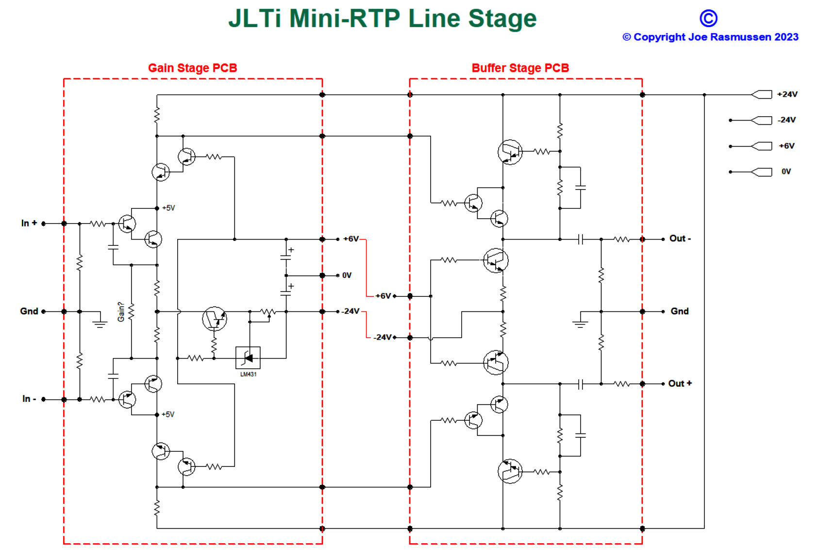

Interesting. Questions:
-why bipolars over jfets?
-will this design be open or a commercial product?
-max output voltage swing? Or asked differently, can this run on higher voltages than 24V?
-do you expect this design to outperform the rtp sonically, or is this more of a 80/20 exercise?
So many questions....
Bipolar Darlingtons sounds best when operating in a constant voltage mode, they sound amazing, musical and a certain grip, no vagueness. The key is to keep voltage swing away from it when used in critical parts of the circuit. Here the input is voltage and the output is the current, voltage swing kept to a minimum. It is in fact a transconductance stage.
To give credit due, Terry Demol also provided some help in device selection. But the key credit is to the late Rowan McCombe, who suggested the use of Darlingtons in the Sony SACD upgrades output buffer stage, which was a small solid-state version of the SLCF and it sounded better than anything we had tried before.
If I was to release this line stage schematic, it would not be public domain, it will be copyrighted but single license allowed for DIY use, in the same way as I do for the Elsinore speaker design.
Max voltage swing will not match the RTP, but do I expect it to match the RTP line stage sonically? Yes, I would hope so, or else I would not suggest it. I know that it is not tubes, but it will be incredibly less inexpensive to build. But you will see that the schematic has features that are identical to the tube RTP, but can be scaled down to using much lower voltage.
If I do post it, will this be the right thread, since this is under tubes and not solid state? I could post it here and if it garners interest, start another thread under solid-state?
Many thanks for the detailed answer. I suggest to start new thread in the right section and post a link to it here.
Yes, a separate thread, that is what I was thinking too. I need a line stage and this is what I need to build. A few things on my plate right now, but winter is fast approaching, so that is a suitable winter project.
But below is a sneak preview with no values (they need to to worked out, but I have initial values in mind), there should be no difficulty in seeing the similarities of the RTP Line Stage. It appeals to me to make a preamp that only uses all Darlingtons and nothing else. All are NPN. It's my way of tipping my hat to Rowan as that was one of the last things he told Allen when he visited us down here, it must have been around 2001.
Any comments? Please keep in mind a new thread would be required. But I just wanted to see if you guys could spot the RTP similarities. The 24V supply may need to be a bit higher and many of the values in the circuit suggests themselves. Input current about 5mA per side (10mA in the long tail CS) and 10mA in each of the Buffers. That would make around 60mA in total for both channels. I have some special ideas for the power supply, it will use Solid-State Inductors valued around 100 Henries for the main rail, then a SuperReg to follow. But I have yet to fully sketch that out.

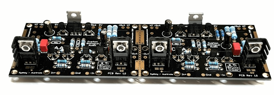

This is my current RTP solid-state gain stage. Sorry, but it is better. I would love to still be using tubes. And I still do where they still can't be beat:
If Allen had been around, I think he would have liked this approach. The cost is hugely less that an RTP Line Stage and that is a major attraction, and I already know how good the circuit is, just look at the power amp schematic I posted in #803 which I am listening to right now. I hate to say it, but this is the stereo gain stage of my current amplifier and I am sorry, but sonically it is superior to the gain stage used in any RTP preamp - and I have built more RTPs than any of you here. This is why I now use solid-state as a front-end and EL34 tubes on the output stage (which have much lower Anode impedance than Triode mode, "Beyond Triode"). We never shied away from from using solid-state and even the gain stage of the phono stage, there you will see a Fet in the RTP Phono Preamp. Mixing tubes and solid-sate? If it works, then we did it. The Fet solved several solutions and one was that it did not drift with age, you could match the two phases (Hfe current) and it would stay like that. The other was lower noise still.

The 22k resistor looks very much like a current source to the first BJT's emitter. I'm not sure how this will limit maximum voltage swing. Can you clarify this.
Not sure if I responded to this. Ended up not using any resistor, even if on the surface it should put the first tranny into cs mode as you say. But, the whole cascode stage was required to give a gain of around 300x. And it was not a problem. But this was also driving two resistors (of quite high value) and effectively modulating a standing current of around 0.5mA. This puts the EL34 tube gain down under 2x (local feedback) and also makes the amplifier very quiet. It's hard to explain, but if we sat down together with a piece of paper we could scribble on, then it would be easier to explain. The result is the best amplifier I have heard, about 32 Watts per channel and clips like a triode (it does sound like a hundred Watter easily). Analyse the circuit and you will realise why the resistors nobles the particular job which is quite complex. Low voltage swings though, no problem.
