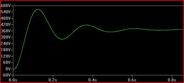

Hi Alex
Sorry for the delay.
Here the simulation. You can see a overshoot at 550V. After 1s, you have a quite 36O v.
Vince
That's very interesting. I wonder whether the same transient response would be seen with a real shunt regulator connected to the supply: it may not instantaneously draw the maximum current, for instance. If that is the case, it may have some effect on the lifespan of some of the active devices in the regulator (for instance the IRF830 has a maximum rated voltage of 500V).
Just a thought - the HPHV regulator I use has a little 1uH choke at its input. What difference would this make to your simulation, I wonder?
Alex

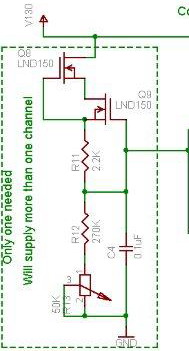

Looking at the RTP3C schematic I noticed the LM329 is bypassed to ground with a 1uf capacitor. I guess the intention is to lower the input impedance to the 6922 at high frequency therefore shorting any possibility of interference noise that might cause oscillation. The thing is this 1uf will load the lm329 that preventing it from working properly.
I've built a similar 2sk146//6922 cascode using lm329 for voltage reference and bypass it with a 1uf Wima cap. In listening there is a lack of airiness, highs seem rolloff. Like there's a veil between me and the music. I found out the hard way that lm329 does not like capacitive load. After I yank the wima, the veil removed but noise floor increases causing soundstage to become more 2D and bass fullness reduced. For experiment, I replaced the lm329 with a resistor and a bypass cap (oscon). This restored the sonic balance n noise floor. Comparing to the lm329 with bypass, the later seem to offer more dynamic contrast and ambient information. Again this I suspect is the lower noise floor of the lm329 combo.
I did a search on some voltage regulator design where lm329 is used as a voltage reference for the error opamp. There is always a RC filter following the lm329 for providing a resistive load, input impedance matching for the opamp, and to reduce the lm329 noise.
Any one out there share a similar experience? The next thing I'm going to try is probably adding a RC filter to the lm329.
Regarding this issue with LM329, I was thinking of using the circuit I attach below. This is John Swenson's idea and was part of his BDT preamp as a voltage regulator for the upper gate of a MOSFET cascoded design. The idea is quite simple and clever: cascoded LND150s are used as a constant current source feeding a resistor; since LND150 has an Idss of ca. 0.33 mA, there is a voltage developed on the load resistor that is constant. And since LND 150 has a Vds of 500 V, it is very convenient for that purpose.
I'm about to use one of this for a PP-2C amp I'm currently building (or rather modifying to from an old PP amp).
What is your opinion on this regulator?
This is the same method of voltage reference used in Gary Pimm CCS and I have used and like this CCS.
this method of providing voltage reference does not give a low impedance since it is "passive". Any grid current drawn by the tube will cause the reference voltage to move which is not what you want. In Gary CCS the voltage reference is for the MOSFET which is a different case than triode.
Nevertheless, I would suggest you try it and report your findings.
Cheers!
Cheers!
Does this mean that the upper grid of the cascode draws current? And, if yes, how much is this current?
